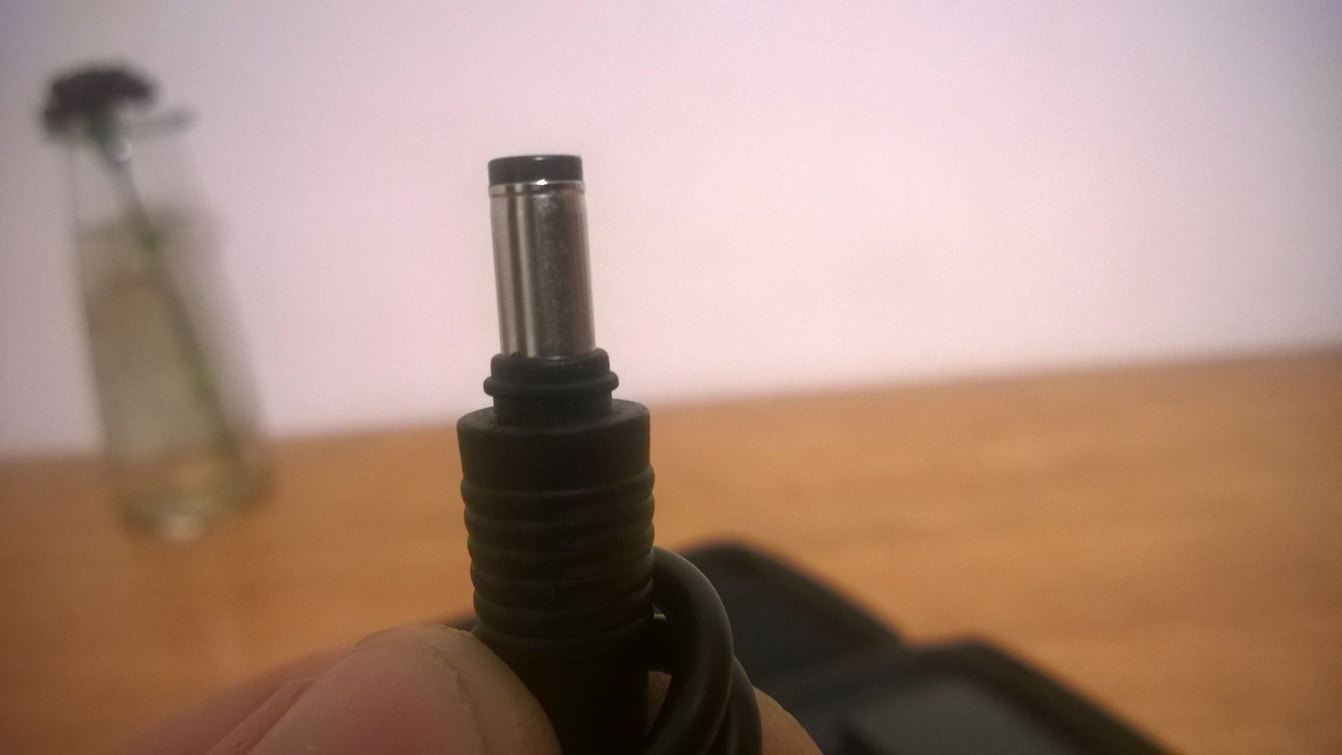

    Hard case battery pack is kind of large compared to what were used to. Kind of annoyed with one aspect of the battery matter, the proprietary PLUG. Looks similar, but look at the pic, the contact is still 5.4mm but the rest is smaller. Doesnt work with magicshine style plugs. Chargers still don't matter but the connectors don't mate up to other lights or other battery packs. Also cables for light head and battery pack are rather long. To the point I dont think most would need an extension cable for any reason.

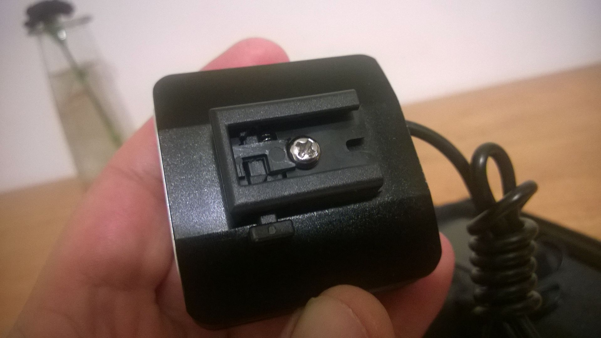

    -First up, the qr style clip mount. Same one as used on the USB light Im reviewing from them. So have 2 bar mounts now to move lights around at will without messing with moving the mount. Heres the light head side of the mount (mount itself pictured above). Little button on the side of the mount to release it.

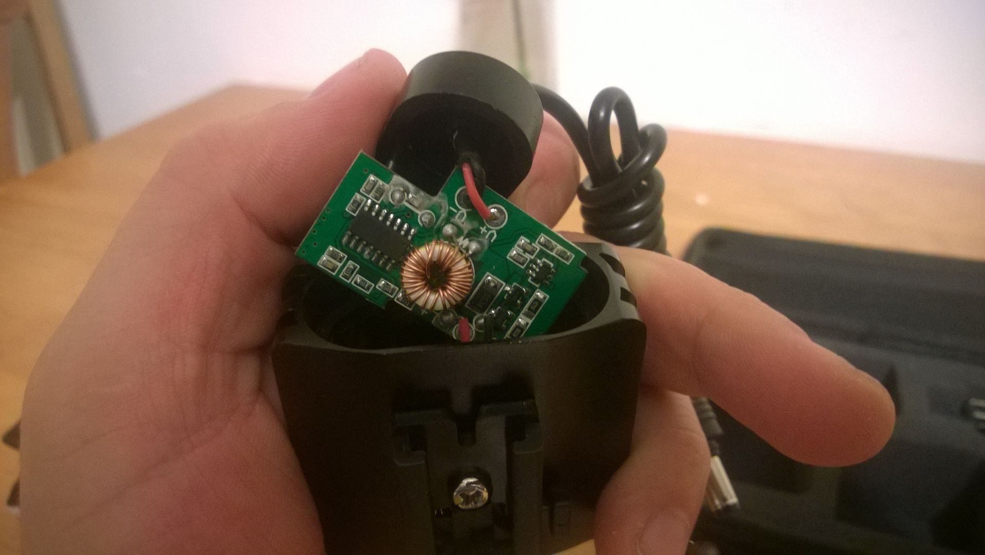

    -And the most important part, inside the head itself. It gives me somewhat of a solarstorm feel. Full hollow case with the lip around the perimeter of the emitter pcb. Plenty for this light though and THEY DID use thermal paste. As always PCB is one solid piece.
    Optics set up (no I havent messed with it yet, probably wont have time for a while to even attempt to tinker with this light)
    Glowing orings
    Hollow case:
    Driver: Used a dual sense resistor set up (why they dont just use one bigger one is beyond me), dual R250 on Leda chip= 2A output per emitter (yes their in series).

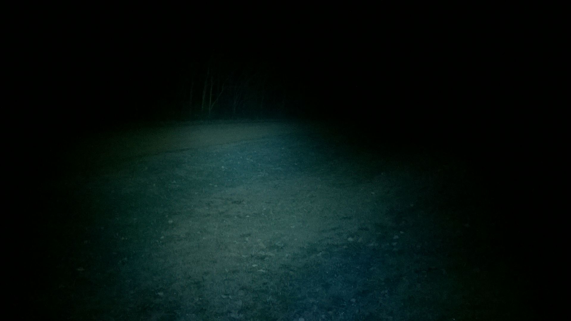

    Beam shots:
    Low:
    Medium:
    High/Turbo 100%: Camera wasnt really catching a difference in the 2 since its very minor, so this is "Turbo" pointed low, then up and down the road.

    Beam pattern out in the open is not as tight as I thought (or looks on a wall). There is the little hot spot, a bigger hot spot around that , then another then the spill.

    And don't forget the proprietary battery connector!

    Ya that proprietary connector thing peeved me off lol.
