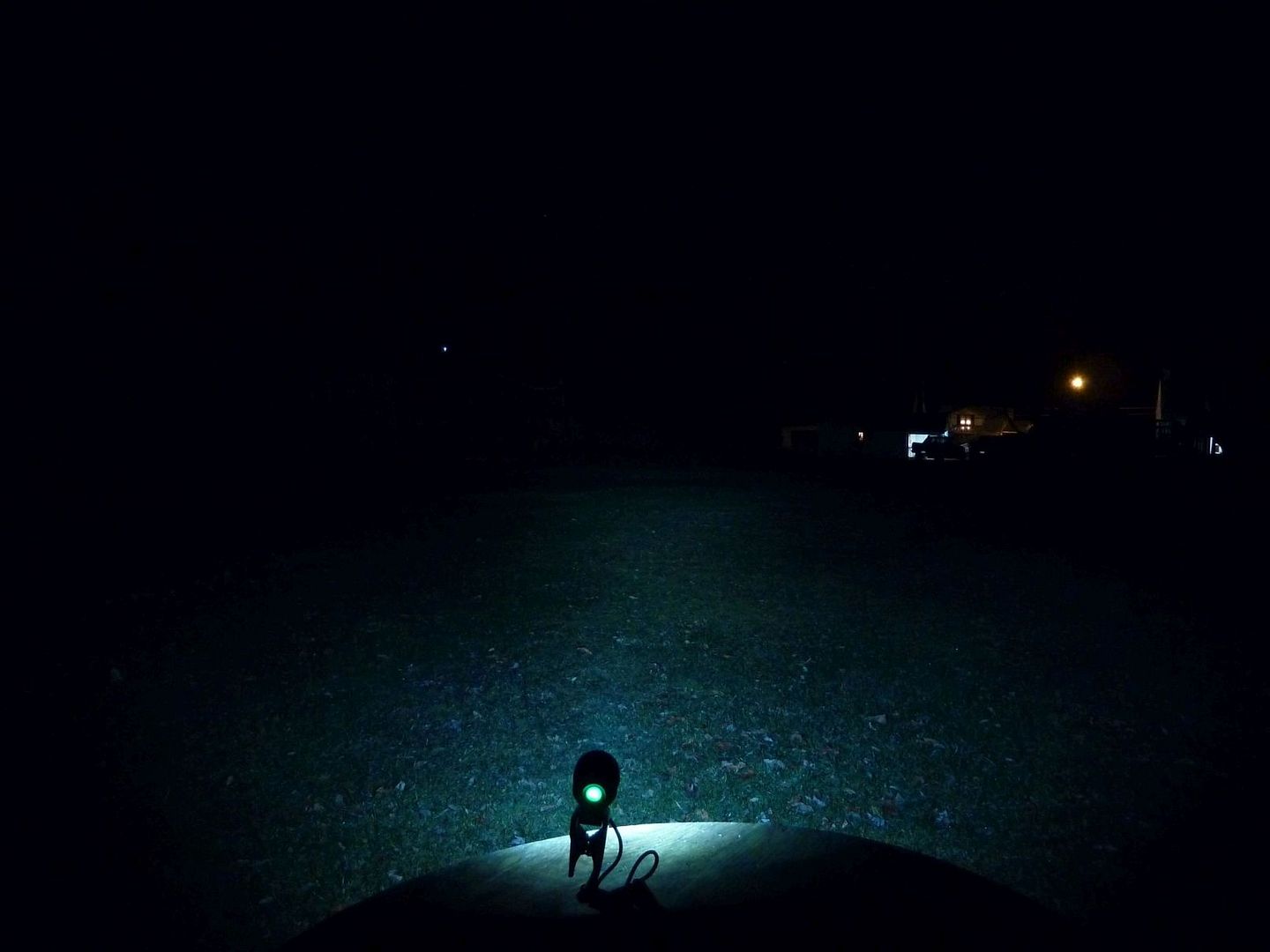

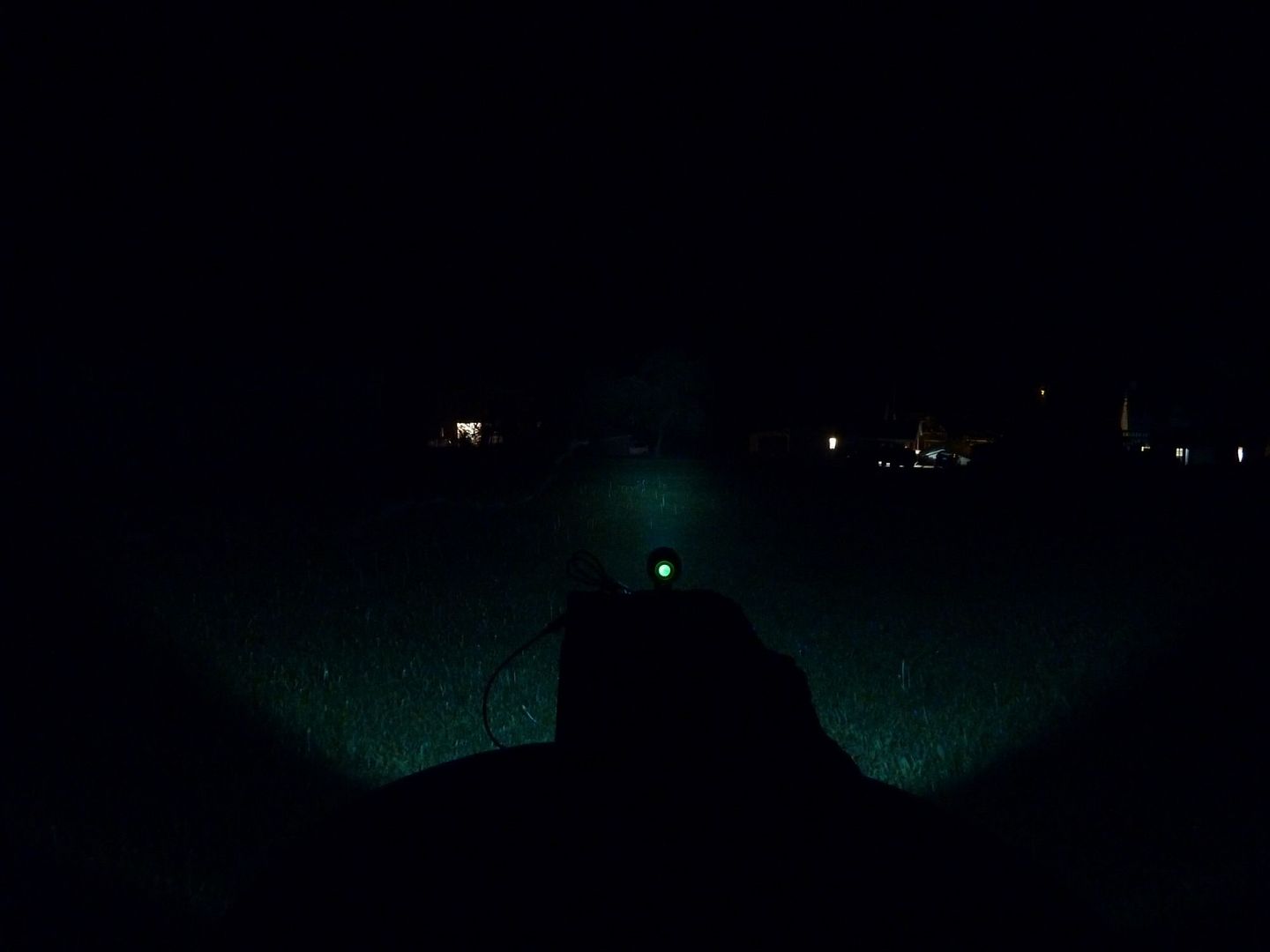

    First Impressions / Beamshots:
    My first impression of the light was that it produces a great wide flood while also throwing quite well, and all while only pulling 0.92A on high from an 8.4v pack! That should give roughly 5.6 hours of runtime from an average “real” 5,200mAh 2S2P battery pack or even 2.8 hours from a “real” 2 cell 2,600mAh pack. Low at 0.30A (which is 30%) is a nice spread from high while still providing ample output for slow riding situations. The tint is typical cool white, no greenish or purplish hues in my sample.
    (EDIT 1/5/2014) NOTE: See post #7 below concerning the blueish tint to the beamshots. The tint showing up in these beamshots is not accurate. (END EDIT)

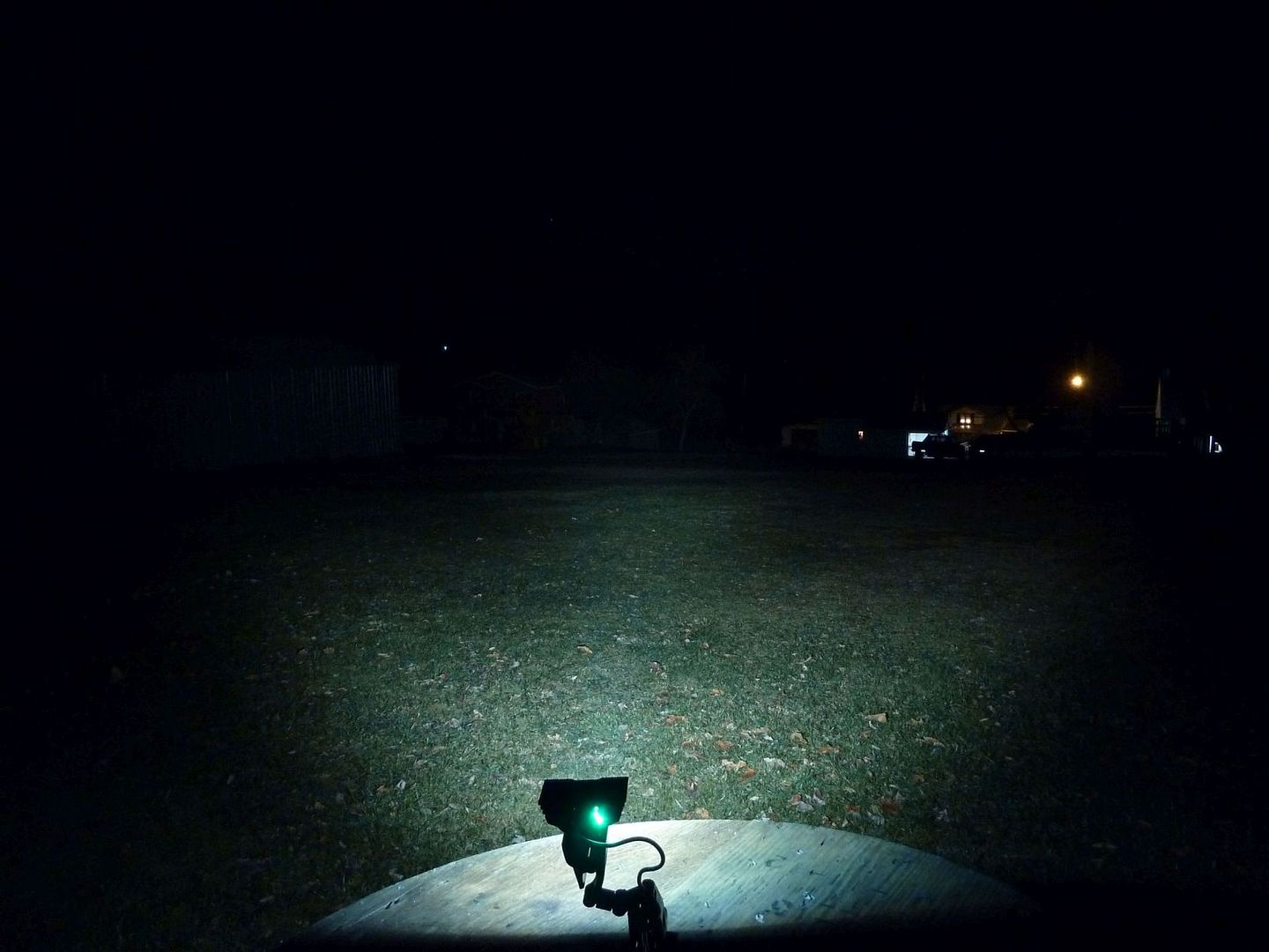

    The following are some beamshots in my typical location (same settings I always use which is a hair dimmer than reality). Distance to the two trees is approx. 185 feet (I have yet to determine the distance to the garage behind the trees, but I’d guess it’s an additional 50 feet). I’ve compared this light to a SolarStorm X3 modded to 5B1 neutral white emitters (driver unmodded, approximately 1.6A per emitter on high) and a typical single emitter MS 808E clone (unmodded).
    GB 3X on High:
    GB 3X on Low:
    SSX3 on High:
    SSX3 on Medium:
    SSX3 on Low:
    MS 808E Clone on High (These photos taken on a different date):
    MS 808E Clone on Low:

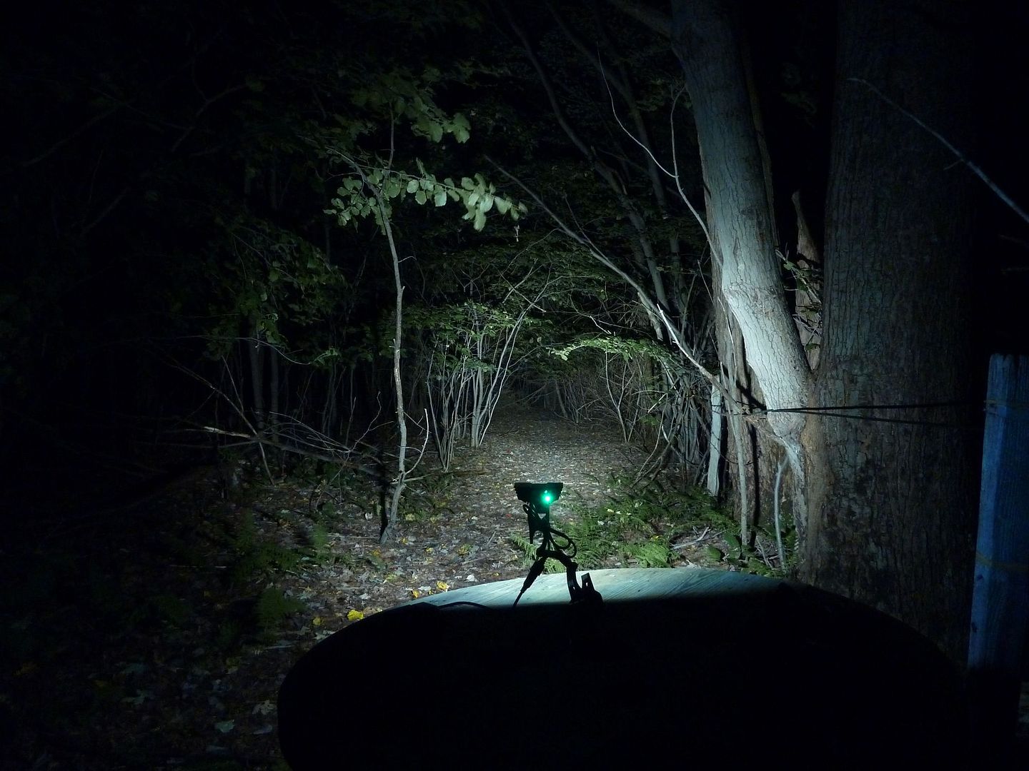

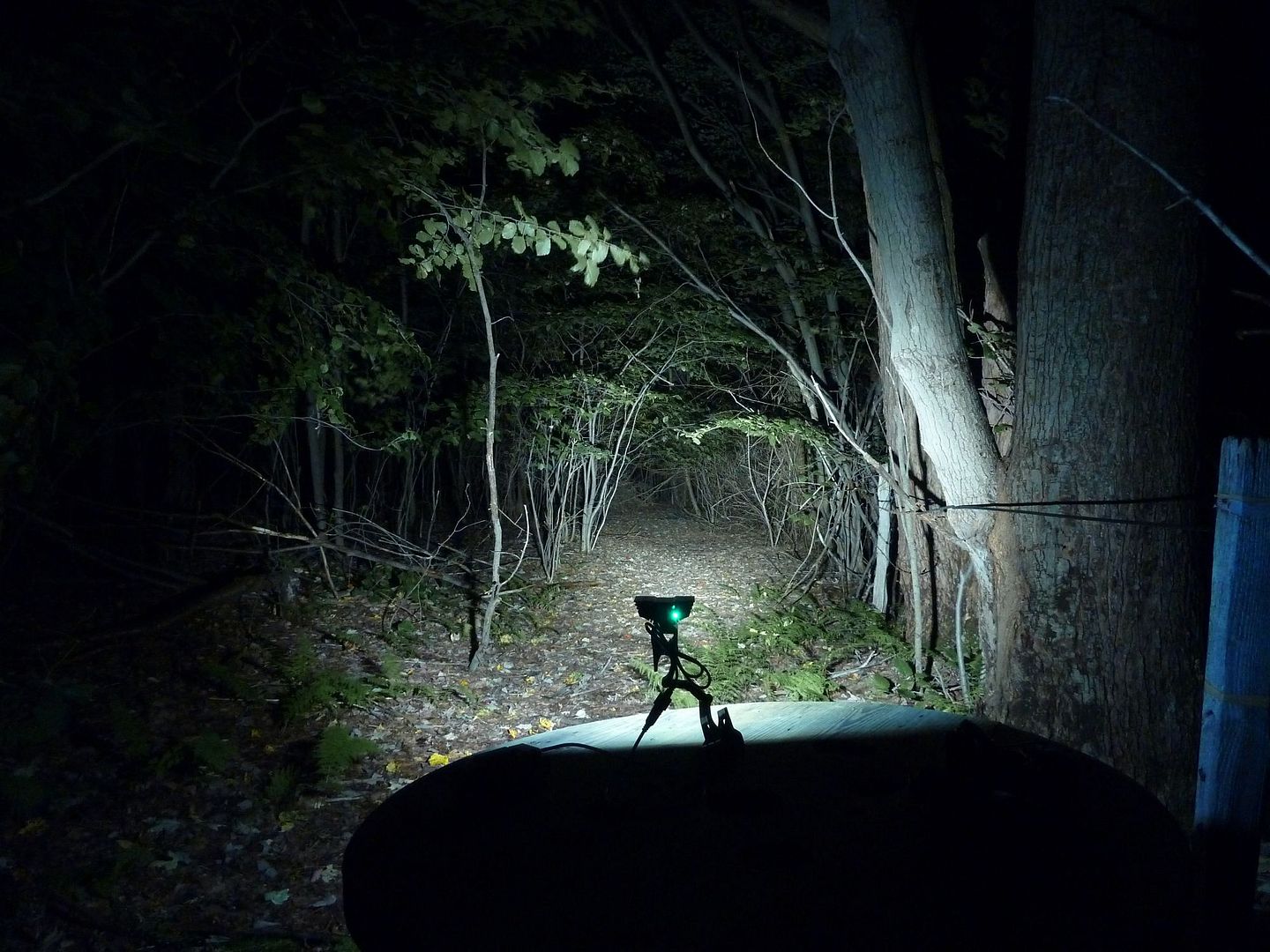

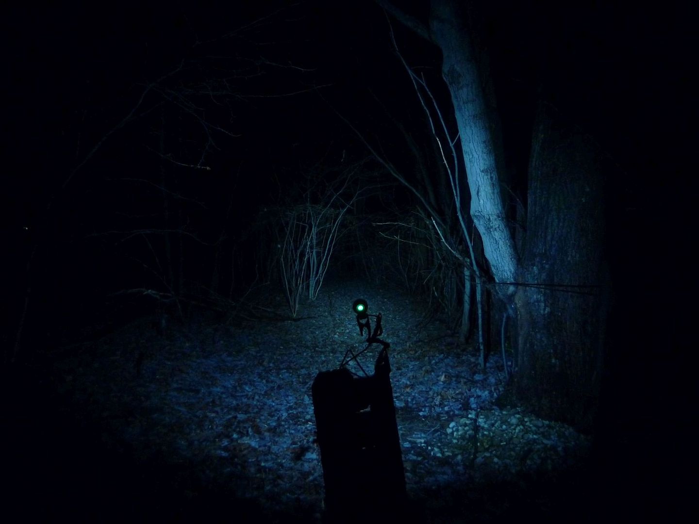

    The following beamshots are taken on my simulated wooded trail, same camera settings.
    GB 3X on High:
    GB 3X on Low:
    SSX3 on High:
    SSX3 on Medium:
    SSX3 on Low:
    MS 808E Clone on High:

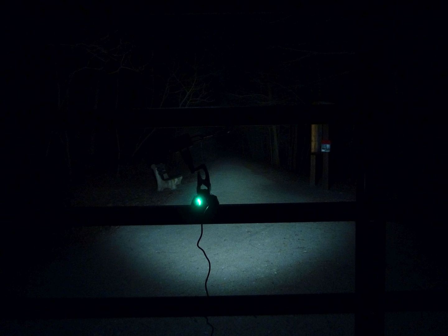

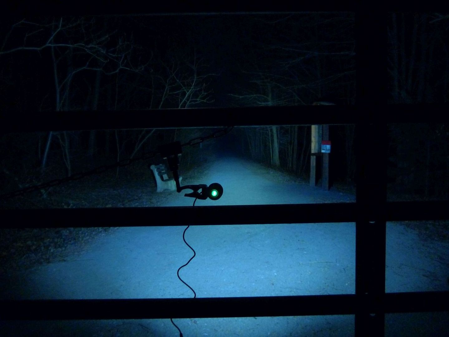

    And these last set of beamshots are on the local rail trail. I had to use the gate to hold the lights for the shots but then realized I had to backup to get the full width of the beam thereby getting the gate in the shot (I’m going to have to plan these shots better in the future).
    GB 3X on High:
    GB 3X on Low:
    SSX3 on High:
    SSX3 on Medium:
    SSX3 on Low:

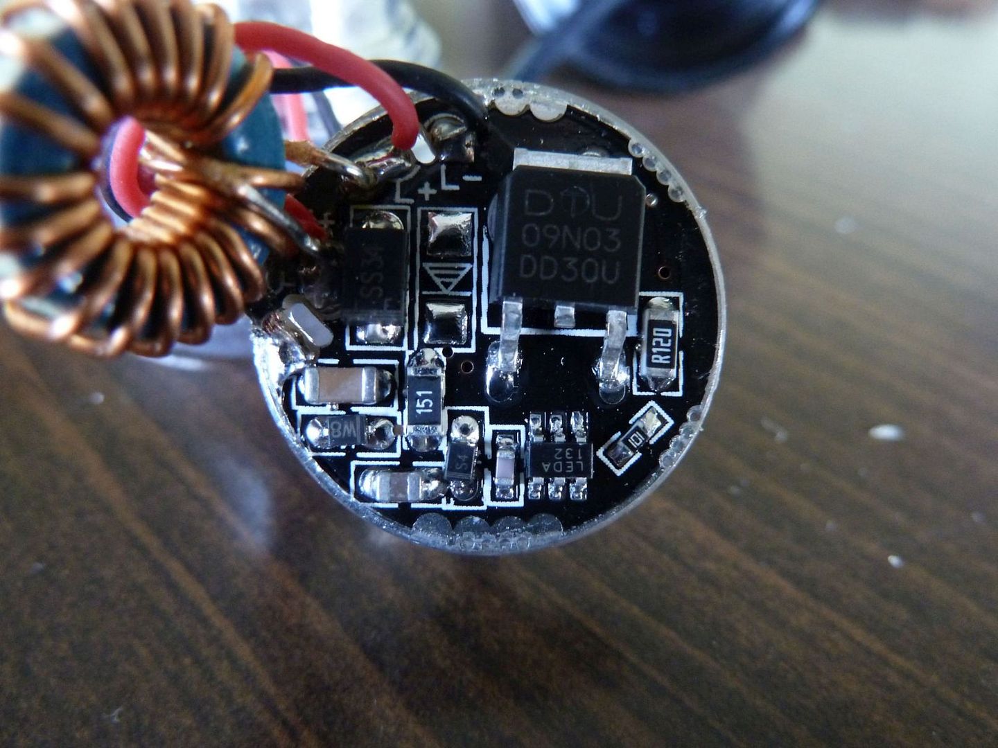

    Teardown Assesment:
    To disassemble the light you simple remove the Phillips head screw below the handlebar mount and remove the bezel (tip: a round screwdriver shaft placed across the crenulations’ valleys works great to remove it if it is tight). Removing the mounting block reveals that the cable exit is far from being waterproof. I do think in use it would handle being splashed or a light rain and the gap could be filled with silicone sealant.
    Once the cable is free to slide inside the body by the mount being removed the pill can be worked out the front.
    As stated previously, the pill simply drops into the body with much of the pill not making thermal contact to the body. It’s a typical design which holds up ok so long as the lights are not driven very hard. This pill appears to make contact at the front rim edge near the emitter pcb and at the rear near the switch. The pill is pretty hefty.
    My driver had a slight bit of glue at the edge, so it took some care to pop it out of the pill to access the reflector mounting screw underneath. After removing the reflector, the emitter pcb is revealed and is 28mm in diameter, 0.96mm thick, with the 3 LEDs wired in parallel. There was no thermal compound under the emitter pcb, however the way the reflector is screwed to the pill it puts substantial pressure against the pcb. The wiring to the emitters was very thin (probably only 28 or 30 gauge), however after I rewired with 22 gauge I saw no increase in LED current. Below is a pic showing the stock wiring next to my 22 gauge replacement:
    I measured current to the emitters at 1.886A while the driver pulled 0.97A from the stock [email protected] 7.93v no load (7.54v under load). Using my Pannova case with two 4.06v cells saw the same results. Here is a pic showing this test:
    On low, the stock driver delivers 0.57A to the LEDs while pulling 0.32A from the battery. Here is the same test on “Low”:
    (Note: the orange Tenma DMM is supposed to be measuring vF (LED forward voltage). It seems correct on high, but the value is wrong on “low” due to the PWM in low mode.)
    The driver uses an FET with either a sense resistor or a current-limiting resistor to control output current. Due to the use of the LEDA chip, I believe the R120 is a sense resistor. (I’m no driver / electronics expert; perhaps someone else more knowledgeable can chime in.) Here are pics of the driver:
    & the other side:
    One interesting thing to note on this driver, it will also operate the LEDs with 4.2v input. The battery status LED will display red, but the driver delivers the same output to the LEDs. I measured 2.02A on high, 0.59A on low, and 0.004A while “off” at the battery pack.

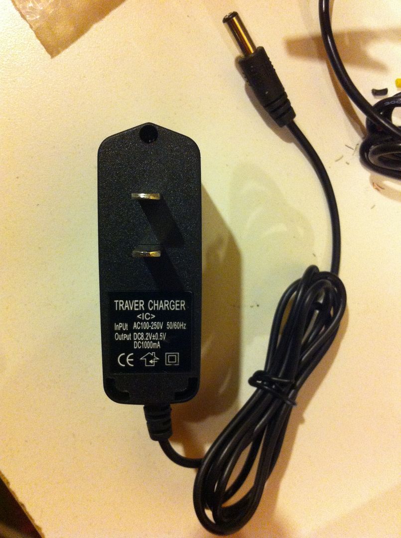

    Battery Charger & Battery Pack Teardown Assesment:
    The included charger was suspicious right away if only because of being labeled a “TRAVER CHARGER”.
    Nowhere does it even say it is for Lithium-Ion battery charging. It is labeled as 8.2v @ 1,000mA, but in my testing it put out 8.31v (no load) and only charged at 0.20A to 0.30A. It appeared to stop at 8.34v (battery pack alone would read 8.00v at this point). It is NOT a proper CC/CV Li-Ion charger; it is simply charging up to a cutoff voltage limit.

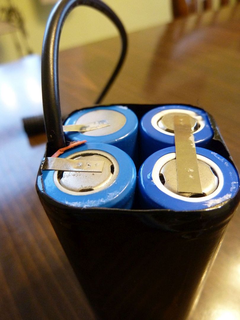

    The stock battery pack: This is where things got really disappointing. I knew something was up because the battery pack would only charge up to around 8.00v with either the stock charger or another decent 8.4v charger. I decided to rip open the pack and investigate. I found the pack contained two sets of different color wrapped cells. I also noticed the cells were not corrected for a proper 2S2P arrangement!
    Upon further investigation I found that the two cells which were attached wrong (and different shade of blue color) measured 0.00v! After the pack was fully charged, the two working cells were measured at 4.19v & 3.79v, way off balance (i.e. dangerous)! So the wall charger was charging until one cell reached full and the other cell never charged any further (hence the 8.00v total at full charge). I guess the packs overcharging protection circuit was kicking in, though I never noticed.
    I decided to do something courageous and cut open one of the “dead” cells (don't do this at home kids!). First off, the battery tab welds almost fell off by themselves! Then after cutting it open I discovered this:
    A fake battery! Another user with this same light from GB has told me that his battery pack contains 4 working cells, so I don’t know what the chance of getting packs with fake cells is. I personally wouldn’t trust these cheap Chinese battery packs anyway, so I always consider these purchases as a light head only.
    I then fully charged the remaining low cell using a homemade setup for my OPUS battery charger / analyzer and performed a 1A discharge test on each. Cell #1 came back at 2,207mAh and cell#2 at 2,099mAh – not too bad for cheap cells. I actually expected them to test closer to 1,500 or 1,800mAh. I guess they used two higher capacity cells due to including two fakes!
    The previous run time test is almost void, as you won’t know what capacity battery pack you will receive. Even so, 90 minutes on such a poor pack probably isn’t so bad considering the price point. The more concerning part to me is the fact that the cells are so off balance and the average user isn’t going to cut the heatshrink open to investigate and correct this!

    Great review Garry. I would say the color is much bluer than 1A and would be irritating to look at for a while. I never understood the draw of the Tri Clones except that some were super bright, they seem one of the bigger crap shoot lights out there. Seems this one is a fail.
    BTW Your daughter is so cute, even after your review, I want buy the light now
    Reputation: garrybunk's Avatar
    Feb 2014
    1,745
    I'm not sure why those pics show it to be so blue. I just tried it again and it's definitely a nice crisp cool white. Even tried my 808E clone again and it's nearly the same. I wonder if it had to do with the night I took the pics being so wet outside (I can't remember how wet it was)?
    -Garry

    Ok, I think I've determined that the blueish look to the beamshots is an "environmental" effect. See my post#12 over at BLF which has a mouseover comparison between pics of my SSX3 taken on different dates with identical camera settings.

    Well at least GearBest did the right thing here and pulled the light from their website. I don't expect that they can test the batteries coming from their vendors/suppliers, so it's tough to hold them responsible.
    I am sure this scenerio could happen with virtually all the Chinese vendors selling these "cheap" Chinese lights.

    18650's are the most counterfeited battery by the Chinese
    You never know what you might find
    Review: GearBest Triple XM-L2 3 Mode Bike Light-fake-battery-1.jpg
    Review: GearBest Triple XM-L2 3 Mode Bike Light-fake-battery-2.jpg
    Review: GearBest Triple XM-L2 3 Mode Bike Light-fake-battery-3.jpg
    Review: GearBest Triple XM-L2 3 Mode Bike Light-fake-battery-4.jpg
    Review: GearBest Triple XM-L2 3 Mode Bike Light-fake-battery-5.jpg
    Sep 2012
    178
    And people wonder why folks on here say "Stay away from any of the 'Fire' branded batteries!"
    Dec 2014
    41
    Hey, how else are they going to get rid of their old crap, asbestos and lead toxic waste, eh?
    No, I don't know for sure, but I'd sure like to see samples of the stuff sent to a testing lab.
