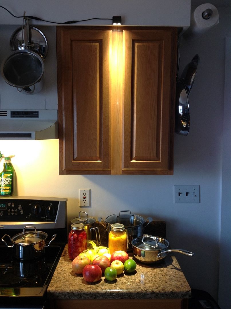

    This is a sample of the work so far:
    So finding myself evicted from my rent stabilized apartment in NYC, had to move into the old farmhouse I'd previously been letting out upstate. Nice place but. Soon realized the kitchen lighting at night was woefully inadequate for my purposes. Replacing the overhead fixture's CFLs with the relatively new Philips 14.5W (100W equivalent) Soft White LEDs helped a bit but I was still working in my own shadow at the counters. Adding to trouble, the induction cooker I'd recently purchased to supplement the lugubriously slow to heat glass-top range had no place to rest but on the middle bank of cabinets where there was no dedicated light such as that in the range hood or over the sink, D'oh! While pondering which of the crappy under-counter LED setups to purchase on Amazon, I suddenly had a memory flash: Few months ago, while attempting to charge all the cell packs on the bike I'd just docked, one of lamps on my handlebars suddenly illuminated full blast. Realizing I'd mistakenly inserted the male end of one of the chargers into the loose female lead of cable splitter rather than into a cell pack, I immediately yanked them apart before catastrophe. Luckily neither light head nor charger seemed damaged in any way and I'd put that little experience behind me until that eureka moment:

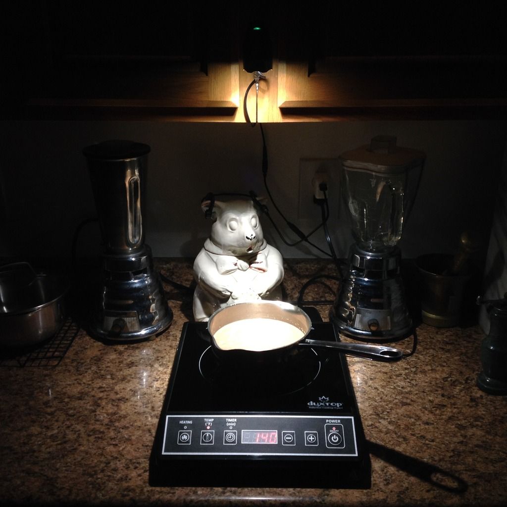

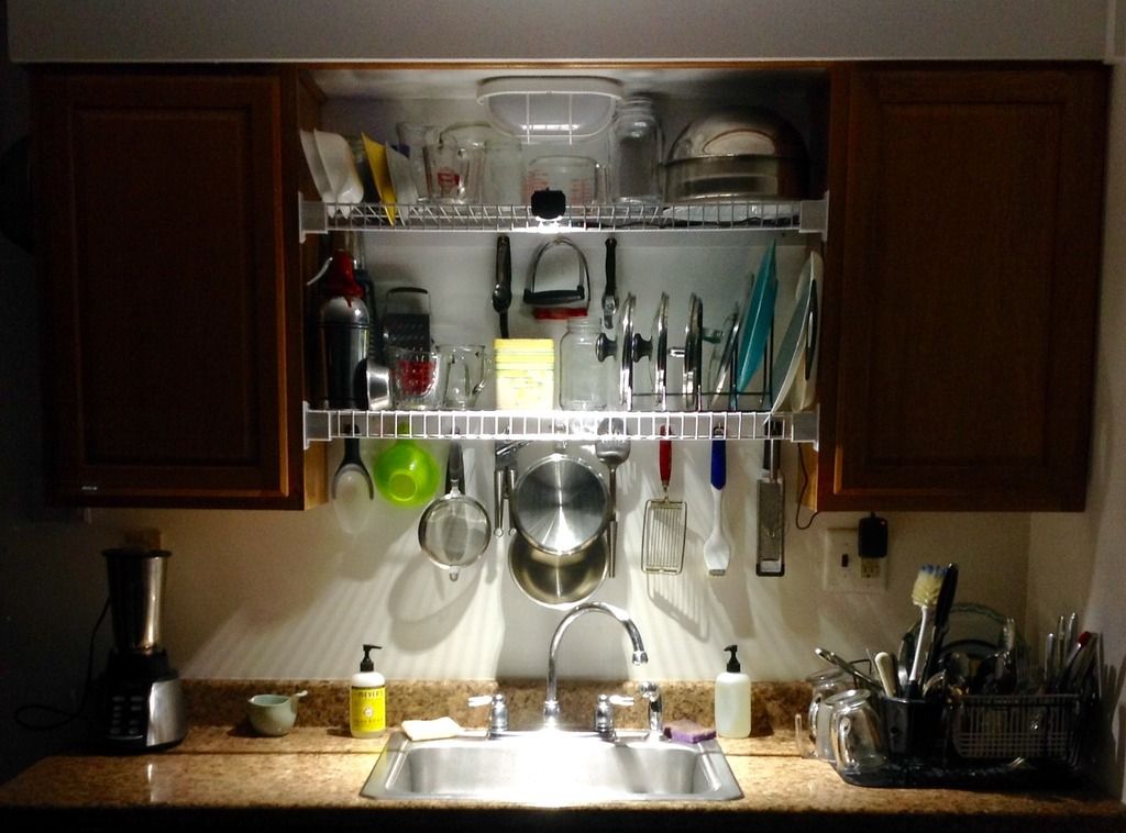

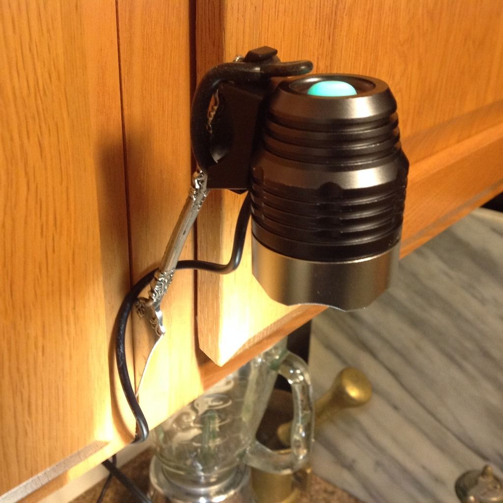

    Still having both a coupla free cable splitters laying around as well as a pair of female to female adapters to spare (from that disappearing Fenix battery case fiasco on AliExpress) I pulled the "wrong" tinted Yinding as well as my KD 880 clone (modded with 20 X 30 diffusing optics) off my commuter and dug up the generic, single emmiter 808 clone I'd upgraded with like an XM-L2 5B1 or something and double diffusing lenses. Found that when connected to my two remaining quality chargers, a MagicShine and a Nitefighter, lamps ran without problem. On the cheaper chargers, power indicators turn red on the brightest setting (Mothra and SS 3X I'd also tested flash theirs) though they still seem to run okay. Cycling through all modes when attached to the cheapos, indicators will remain red/ flashing even after lamps are brought back down to lowest levels. Huh. Anyway, as these lamps will probably all over-heat if powered on High indoors (although I don't keep the kitchen above 63, and most often it's about 57 in these colder months) I just run them on Medium. KD clone is a cinch because it has two control buttons, so can just set it and forget it. Yinding and 808 clone have to cycle through modes, but fortunately they are similar in that it is just two clicks on both to Medium and two more clicks to Off, so easy to remember how to operate safely. 808 clone has the warmest tint but the lowest lumens so I use that one directly over my Duxtop induction cooker, hot cocoa doesn't look too sickly under it. As you can see, had to mount it from a butter knife wedged between the wall cabinets; kinda ghetto maybe but at least the knife is 19th Century Sterling so in the immortal words of Basil Faulty, I think I got away with it.* Because Yinding still has stock optics and 2 x XM-L2, mounted that one high up, where it casts a perfect spot onto the base cabinet next to the range. Color goes pretty well with light from the range hood too. 880 clone unfortunately is just NW 3C, still looks kinda harsh and cool indoors, especially in comparison with the Philips and CFLs. But the diffusers do an acceptable job of illuminating the whole sink area, which includes the two little adjacent countertops. Good quality light for food prep, and at least the unpleasant cast keeps me from forgetting about it and leaving the thing on too long.
    Only trouble is, kitchen is now monopolizing my two good chargers. ledoman, tell KD they have to get yours into production right away!!!

    Thanks Cat. So far the chargers haven't even gotten warm. So I suppose their sensors interperate the resistance from the lamps as that of a battery mid-charged thus are not putting out full power? Their indicators all stay red of course, otherwise they wouldn't be delivering more than a trickle.(Interestingly, on the charger, Mothra (the 4x XM-L2) goes a bit dimmer on the highest of its four settings than on the second highest.) Again, all lamps indicate low battery on H with the cheaper chargers MJ-808 clone just blinks for a split second then goes out. With the MagicShine charger to which it is currently connected, the light head will eventually heat up on when on H but hardly even gets warm on L no matter how long it's left running; great thermal path on that old work horse. Yinding and KD880 clone do get quite warm to the touch on their lowest modes and pretty hot when tested on H but neither even stepped down, as they typically do rather quickly when run off of battery packs indoors (at least at normal room temperature, not the ice box I'm living in now, brrr).
    Am surprised though that no one else here seems to have tried using chargers this way, even on an experimental basis and knowing the risks. Anyway it's just a temporary solution for me (I think) until all the new LED under-counter light bars and pucks I've ordered come in. They should be much warmer than the bike lamps, says 2700-3000K. Incidentally the adapters that come with these 12V sets are supposedly fine to be left running all the time. Though like you said, I wouldn't leave the house with LEDs on. They might repulse burglars, but word is that they actually attract vampires. Who knew?

    In the mean time I just took a MagicShine extension cable, cut it in half, and wired the female end to another 808 clone modded with my remaining XM-L2 5B1 star from FT. Convenient not having to connect a female to female adapter when pluging into the charger.
    Also noticed, when running the lights on high, the charger indicator is full red; on Medium, it picks up a little green and on Low it's about 50-50. On strobe it flashes red-green-red-green.
