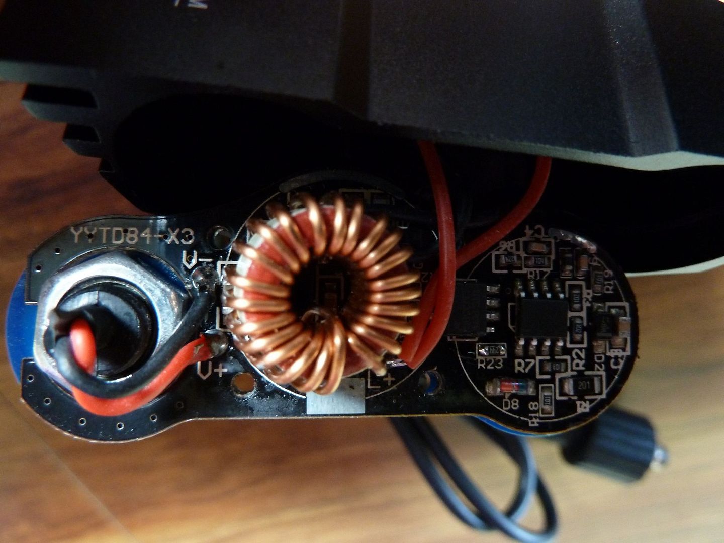

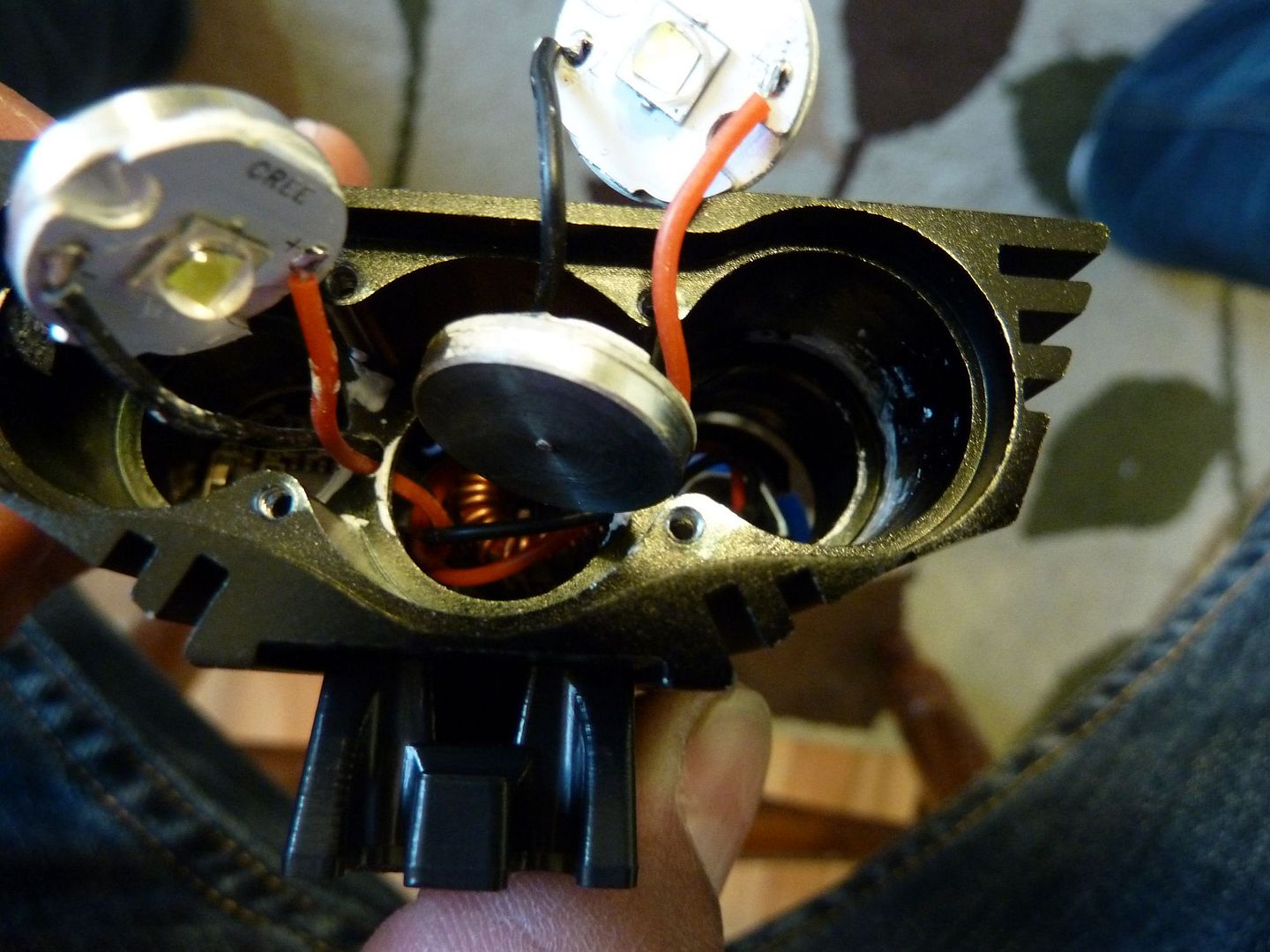

    Yep, mine has pills. Not sure if it's an original SS or not (it did come with phillips head screws and not hex heads). Some have been bought without pills too.
    Pic of mine:

    Those pills look like they were somewhat loose fitting? If they aren't a really tight fit there isn't much value since the heat transfer will still be bad. If you can get some thermal paste between the outer edge of the pill and the matting surface of the body that might help.
    On my sample of the SS X2 the pills showed no signs of being removable... I assume they were press fit in place, but I never tried to press them out.
    Yes, I call them a "loose press-fit". I did put thermal compound around the seats. I can't remember testing heat transfer to say how well it works. I've only had it on high for a few minutes at a time so far.

    Board looks like mine except that yours is red and mine is black:
    Mine pulls 2.48A on high from an 8.4v pack, so roughly 1.60A per emitter.
    -Garry

    1,810
    @Tigris99, can you make closeup pictures of a driver with coil lifted. Is there LEDA chip somewhere? Sense resistors should be connected to that chip. I don't see any R250 resistors.
    @Garry, from your pictures it looks like your 3 leds are connected in paralell while I can't see how the Tigris99 led PCB is constructed.

    Ledoman: Ya there is a LEDA chip under the buck.
    Best I can tell all 5 route back to the chip. Dont have a microscope but I can see traces that look to be linked back to it. Just noticed in the pic ONE OF THE 25s IS BACKWARDS, not sure how much itll matter but WTF,lol.

    @Tigris99, I'm speculating. Is it possible the driver doesn't use PWM, but rather different combinations of sense resistors directed by gates Q1 and Q2 to compose the modes. If I take two group of sense resistors and calculate combinations (0,25V feedback voltage for LEDA chip) I get:
    - 1.66A
    - 3.01A
    - 4.71A
    Divided by 3 assuming leds are in paralell the highest mode is 1.57A per led which corespond to Garrys measurments.
    Can you somehow check if you see any PWM? For example over the screen of camera or with some frequency meter.
    PS. I don't see thermistor anywhere. On the Garry's circuit it can be seen as a small black resistor like without any markings.

    On my driver board they ran two sets of wires to the emitters. One set drives one LED, the other set goes to a second LED. That second LED then has jumper wires to parallel connect the third LED. Result is that all LEDS are in parallel with the driver. Mine has never stepped down (though it's not been run hard). My pills are slightly loose and I added thermal compound to the seats.
    -Garry

    Garry where did u get yours cause mine doesn't have pills, its a single aluminum plate that all 3 attached to.
    Ledoman, that very much makes sense being low and medium have a high pitch squeal /buzz. Thought my light was just weird. Guess ill need to test which resistors are doing what modes. Whats ur "theory" on how the resistors are being used on low and medium? im going to try and run some testing/calculations to figure it out, but im hoping the mode steps are opening up through each 250, would make sense, 3 modes, 3 steps.

    Mine came from Ebay seller "Jingle-Shop" (or Jingle_Shop, or . . .). Doubt you can reliably get the same one.
    So you have a floating emitter pcb? Just the aluminum emitter pcb sitting on "lips" of the body or something? My PhotoBucket album pics clearly show my pills.
    -Garry

    Ok so adapter to fit optic in center done, designs for internals is done, aluminum prepped for machining.
    Making another uni-pill design and since this housing has set up for pills, im going to machine it to fit in, holes between been tapped for screws and so on.
    Have a bunch more optics, variable sense resistors, 18 awg silcone wire, and so on. Got a good case for getting crazy with.
  139. #139
    RAKC
    Reputation: tigris99's Avatar
    7,146
    OK this is going to be pic heavy but its done. I dont even really mess with output that much, maybe boost high a tad but thats it.
    Noctigons, 18 awg silicone wire throughout, new uni-pill (6mm thick aluminum after machining) to move leds out to fit optics, made a spacer for the center than also turned into a press fit copper pill retainer,lol.
    But this light is AWESOME NOW!!! Color is EXACT same now with optics, I just switch emitters from stock board to 16mm noctigons. I honestly am not sure if it puts out any less than my KD2 cause KD 2 is set up spotty, this is set up flood (with eliptical spot optic in the middle). Didnt even notice output difference till medium and high which isnt much less.
    Granted I have a yinding on the way (I like the looks better than my kd2, steal my driver, emitters, optics from it) but IM ready to go, couldnt be happier and this light went from pissing me off to MAKING MY DAY!!!
    Pics:
    Beam shots are same power, different exposure times (show beam pattern better)
    Tomorrow run some thermal tests... but not a single issue so far.

    Not sure what pwm means, hoping it is what my theory is, each of the 250s is opened as gate is opened, going to test that today. I left wires from driver to emitters extra long so I can run tests. I gotta sort that out cause with mods I dont think I need airflow to maintain high lol. Means I can boost it. Too bad I can't boost individual emitter.
    Btw, sorry here's the finish pic.
    Looks like im gonna be outfitting my son finally (long story) so now to decide what he's getting. Thinking my kd2 (turn it down)cause I have a yinding coming and mod up a ss x2 or just another kd 2 set flood. Or get kd mj880 clone for his bars. Decision decisions though mj880 clone gives me a new light to tinker with lol.
  142. #142
    1,810
    PWM - Pulse With Modulation or in another words pulsating current to the leds. Shorter the time of the pulse is less light human eyes sees. 100% period/pulse make highest mode, 50% period make mid mode for example, etc... The spikes are always 100% current it is just the time period that counts. I hope you got it. If the frequency is to low then you can see the flickering otherwise with higher Hz
    human eyes doesn't recognise those spikes and see only an average brightnes. Read also Pulse-width modulation - Wikipedia, the free encyclopedia
    The other way to make modes is to use different sense resistors and switch between them. This is what I suspect is implemented in this driver. So no PWM used while Garry's driver is different and probably use PWM.

    Well I think mine does being the buzz that comes from it, sound like an old television.
    But I did notice this:
    R 300 each separate, r250s 2 are soldered directly side by side to each other, 3rd is next to them but separate solder point. Having trouble sorting traces gonna see about a magnifying glass to help but still a mess in there lol.
    Also would a standard digital camera see modulating light?

    That being the case sense resistors have me confused slightly as to function of 5 of them. Especially when 2 are directly soldered to each other.
  146. #146
    RAKC
    7,146
    Ledoman, ur exactly right full open all the time. Read voltage drops at sense resistors as I increase to med and high. However not sure how or y but our calculation for low and med right on, high however is 2.6-2.7A. Voltage is .8, 1.8, 3.4.
    Tells me we missed a detail on output, something different here but 50% (med) doubled matches up.
    Now that I know how to do these tests (current resistors are a function of negative side not positive, cost me a dmm fuse lol) want to go back through and check my kd2. So I did. Hooked up solid in series and only got 2.25A on high (that's vs 3.28 calculated). Not sure where loss is there.
    Edit: Shit now garry's method makes perfect freaking sense.
