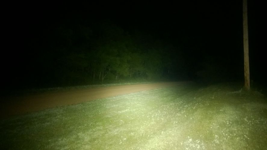

    Next, beam shots. All I have to say is WHY, WHY IN THE HECK DOES A BICYCLE NEED THIS MUCH LIGHT???? This is like a motorcycle light on high beam, it's insane!
    Ok this is flood optic only on high (my camera was not liking turbo) and had to turn down to 1/10 second exposure time. Usually run at 1/6.
    Ok now first the area that I lit up. Sorry but twisted ankle at work, no bike time tonight. I had to turn camera exposure to 1.3 seconds to get the shot to show what the street light does. Then turned back to 1/8 second exposure for the light on. This is with STOCK INSTALLED "SPOT" OPTIC. The hill all the way behind the house is approximately 100 meters away.

    ^^ ( photo )...looks good. Keep in mind though almost all lamps are going to look good on a flat light-colored surface. Good to hear it comes with a very good battery. Actually, I would of preferred a good 6-cell with a lamp like this. At least something around 7800mAh. The more cells the more potential for a longer running high current output.

    At the second shot - at the most interesting place there is a streetlight. And it`s difficult to assess how much further throw this light. I know, that it`s flood, but in this case it`s time of number transition to quality. In other words, can I tear about at a speed of about 19 mph in the night forest with this light?
    And the second question about low mode. Does it admit move safe, and dazzle oncoming not very much?

    Looks ok, but I think the beam is going to be disappointing for my tastes. To me there is such a thing as too much or maybe I should say too bright of a flood area. My perfect beam, even for the bars, will be brightest in the center of the beam with good throw and then smoothly taper off and dimmer as it extends out to the edges. If the beam is anything like the bt40s then the beam is brightest close up in the flood area and dim in the center of the beam at distance. I know you can fill in the gap in the beam with a throwy helmet light, but in my opinion the bt70 has enough output to do both if they design the right optic. Its hard to tell yet until we see more beamshots, but this is just my initial impression . Thanks tigris for doing the reviews.

    I have the same taste! But this light expected as flood. And the first beam shot made with flood optic. There are another - narrow optic.
    I ordered this light, for all that))

    OK need a blood transfusion after that....going out to path to take more beam shots.... OMG couldnt believe the mosquitoes!!!!!!!! I had some beam shots that had lines through the picture from them flying through the shot.
    Cat, yes i forgot to get low beam comparison shots, but I did check the 2, BT70 is actually noticeably brighter on low but not by alot.
    BT40S on turbo:
    BT70 Spot optic up close on high:
    BT70 on High:
    BT70 on Turbo:
    There is ALOT more light down range on the BT70 than bt40S. Brightness at a distance increases far more by level than flood does. That arch at the end is 250-260 ft down from where I stand (I actually marked the pavement last time I was doing beam shots so all are from the same spot).
    And yes I know its a bit fuzzy looking, its REALLY humid here especially on the wooded path, so glare just from moisture in the air is annoying.

    Cat, yes i forgot to get low beam comparison shots, but I did check the 2, BT70 is actually noticeably brighter on low but not by a lot.....
    ....There is A LOT more light down range on the BT70 than bt40S. Brightness at a distance increases far more by level than flood does. That arch at the end is 250-260 ft down from where I stand (I actually marked the pavement last time I was doing beam shots so all are from the same spot).
    Thanks much tig. If the low mode is a little brighter than the low mode on the BT40S that means it's going to be quite useable.
    Obviously the BT70 has more throw than the 40S. It might not be as dramatic when on single track but at least we know it has more to offer. I would think the output on medium would be more than enough for general riding.
    The fact that you had humid conditions when taking the photos only means that on a clear night you will have even more to see.

    OK better Comparison of BT40s vs BT70
    BT40S on turbo:
    BT70 on turbo:
    Working on sorting out the little video I got from tonight. Gotta say this SooCoo C10 gopro clone is FREAKING WAY BETTER THAN MY ION at night!!!!

    Nice hotspot!! It would be better to see more the comparison of low and high) and BT70 - the difference between the lenses ..

    Quote Originally Posted by Advard View Post
    I found it. But without comparison - it is difficult to understand how it shines ..
    Nitefighter BT70 User Review:- Mtbr.com
    I only have one light head and limited time (time to ride my bike is far more important than all this ) but it is wider, less throw beam pattern.
