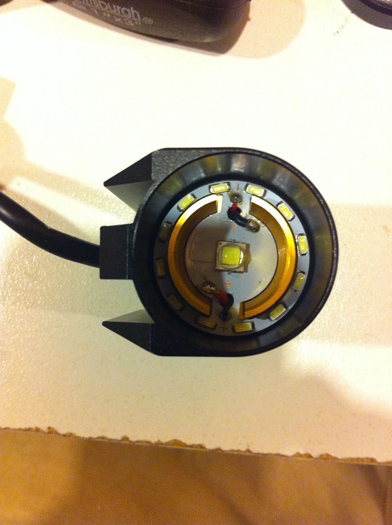

    Andy, here is a pic of the emitters:
    You just trim that emitter board to separate the smd's from the center board (two small tabs to cut) then replace the center board with a standard 16mm one.

    Ah, now I see, you only have to make four little snips to free the center of the board. Thanks, Garry. By any chance do you have to remove the back to get the front to come out, or do you just need to unsolder the four wires? Because mine seems stuck, will only pull out about a mm or two. And it's aligned crooked too now, didn't notice that before. (This is my third lamp head, which I bought just to mod to tail light, other two I've been using as commuters are normal.

    Hey didn't even think of it but light does good stock PCB if u can reflow emitters with a soldering iron like I do

    Wonder what effect would be simply de-doming and then replacing elliptical diffuser with either a concentric, 60 wide angle lens, or even a plain 20 optic for use as a spot with super throw. Would be the cheapest and easiest solution, if it worked.

    You don't need to take the back out, but it sounds like yours has really short leads. I never fully took mine apart. I had another user replace the emitter and look at bumping output on the driver.

    Well Garry it doesn't feel like it's tugging on leads, more like it's hit a wall. Really jammed somehow. As long as the back doesn't have to come out though maybe I can still work on the board in front as long as the leads to the emitters are long enough. Though with de-doming, the board doesn't even have to come out. Still wish I could figure out how to [re?]align the back.
