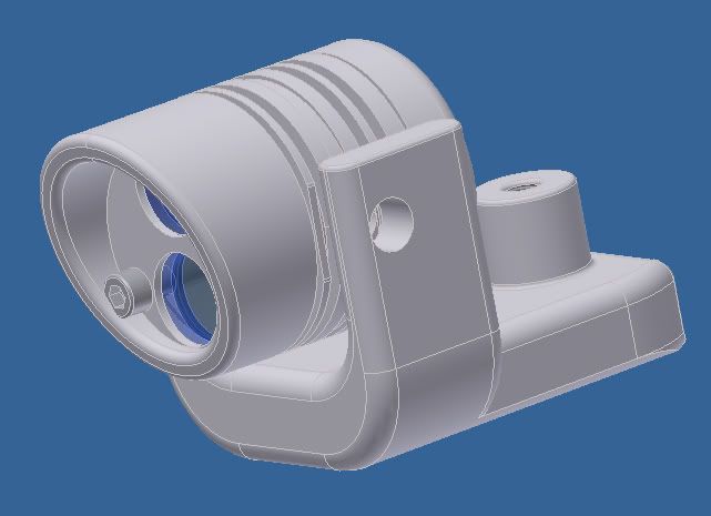

    Thanks for the tips! I am looking over different options for a DIY light. At the moments, here's whats in my mind:
    Should be in the DIY section I know. Couple of MCEs, the upper one is a medium optics, the lower a very narrow one.
    I use a Headlock for the headset, and was thinking of mounting it on that screw; the rear bit is inserted in the fork tube...

    Try a light attached to the frame so always pointing the direction of travel not where the bars are pointing, mixed with a bar light aswell, it's very nice, feels very strange at first to as it slowly moves to either side smoothly.
    Hard to mount a torch there long term though with ease of battery changes and right direction, but I think i'll have another shot at doing that soon.
