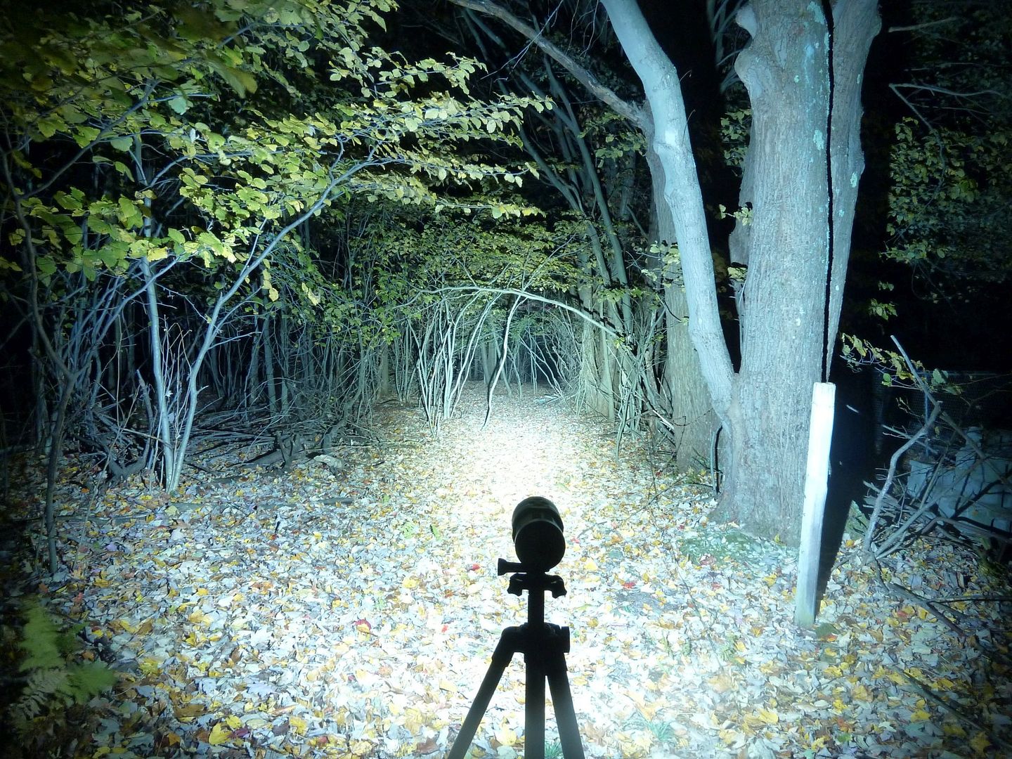

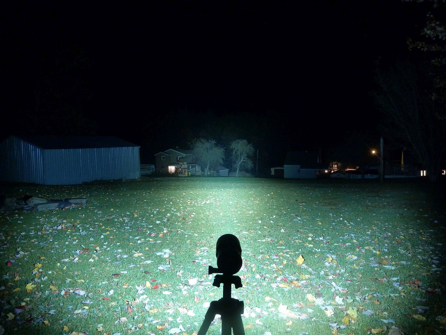

    So I recently received my Thorfire BLF Q8 custom manufactured flashlight (one year in the making, long anticipated, and only $40 during the BLF group buy which generated over 1,500 orders BTW). So I had this thought - how about mounting a Q8 on the bars? The light comes with a 1/4"-20 tripod mount, so add a GoPro adapter like so:

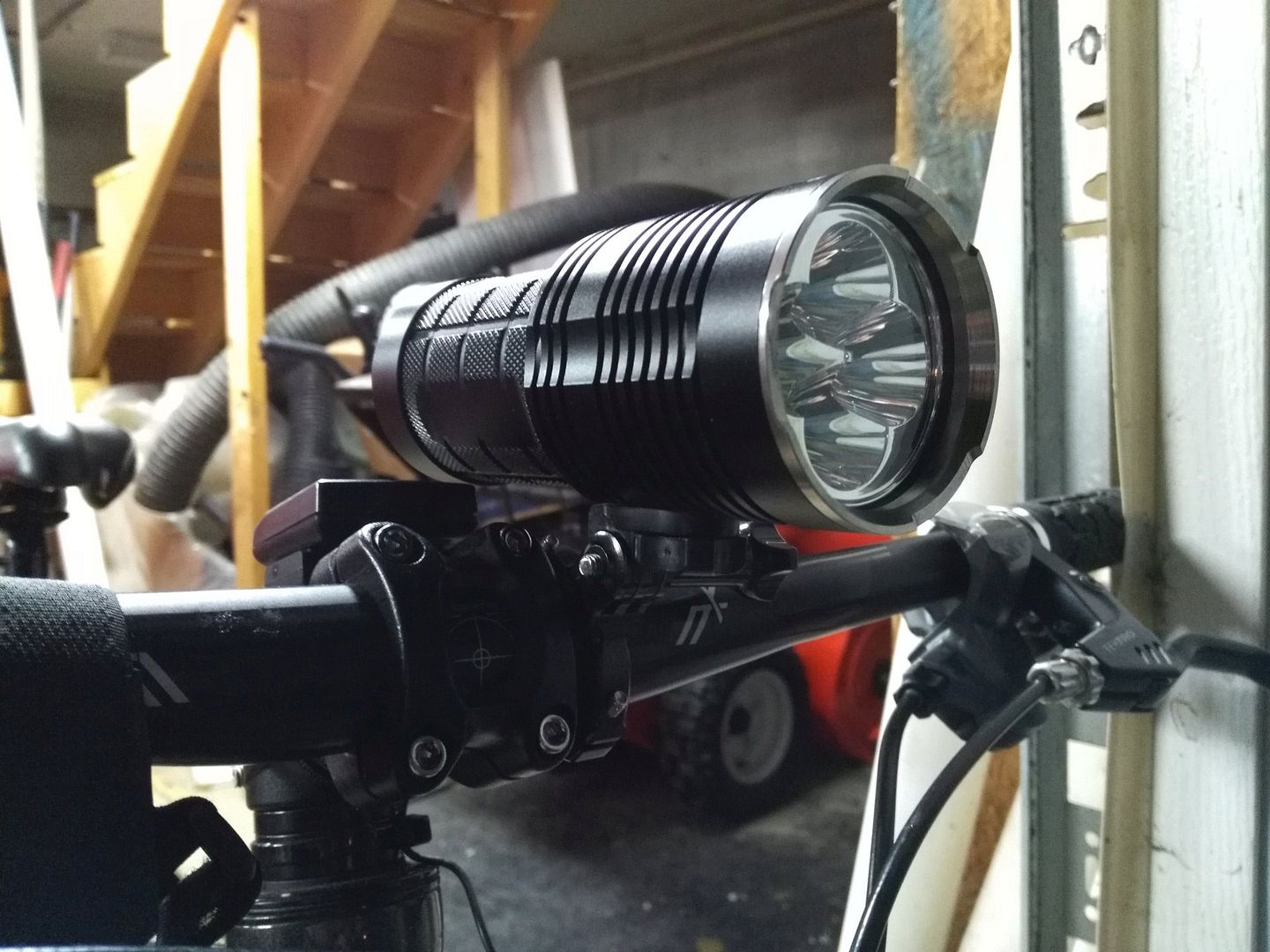

    Then mount on the bars like so:
    Then light up the night like so:
    and:

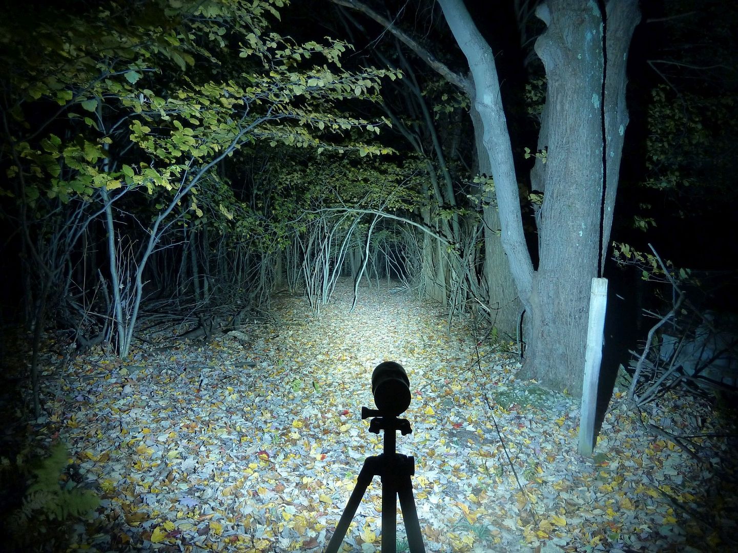

    Actually I've found the standard MTBR camera settings do not represent what I actually saw, so I adjusted the shutter speed from the MTBR standard of 1.6 seconds to 1/2 second and captured this photo:
    For comparison I looked at my highly modded 2,100 lumen BT40S:
    and:
    It's interesting that you can see a huge increase in output (and drastically more throw) in the yard pic, but in the woods the increase doesn't appear as evident. Now the yard pic was with standard MTBR settings, but I didn't notice it looking unrealistic in the camera like I noticed with the wooded shot.
    I realize the tripod adapter I used is plastic and can't be trusted, but it's proof of concept! Maybe vanc should market some heavier duty mounts for this light.
    NOTE: all photos are clickable.

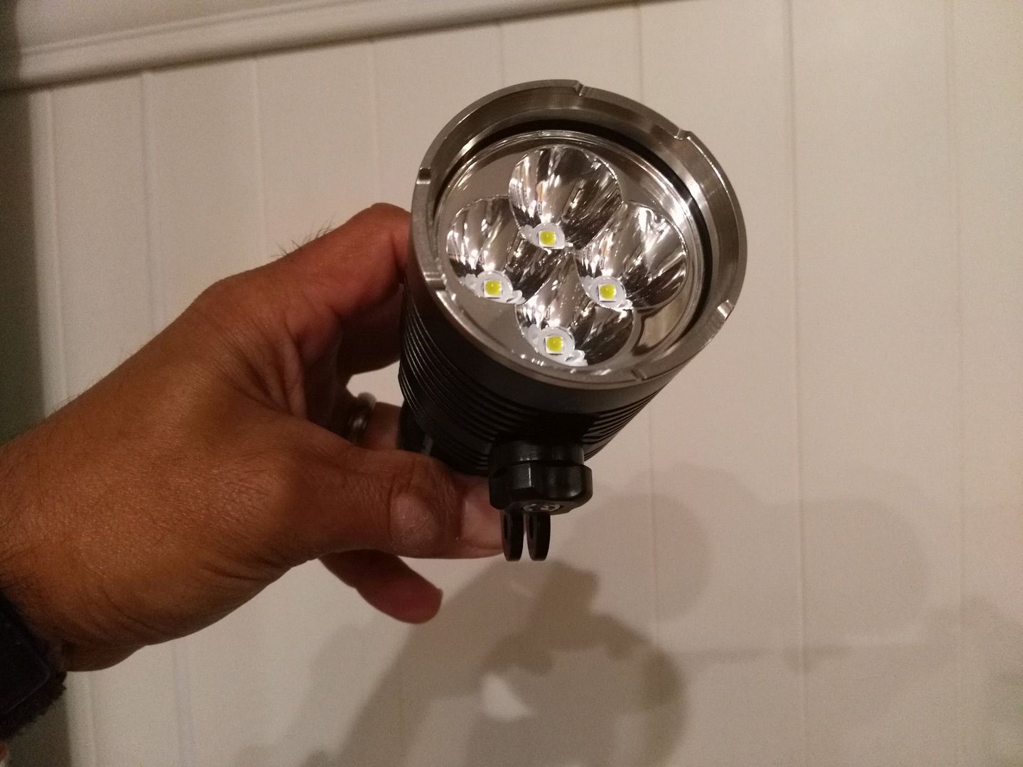

    For those not familiar with the Q8 or not investigating it's specs, it's a 4x XP-L neutral white flashlight running custom firmware pulling about 20amps on high from 4x 18650's in parallel (high-drain cells) for a verified 6,090 lumens on startup dropping to 5,620 at 30 seconds.

    I didnt take pics but I have mine and put it on my handlebars briefly for giggles. Having the tripod threads is cool though. I have tripods so can very useful.
    Right now the light is sitting in my CRV just to play with when out. Havent found a logical function for the monster but fun to see how it takes before people start trying to figure out where the search light is coming from.

    For me, my concern is more that simple tripod threads would hold up to the abuse. Definitely need something like a Vanc mount to make it hold up, along with an aluminum bar mount.
    For the size of this thing I dont know why they didnt stuff a USB charging port in it too lol. Getting to the point Im gonna need a second loose cell charger

    This made me start thinking. I just slapped something together for curiosity when I mounted it the first time.
    Now Im curious if those gopro stem mount things will hold the weight. Not on my trail bike, but on my fat bike. If it wasnt for raceface carbon bars and their stem design for carbon bars Id just have Vanc make me a stem cap. I need to read the Q8 thread see if we have some run time info. If its got a good run time at about mid output and mount will hold will be a perfect, obscene light for the fatty.
    My stem is wide with a channel the light fits into well, some adhesive pad it should be well supported on the tail end as well. All provided I can get it aimed right (not too low) doing that.
    The joys of having close to 10 Vanc gopro adapters now. I have 2 unfinned versions. One original and one lopro version.
    Ill share more pics after I get it mounted up later.

    Garry, because of you I had to actually make something workable added blue loctite to the screw so it cant randomly work loose. Not something I can be bombing root beds and step downs with but for general stomping it should be FUN!

    I dont think velcro will be required. Right now its almost perfectly balanced luckily.
    Not like Im going to be bombing chunky decents lol.

    I've seen this mount too, I think it's the most sturdy option, but the light probably would not fit. I think you would need a "flipped" version.
    I was thinking about making pretty much the same mount.
    Two of these cheap gopro mounts without the actual "gopro" part, one on each side of the stem. An aluminium plate would go on top of them, the light would sit on that, and it would be fixed with the tripod screw. It's a pretty cheap option and I think it would be easy to make. So pretty much the only difference to the above mount would be that the light would sit higher up with this mount.
    I really want to try this, I think the mount would be sturdy enough, but i'm afraid how strong the tripod mount is in the lamp and how strong the connection would be. Has anyone used the Q8 on the bars for a longer period yet? I wish you could connect a lanyard to the Q8, that way I wouldn't be afraid to try mounting it to the bars. Worst case scenario the mount fails and the light would just hang by the lanyard.

    2 of those mounts joined by a plate would be more than plenty strong as long as you are using 31.8mm bars. Used with a shim for 25.4 and all bets are off. Depends on the shim material.
    Anyone with the Q8 measure how deep the tripod threads are? If you can get 6 or more full turns of engagement with a 1/4-20 screw then it would be fine for use. Crashing might be a different story.....

    I followed your advice and left the light as is it. I've tried it with "regular" GoPro handlebare mount, but I wasn't happy with it.. ..so I put together a new one. It's not pretty, but it holds the light still.

    Yesterday it was my first test ride and the mount is good. On one drop (cca 1.5m high with landing to flat) light turned off, I suspect that battery lost the connection (I use LG flat head batterys).
