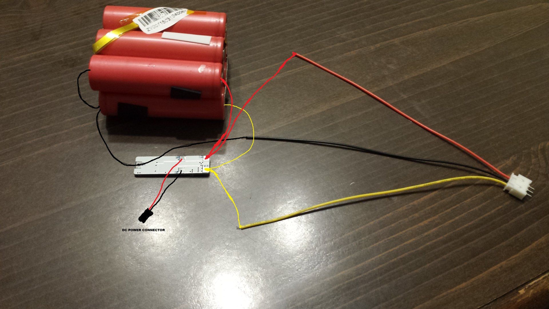

    Ok.. here it is. I have a problem, and that problem is easily solved, but requires soldering. Not sure how much heat can the battery take and not get damaged. I believe it wont heat up much, but.. opinions? I have to cut the BM contact in order to turn the protection circuit around.
    The cells are pink. are they samsung.. LG or some chinese knockoff?
    The voltages are pretty consistent, one 2P is 4.10V, the other 4.14V
    The Battery Thread 2016 and Beyond-cdedacaf97f93ba9680cf4e3d2bf06cf4f282d60d11425836493ac370a9bc5cc.jpgThe Battery Thread 2016 and Beyond-4ace17744cab18baa3bd43cb736276f482a7166d853e36f31a77616012af849a.jpgThe Battery Thread 2016 and Beyond-e3c9db6333d69536ae5eb897e2d444d5edad248839183262d8de448c00091ae9.jpg
  83. #83
    Jul 2015
    183
    f... it..
    I broke it of, solder it later...
    can't make a better macro. my camera is crappy, and phone hasn't got a macro...The Battery Thread 2016 and Beyond-zoom-pcm.jpg
    now I have to make some kind of a glove...from a surgical glove
    blah, no macro option on my phone, but a magnifier app on the phone so good it would make awesome macros
    the smallest IC says 2120 CB, and two other are marked 8205A 1545

    Looks like corrosion on one pair of cells???

    Dunno. I packed them away. I think it was some kind of soldering paste..
    edit:
    Yup, 'twas corrosion. Cleaned up most of it, and repacked the batteries.

    Get rid of those batteries, they are already leaking.

    hmmmmm I wouldn't be so sure. The only corroded part was the top of the battery ( it looks like a metal dome on 4 "legs" atop of the battery. The flat part on which it resides is nice and shiney. I would sooner say that the corrosion occurred due to the glue with which the top foil was glued

    this is what I'm talking about.. the 4 point "dome". Underneath it, the metal is absolutely clean without signs of corrosion

    The cells are Chinese estimating based on previously seen at about 1100-1200mAh each so up to 2400mAh for the pack at best.
    Voltage would be consistent if the difference was 0.01V or less.
    Since there are no markings on the cells I can only guess but those cells behaves quite well at very low current. At the higger currents around 1A and above they have prety low capacity. Take a look at http://forums.mtbr.com/lights-night-...gb-982688.html
    I would use this pack for very short rides and with weak lights only. They are also good for limited testing purposes.

    I have a question. I was trying to balance out my crap pack today. I soldered the balancing plug (red on end +, black on end -, and the yellow one on the ++/-- connection). The plug is wired red/black/yellow. I asked the service at hobby king for the pin layout on my turnigy charger, and they say it doesn't matter. Most plugs I see online have red/yellow/black layout. When I plug in the balance plug, the charger starts to scream high voltage warning. It's set up correctly, balance at 0,8V, 7,4V (2S)
    What's the problem?
    I plugged the pack to my lamp, and after 90 minutes of medium intensity work, I measured the cells. They were around 3,8V. Still the charger screams to high voltage. why?

    Did you solder on the input or output of the protection circuit?
    Also sounds like you balance plug is pinned wrong. Should be red yellow black.

    You wired like so?:
    Close-up of PCM:
    -Garry

    yes, exactly like that, but I soldered it directly to the cells (well, the little tin foil connecting the cells).
    I thought it might be wired wrong...

    ok, I changed the black and yellow wire, and no error. It's balance charging. Stupid hobby king operaters...

    I should have looked at your pics more closely before, ya you had that wired wrong lol. Freaking idiots at big name hobby stores. Dumb teenagers usually that don't know anything beyond plug and play.

    I connected it right. As I mentioned, but my balance plugs came with different color order than my gut told me should be right. I blame the whole thing on the hobby king customer service

  183. #183
    1,849
    To watch the current you need to put measurment equipment inline between charger and battery pack. I'm using simple LED Digital Voltmeter Voltage Indicator Ammeter 0 - 30V 10A SH | eBay and two CCTV connectors. Or you can use DMM with some way to make good inline connection (thick and short cables gives you more accurate readings). It doesn't matter if you insert DMM between positive or negative poles. Both way you would measure the current flow.
    How to measure current wit DMM - simple explanation but you can google out much more.

    EDIT: I just tested the charger and it comes out at 8.38V. The pack fully charged is 8.25V. I can't check the current because my DMM only goes up to 200mA. A good excuse to order a new DMM!
  185. #185
    Aug 2013
    834
    You can connect your DMM when indicator LED is changed to green (i.e., near end of charge): actual current should be very low at that time...
  186. #186
    1,849
    Or zero if cut-off feature is implemented. But yes it should be lower than 200mA. Normaly at hobby chargers cut-off kicks in at 1/10 of starting current.
  187. #187

    58
    Quote Originally Posted by ledoman View Post
    To watch the current you need to put 9measurment equipment inline between charger and battery pack. I'm using simple LED Digital Voltmeter Voltage Indicator Ammeter 0 - 30V 10A SH | eBay and two CCTV connectors. Or you can use DMM with some way to make good inline connection (thick and short cables gives you more accurate readings). It doesn't matter if you insert DMM between positive or negative poles. Both way you would measure the current flow.
    Sir ledoman if you dont mind sharing pics of the inline voltage monitor? Im trying to look for connectors to do it. thank you.
  190. #190
    Reputation: garrybunk's Avatar
    Feb 2014
    1,850
    This thread may help. The setup needs wired differently for monitoring chargers. Contraption to Measure Current Pulled from Bike Light Battery Packs - REVISED - See Post #12 | BudgetLightForum.com
    -Garry
    "My Bike Lights" Thread on BLF teardowns, measurements, and beamshots. Moving my photos, PM or post up if you can't see them.
  191. #191
    1,849
    kikoy, I hope Garry's pictures are good enough. If not I can try to make some.
