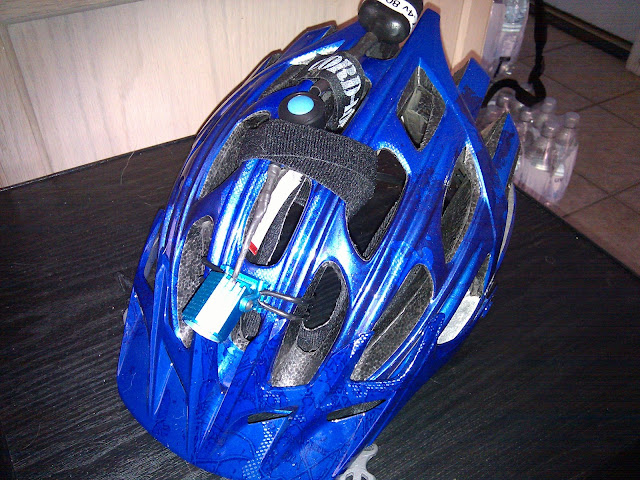

    Here's the little guy mounted to my S-Works helmet. It's awesome! Great job on it, Ed!

    Hey Chelboed, just in case you do start making these for sale at some point, I had a thought about that mount.
    Instead of just the 2 "hooks" on the sides (where the rubber o-ring hooks to), if you made them with hooks on all 4 sides, it would be more versatile, giving people more mounting options.
    Like in the photos above. On that helmet the o-ring could go front to back around that center vent bridge.
    That would also make it possible to mount to a handlebar (maybe with just a little piece of rubber underneath).
    Just thinking out loud.
    2,687
    Heck man...that looks 10x better on your helmet than it ever did on mine. Excellent. Glad it works for you.
    Nut: I agree. I had produced the light for myself just to see if I could put a 20mm optic in such a small housing. It was designed for my helmet (Bell Influx). If I were to reproduce them, the mount would need to be different.
