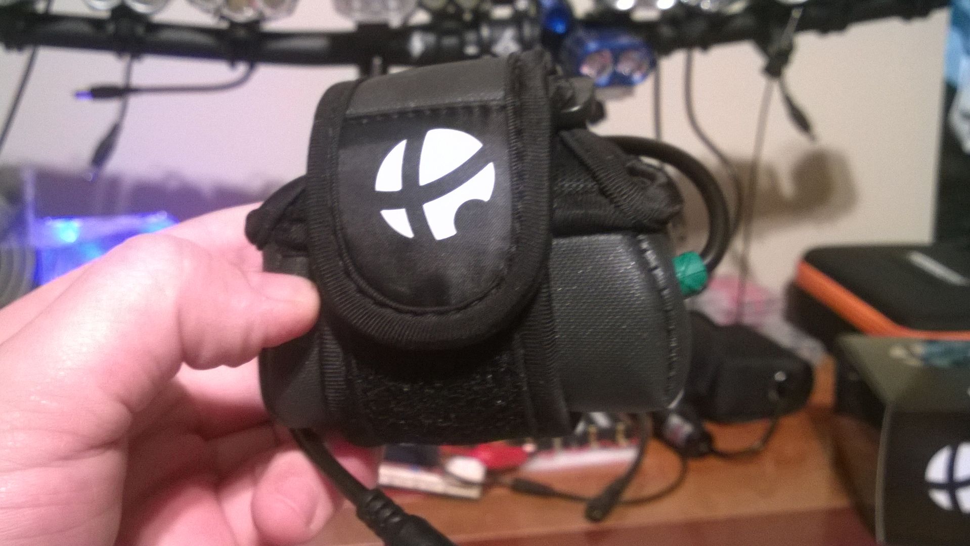

    -4x18650 Cell water resistant pack with standard Xeccon neoprene pouch. 2 hrs claimed run time on High

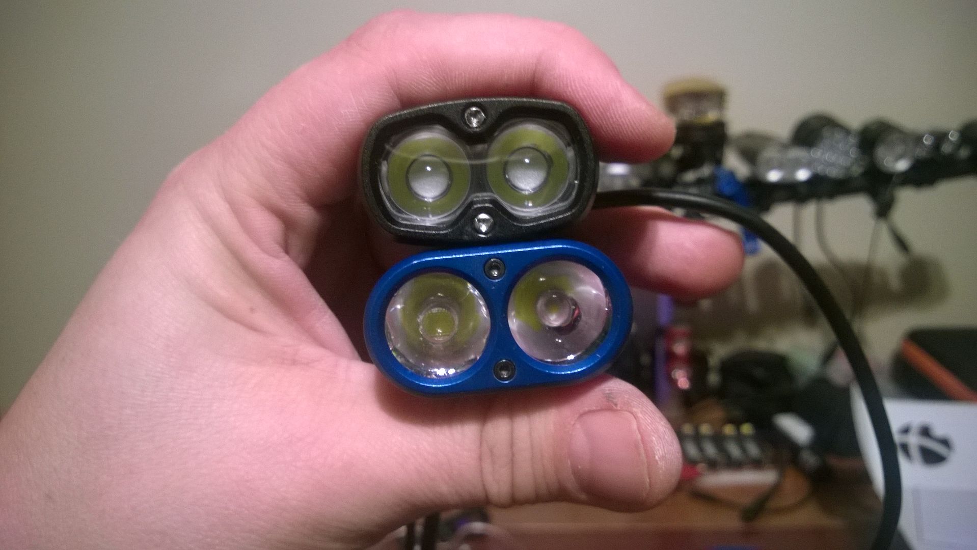

    WOW this thing IS SMALL for a 2 emitter light head. Very clean, quality finished look and feel. Wireless Remote definitely a nice touch.
    Also, WOW this thing is bright for being so small. You would expect it to be lacking on output. After all its smaller than a yinding. But ITS NOT! Blows away a stock yinding in the output department.

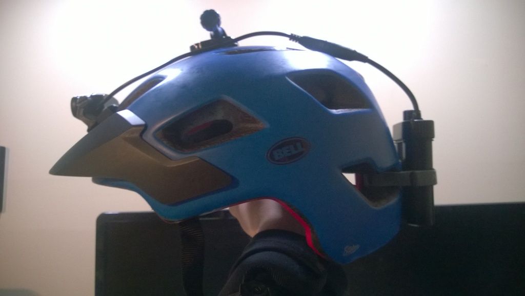

    Helmet mount is really simple but VERY secure. Not your standard issue velcro, its like velcro but much more cooperative.

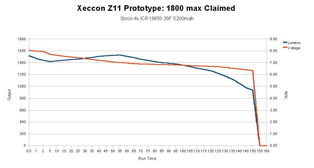

    Output
    Claimed Lumens: 1800
    Actual Lumens*: 1779 Lumens (cold start), 30 seconds(ANSI starting point): 1524 Lumens
    Run Time/Output Graph:
    Modes:
    -Low: 166 Lumens
    -Med: 649 Lumens
    -High: 1487 Lumens
    -Burst: 1709 Lumens
    Emitters: XM-L2 U4. Estimated color temp/tint is 6500k 2B. Mounted on 3mm Copper pcb

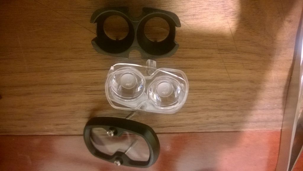

    -Uses TIR optics
    Beam Angle: approx 15 deg spot with almost seamless/smooth transition. But best Spot pattern current of new 2016 lights, best Helmet option. Hoping to get it improved for Helmet use prior to production.
    Run Time
    Current Draw:
    Low= 0.1A,
    Medium= 0.9A
    High= 2.1A

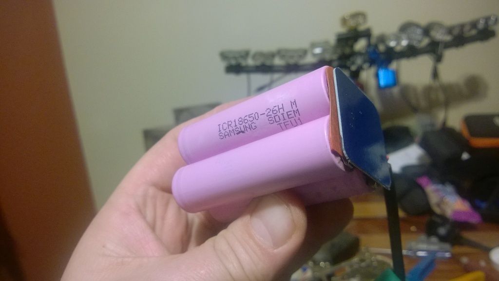

    Pack Spec: Samsung 18650 26H 2600mah, 2s2p 4 cell
    Claimed Run time: 2hours
    Actual Run time: 2 hours 8 minutes first cycle
    Charging: 6 hours via standard 1A wall plug charger.
    *Protection Circuit is on top of battery pack.
    -Will work with MS style connectors, hold very securely, but these connectors are square formed (around standard DC 5.4mm) so be advised, be sure to disconnect after use in rain and such so connectors can dry out (not water proof but keeps most out) to avoid corrosion.

    Ok first I posted in OP. The minor UI fix. Not a huge deal more of an annoyance since Ill never use the first mode group.
    We all want 5000K emitters.
    Thermal management: The gradual step down is nice. But head heats up to easily. We are working on that. Problem I have is the step down function. Goes between medium and low no matter what once it engages. Hoping we can convince Xeccon to change that. Preferably stop decreasing power once temp hits a certain point then return. At least not drop so low. Thankfully these are only changes to the firmware program.
    Next issue: Thermal. One it gets hot rather quickly. Thermal Step down is set rather low, head hits 140F before stepping down. At least its gradual but it cuts all the way down (slowly) to between low and medium. Doesnt stop if head cools either. Reasons it has thermal issues even on the wind tunnel are 2 fold. First is the rear cover, little plastic cover that is fully width of the rear that on half it helps hold the battery cable, other is just empty space that it covers. After opening light, I find that is also where the MCPCB contacts the case mostly. That rear wall that is covered by a plastic cover instead of finned. New heat sink to be mounted there I am working on, Xeccon I beleive is going to do the same after I test it. OTHER ISSUE, the big plastic tabs on either side for mounting are blocking and insulating a large section of the fins on either side. Trying to convince them to make at least the arms that attached to the head directly out of aluminum. Also, going to try and get Xeccon to switch to XP-L emitters as they are much more thermally efficient at these drive currents. 15-20% which will help alot.
    Need for a better battery pack. 5200mah....needs to be 6000mah + IMO, only for the fact it will stay in regulation longer.

    You might just open the pack and see what cells are there. If they are of known type then we can easily calculate aprox. runtime based on current you would measure. Of course this is only suggestion so we don't need to wait. But take your time
    RAKC
    Reputation: tigris99's Avatar
    7,127
    I was planning on opening the pack up, I forget xeccon uses only branded cells. Save me from having to sit there for 2+ hrs lol.

    Cat: Im not sure my opinion on the optic yet, the center is frosted inside.. Spot angle approx 25deg. Think they need to loose the frosting in the center. I may polish mine out see what happens. Definitely NOT your normal optics design, heavily dished on the output side as well. Think they were going for a more even/smooth beam pattern.

    Yes, mounts will be changeable via those screws. Helmet mount shown, bar mount will attach to head the same way.

    Frosted optic you say, strange. Might end up being more of a bar lamp. Does it come with a bar mount?

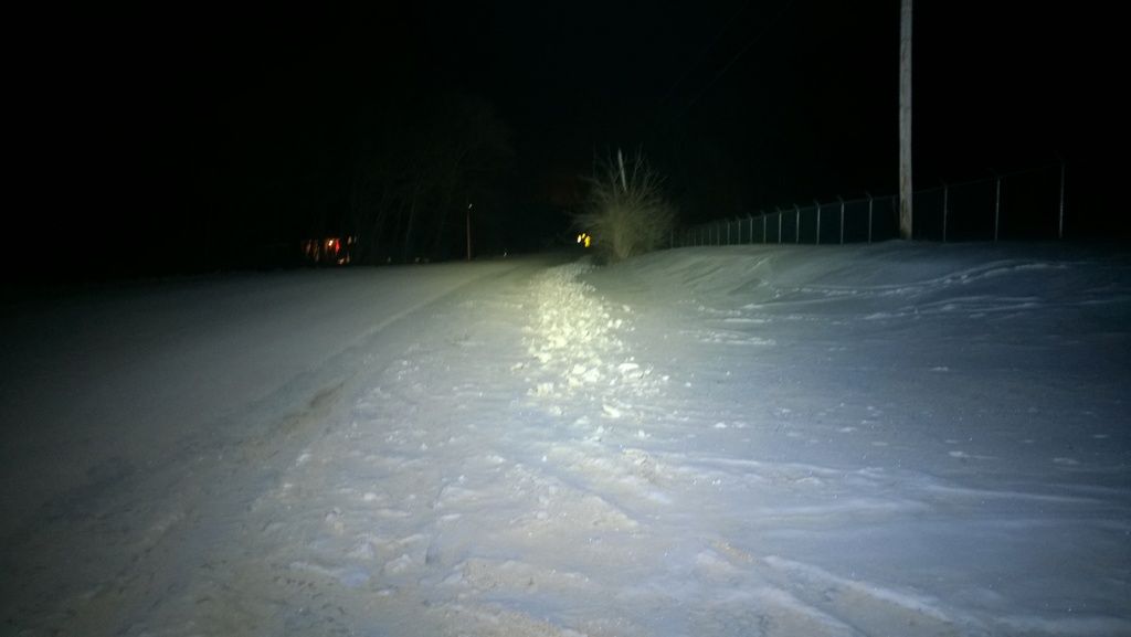

    Heres beam shots, light completely stock. Oh and pics of Z11 being used with my normal fenix case for my helmet.
    Also both TINT and BEAM PATTERN were both very deceiving. Compared to 3C tint lights, it looks much cooler. But now I see WHY they still blend well. My guess now is 2C tint, around 5500K. I didnt see yellow really until up against the other xeccon light i have (wide flood beam single emitter unit, youll see thread pop up from person reviewing that soon) which is truly cool white. Not headache inducing "cool blue" white, just more of a pure white which brought out the yellow in the Z11. I like the tint as 3c/4c yellow REALLY stands out in the snow, kind of annoying. This tint is more towards the white side and visually looks like using 3C during the summer months when you dont really notice much yellow.
    Also you cant see it really well in the beam shots because though cold, VERY VERY humid air, but youll see it in the video. Their is a much better hot spot than I thought and throw is there. Its not for the guys who like laser pointer helmet lights, but I LOVE IT! thing is the beam transition is so smooth, its hard to find the actual true hot spot until I was running the combo (other light on bars this on the lid) as the bit of yellow clashing against the cool white shows the hot spot that's hiding in there.
    OK enough talk, PICTURES:

    Heres to show the spot. Forgot to bring a 3C light to show the difference in tint. Ill get that this weekend if I remember.

    Ok finally got the xp-l mod machined and ready to install. Dtp copper sinkpads will help compensate for the adapter being made of aluminum instead of copper.
    Now well get to see how much of an improvement we get in case temps in this head. I see great results in my yinding and bt21. Drive them harder than stock xm-l2 on both but they run a tad cooler.

    Update:
    Did what I expected, slightly cooler running, output matches almost down to the lumen lol. But not as cool as I was hoping.
    That said, loving this thing on the helmet. Not a throwy as my custom lights with xp-l hi, wider spot but with having my Wiz20 on the bars the combo works really nice for me.
    Best part is the helmet mount, having light and pack on the lid is much less noticeable with this light being right behind my helmet visor and much lower than my normal set up.

    And have the Output Graph for this done! THIS IS TOTALLY STOCK UNIT, XM-L2 emitters, stock battery pack etc. Only "change" is prototype heatsink added that I machined up to replace rear lower cover to solve heat issues so I could run this test.
    Google Docs chart (once i get data copied over) as it has better image quality:
    https://docs.google.com/spreadsheets...gid=1211333571

    Wanted to share this pic, went for a short ride to see how the z11 does with 5000k tint and get a feel for some changes to my fatty.
    Z10 on the bars, z11 on the lid. New camera (much better quality still pics). There are some other internal changes (fine tuning for coming production versions) that boosted the z11 output a little and increased the throw.
    Unless your one who's obsessed with insanely tight beam pattern with minimal spill (opposite of what I'm finding I like, spot with good decent throw but smooth spread for the spill) these are the lights for you. This is what 2500 lumens done properly (with fog starting to form) looks like.

    Looks great! I don't even see a hotspot. Is this with the Z11 modded to XP-L's? And are they XP-L HI's? How about the Z10 - stock?

    No, full stock emitters, just a tint change

    Removed frosting on the optics boosting output a bit, makes the BEAM look rather square.

    Any way you could post a picture of what the battery pack looks like out of the neoprene case? Does it have a plastic shell?
    RAKC
    It has a water resistant silicone boot inside the neoprene pouch.

    FWIW, detailed pictures of Xeccon battery supplied with Z-series lights available in Z10 review here:
    http://forums.mtbr.com/lights-night-...w-1000732.html
