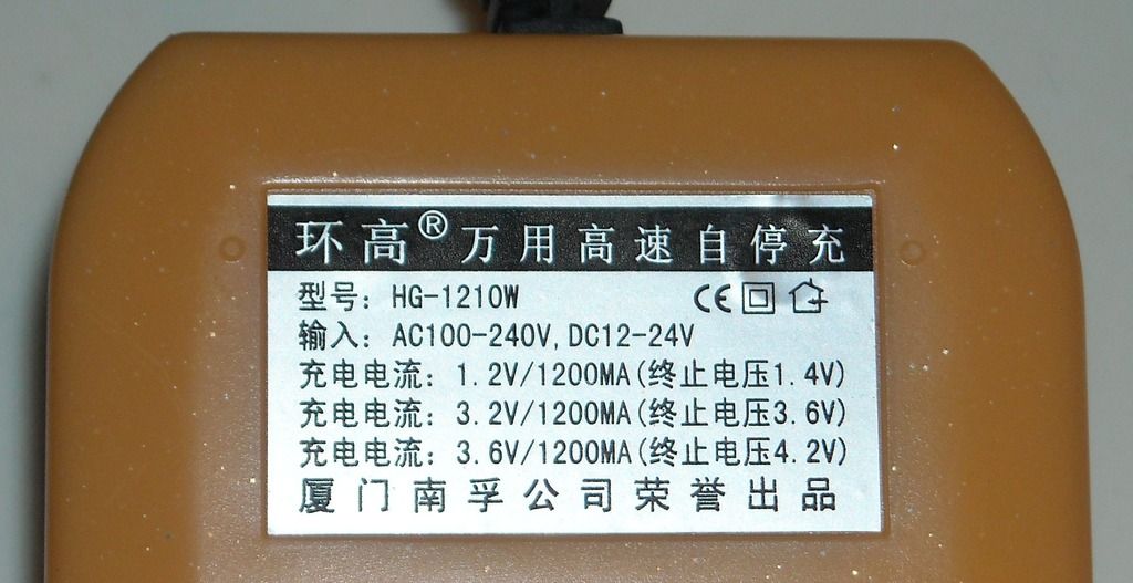

    Here's the rating on my charger:
    So, if the battery specs are
    "Recommended charge current - .9A (.3C)
    Max charging rate - 3.1 Amps (1C)"
    Why is the charger the wrong one?
    .9A < 1.2A < 3.1A

    It's correct one. You've just used "mAh" instead of "mA" previously, so I had to verify.
    Real charge current of that charger is about 400 mA, so it will charge very slowly, and don't terminate when full - so, monitoring the time is recommended. BTW, it's worth to check whether its voltage switch is in correct position, and preferably - measure actual voltage w/o cell.
    Without exact measurements, it's hard to determine the roots of problem, but in general, if I'm faced with some issue in "premium Japanese cells + cheap Chinese charger" system, I'd suspect the latter...

    I hope you have switch in the 4.2V position. Here is brief review of that charger:
    Huangao All in one Charger [ HG-1210W ]

    ok that set up is just scary! knowing what lithium ion cells can do if something goes wrong..... omg.....
    And also unless I missed a detail about the set up, there is nothing protecting the cells from over discharge.
    then reading the info on the charger....EEK over charging is possible!!!! Thats a burnt down house waiting to happen.
