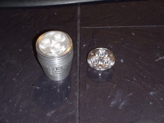

    3,062
    Talcy69
    if you are interested I have just been looking through my parts box and I have a triple Q5 board with 2 triple cute optics a narrow and a medium .
    plus this housing which will take either a buckpuck or Bflex you would have to make an end cap for it but then you dont want it too easy do you .
    it is tapped for a lumicycle mount M5 thread.
    Yours very cheap 25 +pp for the lot
