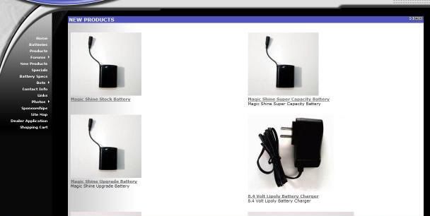

    Ballistic Batteries are making high quality Magic Shine replacements.
    Ballistic specializes in RC batteries and know their stuff.
    They are having a go at the MS issue and have several battery options.

    71
    The biggest problem with the original MS battery was the fact that it was so fragile.
    Of all the dead batteries we've seen, the majority were as a result of them getting wet or being dropped. Its just too easy for the internal pack to fall out of its nylon pouch.
    That shrink plastic on its own just doesn't provide any form of protection.
    It looks like the options from Ballistic still don't address this problem.
    I'm not questioning the quality of their cells or electronics, but I just don't think they'e been designed with MTBing in mind.

    104
    Bradjackson,
    We do address the problem. We glue all the cells together which help prevent vibration and drop problems. We also hand solider and use copper strips to assemble cell together. We also quad shrink wrap the pack.Between all this we have a pretty darn tough pack.

    Quote Originally Posted by rearviewmirror
    $80 for the larger capacity!? Come on, they can do much better than that. Plus the site doesn't list the cell type used or capacity. $80? really?
    It's even worse than you think..
    All three of the battery pack pictures are the same picture.............
    Niterider doesn't give this information either.
    If you are really interested in buying a pack then drop BB an email about cell type and capacity.
    If he tells you it's a corporate secret, then come here with that breaking news, right after Niterider tells you what cells and capacity they use.

    Quote Originally Posted by odtexas
    I've started using LiPo R/C batteries, 5000mAH is $23.. and last plenty long. Haven't over discharged one yet, it burns for way longer than any of my commutes or night rides.
