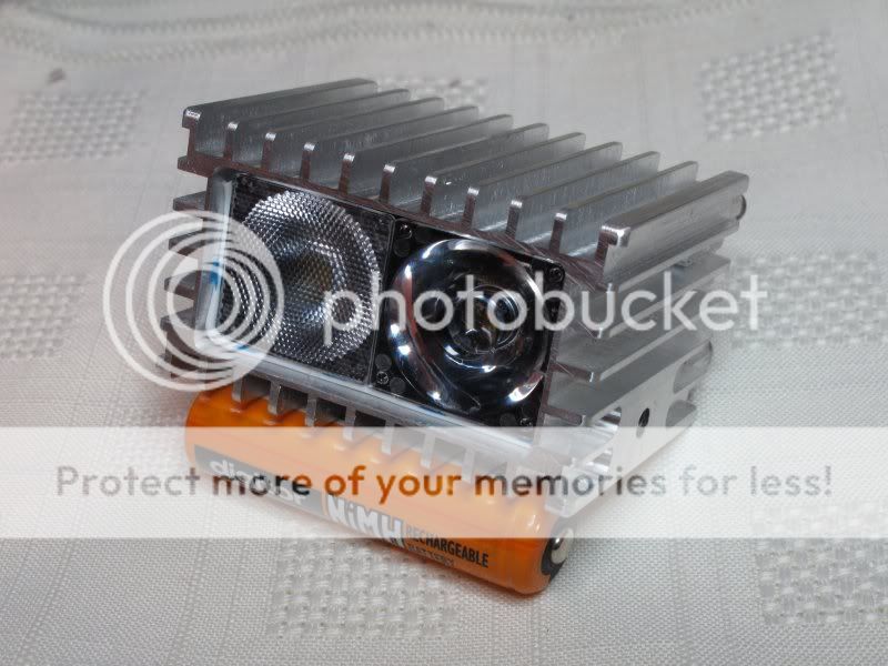

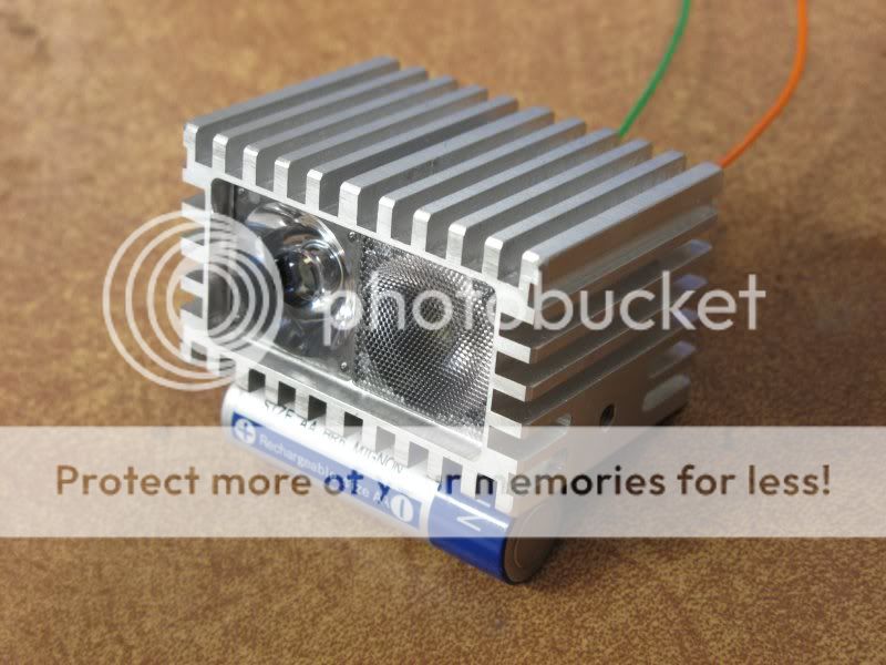

    How thin to make the heat-dissipating fins on our housings?
    To help answer that question, here are two housings, exactly identical except for the thickness of the fins. Here's the original "flatpack" housing, fins approximately 2.4mm thick.
    Back of envelope calculations told me that I should be able to make the fins much thinner without making a hoot of difference to the thermal performance. I hate carrying around extra weight, so re-machined the fins to half of original thickness, now 1.2mm thick.

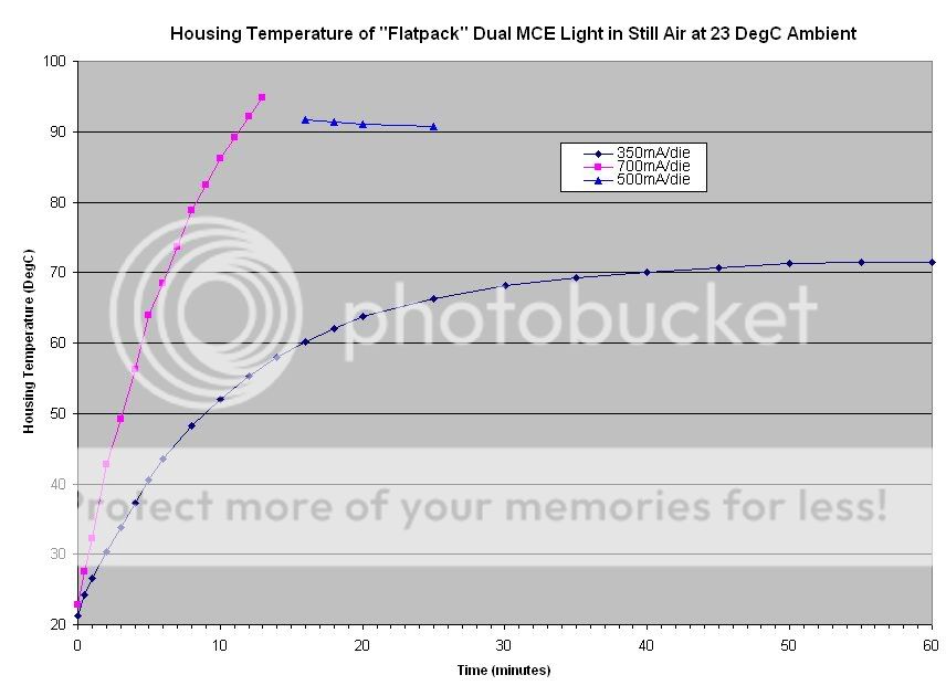

    Here is the thermal performance of both housings, and they are identical within measurment error.
    So the calculations were right and, in fact, I could have made them half as thick again (0.6mm) and still not degraded the thermal performance. I'll post the basic calcs if anyone is interested, but the broad conclusion is that for our physically smallish housings, mechanical issues tend to limit the minimum thickness, rather than issues of being too thin to effectively conduct heat along the length of the fin. For example, if you make the fins much thinner than about 1mm, then they could easily get bent, and be likely to cut you.
    In my case I saved about 20gms by halving the fin thickness from 2.4 to 1.2mm, and if anything would have been easier to make, ripping the metal out from between the fins with a 4mm slot drill rather than a 3mmm one. I'll happily take the saved weight, but another approach would have been to keep the weight the same, and make the fins twice as long and half as thick, or twice as many at half the thickness, or whatever. However you look at it though, my original "thick" 2.4mm thick fins were just plain bad design, a bad use of metal. Bare housing is now around 65gms.

    Here is another experimental result that may be of interest.
    The measurements were taken with the light horizontal, as it would be when mounted on a bike. With this particular housing design, that means the fins were also horizontal.
    I repeated the measurements with the light shining vertically upwards, so that all the fins were vertical, and found the temperature rise was about 15% lower. It is well known that aligning the fins vertically aids heat dissipation is still air, as the natural convection currents occur vertically due to the upwards movement of the heated air. If the light was designed for stationary use, it would therefore be worthwhile machining the fins in a vertical direction. With the fins horizontal as in this design, the cooling will be better (relative to vertical fins) when the bike is moving.

    I presume you mean in still air? Are you saying that in still air, the temperature rise of my "flatpack" light (for example) would be the same, with or without the fins!!?? That seems extremely unlikely, given that the inclusion of the fins more than doubles the surface area, and why do the makers of heatsinks bother to put fins on them? Sorry, I'm not sure if I understand what you are saying here.
    If there was air movement across these particular fins I was saying it would be interesting to see if the thinner fins were more effective at cooling than the thicker fins. Thermal loading and all that stuff.
    I am not claiming that making the fins thinner improves the cooling per se. What I am saying is that you can save weight by making the fins thin, while maintaining essentially the same thermal performance compared to thick fins. Alternatively, you can keep the weight the same, and have more or longer thin fins, resulting in superior thermal performance for the same weight. To directly answer you question, with the bike moving, the temperature rise of my housing would be the same within measurement error with the original thick fins, or the re-machined thin fins. And it would run considerable hotter if the fins were removed altogether.
