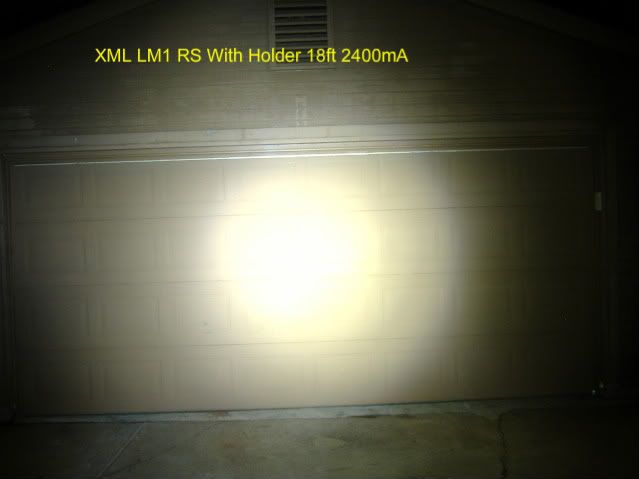

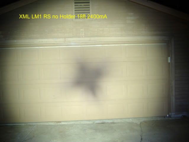

    Beamshots coming up
    Wired up to my test battery and a Hipflex on full 2.8 amps
    all five levels but not knowing what they are below the Max one .
    Starting at the bottom
    with the last pic being my van headlights on High beam
    OK so this is a stupid bright bike light but looking at the lower levels and also for me the colour it is a very usable light .and cant wait for the H6flexs to arrive so I can finish it and give it a ride

    But is it me or is there a tint of green to these xml's?
    3,062
    According to the invoice the XML T6 leds are S1 colour bin
    Not sure Goldigger but I really like the light in the flesh I thought there would be a really bright hot spot but to my eyes it is very good . level 3 and 4 would be my weapons of choice .

    Looks like a very greenish tint to me
    3,062
    Quote Originally Posted by klynk
    Yes could be doesnt look that green in real life to me and as George says there is rather a lot of greenery in those woods .

    Wouldn't xre optics not be as good at collecting light on a xpg/xml since the xre has a much more narrow viewing angle to begin with?
    1,322
    At this point we are all just throwing darts, or maybe its Lumens, at the wall and hoping to hit something.
    View angle
    Optic height over emitter
    Emitter size
    Internal reflection angle of optic
    Not easy to predict the interaction of all this and more. So back to throwing darts.
    Have at and post up.......
    Can you say "artifact"

    Quote Originally Posted by odtexas
    View angle
    Emitter size
    Cheers OD,
    Im surprised at how crap that optic is with the XML.. what the feck is that in the middle?
    Did a Mozzie, fly past when you took the shot?

    I will tell you what that is
    The LM1 is for the MCE get a magnifier and have a good look inside the led cavity you will see 4 curved micro lenses which were to line up with each Die on the MCE
    your seeing that in your beam shot .
    Another one off the list .
    Please no more ugly pics

    Sorry I was getting the lm1 mixed up with the xre lc1

    But this is the beam with the holder.
    I missed centering over the XML by probably .2 mm. Gives that mild peripheral distortion like we got with the Carclo 10mm square optics when the XPE/XPG emitter were slightly decentered on the PCB.
    That looks very useable..you must be getting fed up with the camera by now?
    If not any chance of one of your long range shots to the garden fence of this optic please?
