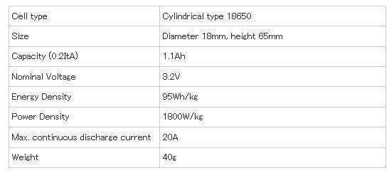

    Quote Originally Posted by sonyinsider
    Sony has announced a new type of lithium ion rechargeable battery that combines high-power and long-life performance, using olivine-type lithium iron phosphate as the cathode material. The Olivine-type lithium iron phosphate used in this new battery is a perfect cathode material due to its robust crystal structure and stable performance, even at high temperatures. These bateries have a high power density of 1800W/kg, and extended life span of approximately 2,000 charge-discharge cycles. What’s most surprising is that the battery will keep an 80% charge retention after those 2,000 charge-discharge cycles, which is very impressive.
    This new battery is also able to charge rapidly (99% in 30 minutes). It will first be supplied for use in power tools, then gradually make its way to consumer electronic electronic devices. With lithium ion secondary batteries able to deliver both compact size and high capacity, their usage continues to diversify and grow. This new battery delivers an extended life-span of over four-times existing rechargeable lithium ion batteries used in conventional electronic devices. By adding this high-power, long-life lithium ion rechargeable battery to its lineup, Sony has certainly strengthened its battery business going forward. Here are some specifications:
    3,330
    1.1Ah looks kinda low and 3.2 rather than 3.7 so not alot of use for us at all really.

    Not to burst your bubble... but LiFePO4 batteries are nothing new. A123 has been making them for power tools for quite some time. They have inferior energy density compared to the more common LiCoO2 based batteries. The only advantage they have is that they are far more resistant to exploding, and they can be very rapidly charged and extremely rapidly discharged in as little as 2 minutes (30C in battery-speak). It's a good match for power tools or radio control models where runtimes of only a few minutes are acceptable, but for bike lights, standard LiCoO2 based batteries are superior.
    typical LiCoO2 18650: 3.6V and 2500mAh
    LiFePO4 18650: 3.2V and 1100mAh
    Do the math and you'll see that these LiFePO4 cells have less than half of the energy (V*maH). However, because they can be discharged at 30C rates, they have much higher power compared to a typical LiCoO2 cell which can only be discharged at 3 to 5C rates.
