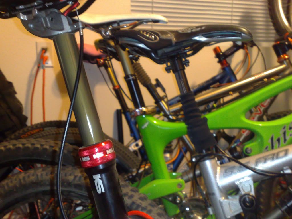

    KS 900 or 950 are great, I've tried a few different ones and I think it depends on what you are looking for. They are all benefit your riding, and they have their pros and cons.
    Right now 2 major categories would be Hydro or mechanical.
    Mechanical are more simple and easier to service.
    Most are 27.2 so it require shim, but it would fit most any bike. I don't know how it effect the seat tube but I heard from KS that some bike companies would void the warranty thru the use of the shim claiming that the shim sleeve may be too short and leave too much post expose inside the seat tube.
    Most offer 3 position drop, they are predetermine height. and while adjusting between travel the saddle wiggle quite a bit, if somehow it does not lock in to place. Remote on the GD and AMP are quite wide and flat creating some space issue that makes placement of the remote difficult.
    They are not as smooth, and if you tighten the seat clamp too tight it does not work properly.
    Seat rail fitting, My GD and AMP comes with the thompson style clamp with 2 bolts, it does not accommodate seat angle like the Monolink design that requires quite an angle, it ended up bending the bolts.
    AMP customer service was out of action for a while but thanks to Derby now they are back online and my post is being cared for. GD customer service is just great, they take the time to answer your questions.
    Hydro, Ala KS 900 series, Maverick Speedball, Crank Bros Joplin 3/4, New Rockshox.
    Smooth operation
    Infinite adjustment between the travel range
    You use it more times than the Mechanical ones, I know because I use more, it's easier to adj it encourage you to use more.
    Overall remote design are better, KS new design remote is awesome it take the place of the ODI lockring that would make for less space used on the bar. Maverick design remote is also slick as you can activate from different angle.
    It does have some drawback, can't speak for the RS yet, but Maverick SB has some saddle play, and swapping between lever to remotes proves very difficult, Cranks brother add 1 more inch but still retain some problems, and QA issues with CB is just almost expected.
    KS has some issue with the seat sticking but other than that the post is solid. Although it's not the easiest one to find a good deal on. The latest version's internal is pretty good it works right out of the box for me. I now own 3 KS and the i7 (27.2 4"drop) is on the way. It's easiest when you get them from an authorized dealer, it's almost full retail but much less problem when it comes to updating your internal. I had the first gen 950 and had some sticking issue, sent it in to KS, Rick took care off it change the internal, and fit me with a nice new remote as well. Can't say enough, they are great.
    There are a lot of problems with these post if you knit-picking them one-by-one, but to be honest even if you combine all of the problems into one post, I'd still take it over the standard post any day, and twice on Sunday.
