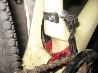

    I use a Blackspire Stinger and have no issues with it at all. I have had to tighten the roller a couple of times as it gets noisy if it loosens.
    I want to say that there may have been a little work needed to get it fitted. I had my local bike shop The Fixfit it and I seem to remember that they had to grind it a little to fit it. However they may have also just said that they might have to grind it and never needed to, I will see if I can see any work they did to mount it.
    As a guide it works great, I would occasionally drop the chain before the guide and since I have never had a chain come off.
