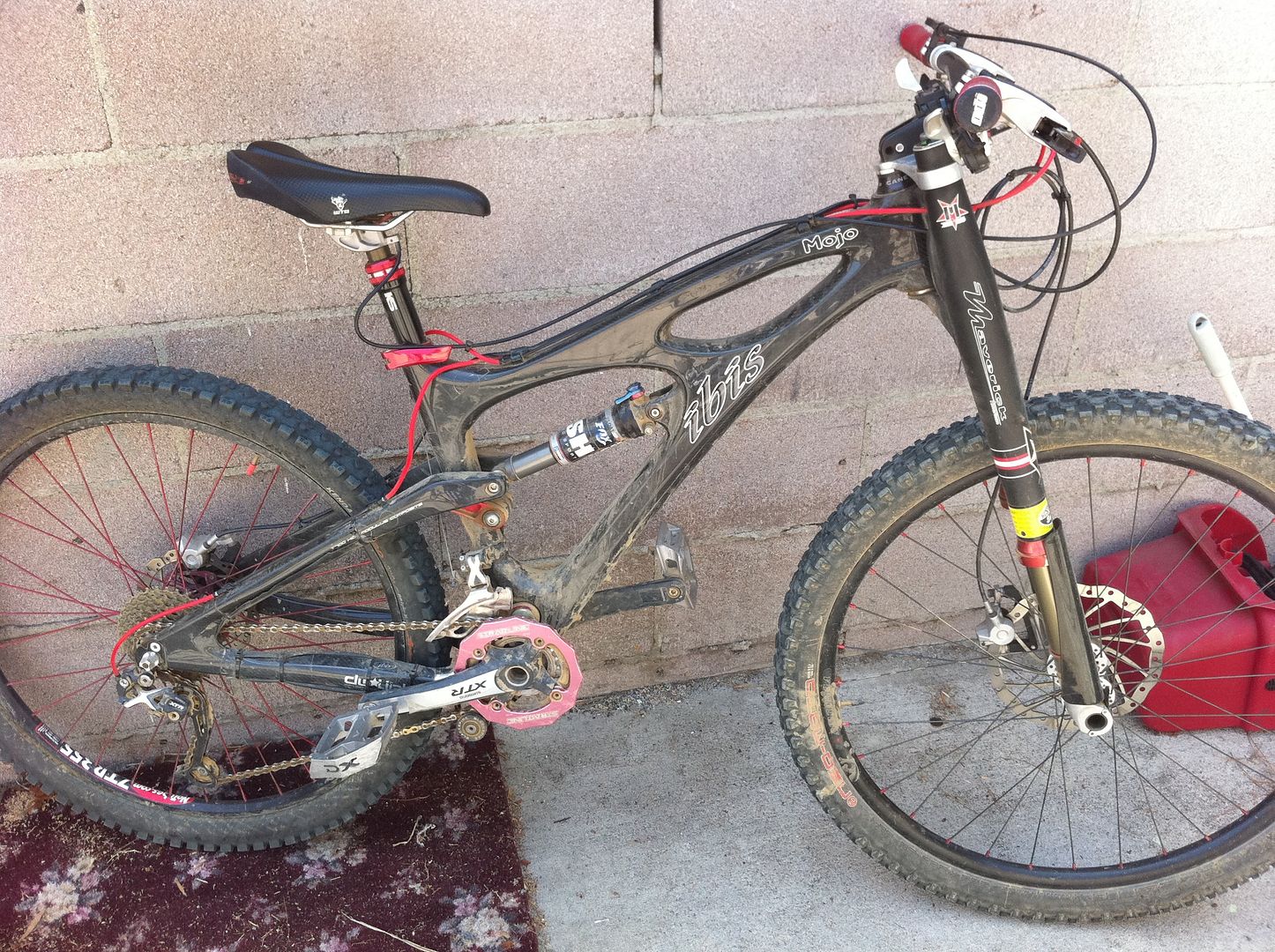

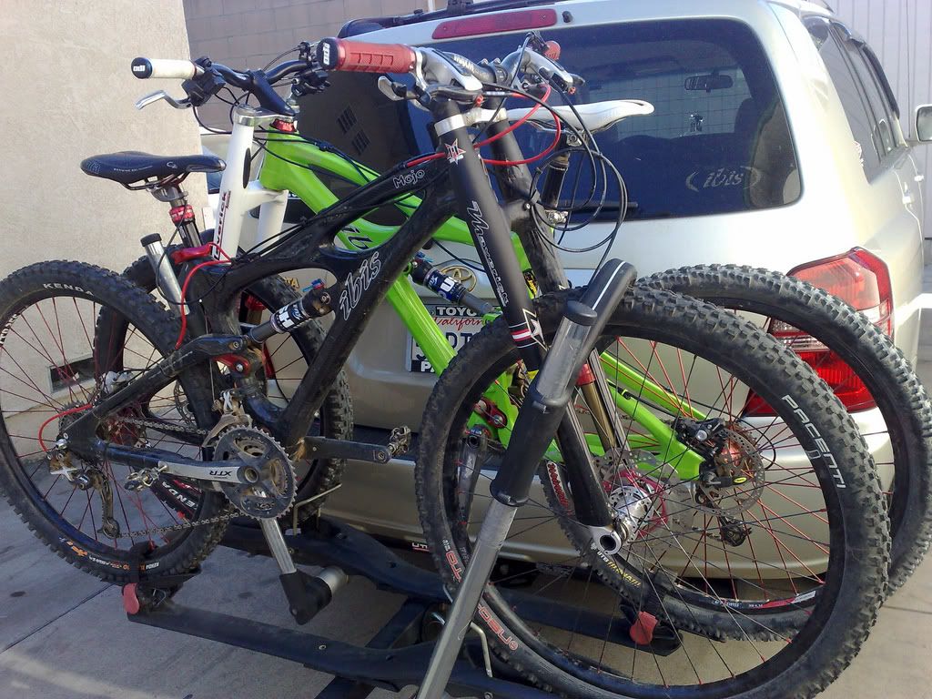

    I've done both and love them both
    1 Ibis Mojo carbon classic with Duc32 26er
    2 Ibis Mojo Duc32 650b front
    3 Mojo with Magura Wotan 160mm 26er
    The lightest set up is obviously the first one but the most fun is a toss up between 2 and 3 as both offer stability and bottomless fun. Although, both run the front a bit higher but it only takes a few rides to get used to it. Both set up didn't bother me on the climb at all. Bigger fork and more travel is fun but you'd pay a bit on the weight.
    If you are a WW, DUC32 is an excellent fork for the Classic. It's a light weight 6" fork that can be easily tune, and converted to just about any wheel size you want. It does required a 24mm hub I9, Kings, Hope, and Maverick makes them.
    If you do get HD you'd have it all, IMO. 140, 160, 650b front or f/r. what a fun bike it would be, I'm waiting for mine.

    Rshalit, first off Mojo still climb well even with slack angle. Steep climb did not present problems for me even some extended climb. When the grade get steep, most bikes front would wander anyways. It may flop a bit but to me it happens to steeper HA Mojo ti, as well as Mojo carbon. I just learn to not let it bother me.
    Even Duc32 on both my Mojo I install a 7mm Ventana race, ti slacken the HA a bit as well. OP, does your 36 has TALAS? It can steepen the HA a bit on long climb. Short tech climb the slack Ha kinda fit my style of riding I can loft the front up and over stuffs.
    On the descend there's just unbelievably stable, the lower bb and slack HA just plain awesome. If you are more XC you may not like it (as much) but since you are considering HD I don't think it would be much to compensate, I'm sure the first descend would be well worth it.
