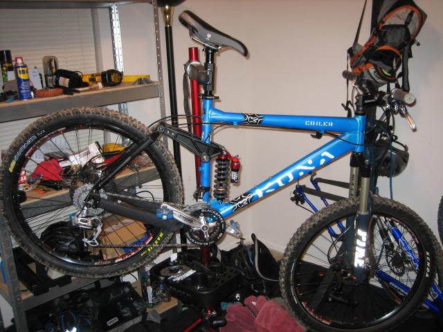

    They look sort of like this:
    34 lbs. soaking wet
    346
    Some stan's will save about 3 lbs. $60
    Lighter cranks. maybe 1lb. $150
    Rear air shock about 1lb. $250
    That is about 37lbs. Mine is a SP180, (works 7) with Stan's, downhill tires and a Boxxer race I am at 41.5lbs. Not too bad. If I were to put My Talus (about -1 in front travel for stock) I would be around 37.5. With cranks and an air shock and lighter tires it would be around 34.5.

    dingleberry:
    34 lbs. soaking wet
    Funny that you post the Coiler - as I would have bought one (an 06) months ago (if I lived anywhere near a place like wheelworld.)
