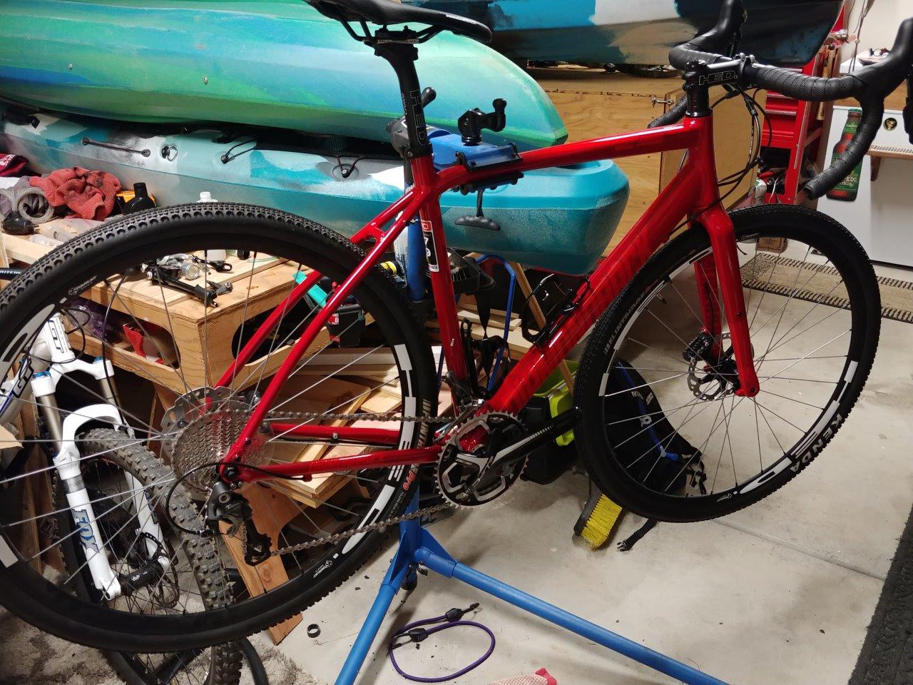

    Super easy build! Bike was delivered yesterday and was able to build it up last night. Only two issues with shipping, and neither of them are of much concern. One was that the plastic cover that fits over the front rotor came off in shipping. The inside of the box showed signs of the rotor rubbing on it, but the rotor looked fine. A quick test ride verified that the rotor wasn't bent, so all was good there. The other issue was the shift lever poked a hole in the box, scratching the bottom of the lever slightly. Again, it works fine and the scratch is about 2mm long...nothing to worry about. DB might want to improve their packaging just a bit, but all in all it's not bad for a trip from China.
    Other than those two issues, I'm really impressed...especially for around $1300! The build was super easy and went together in about 20 minutes, including torquing of the important bits. I set up the tires tubeless and it was a GIANT pain in the a$$. I'm used to MTB UST/TLR wheels and tires that just air up and seal with a floor pump. With the Flintridge tires, even my Bontrager Flash Charger pump couldn't get them to seat. I had to pull the valve cores and hit them with my air compressor. Haven't had to do that since the old ghetto tubeless days!
    I've taken it on a few short rides around the block and again, I'm really impressed at the build quality, included extras, and bang for the buck. Even aired up to 50psi it rolls smooth and silent. The brakes are fantastic...so cool to have the feel of my XT's on a road bike. This frame is a 53cm, and I'm right in between the 50cm and the 53cm (5'8", 31" inseam). While the standover with shoes on is fine, it's definitely getting "cozy" with the top tube. But the reach feels perfect and that's what really matters to me on a bike like this. The saddle is a couple inches above the bar height with the stem in the stock "lower" position. Even with that drop, the riding position feels comfortable in the drops and on the hoods. I may add a QR to the post so it's easy to drop down for the gravel descents. Speaking of the bar, I'm really impressed with the bar wrap. Really comfortable wrap without being too squishy, actual 3M tape, and the hoods are wide and have a good feel to them.
    I'm heading out on a ~30 mile shakedown ride later today and will post back with my impressions of the ride quality. Here's some pictures of the build:

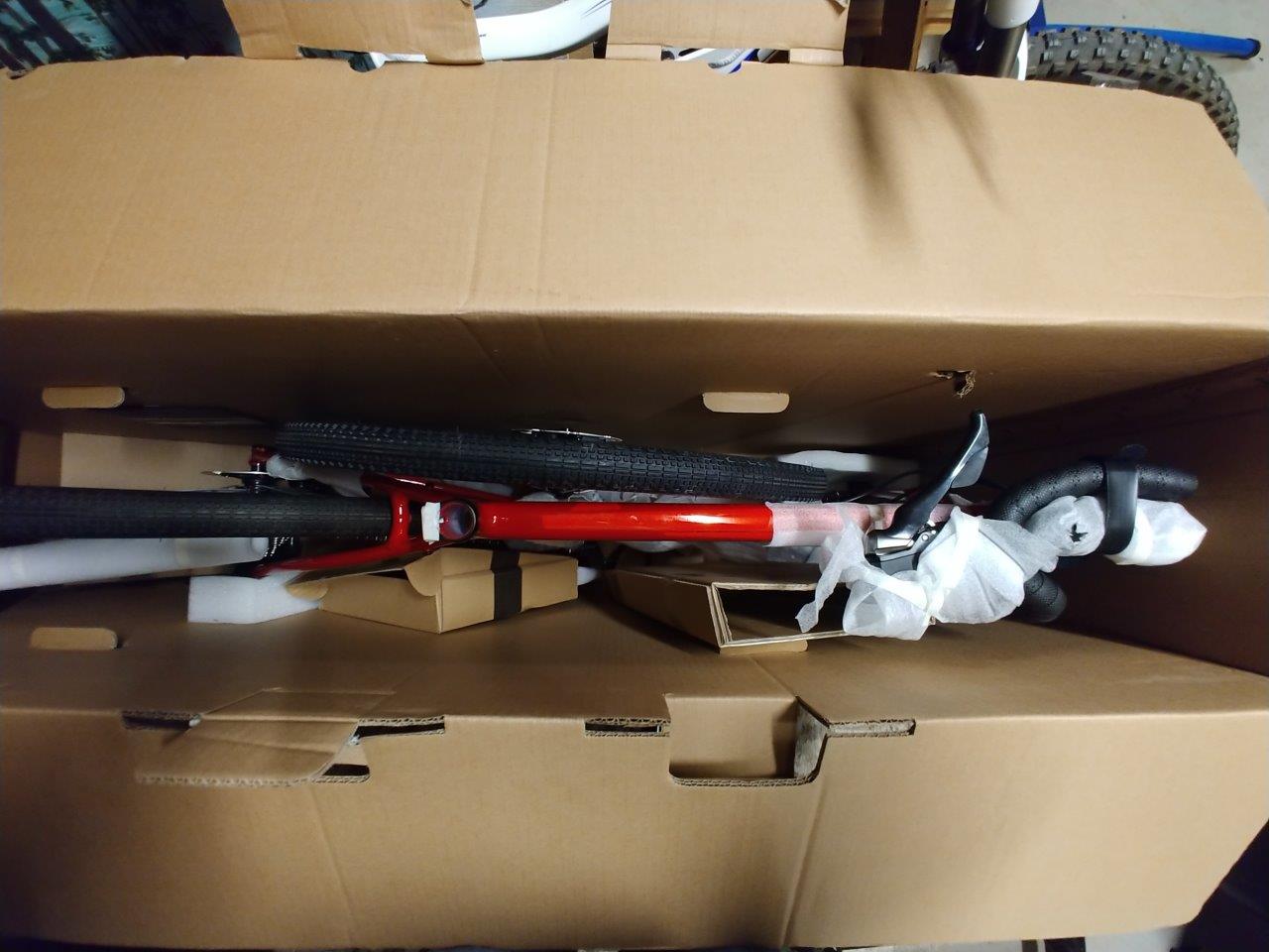

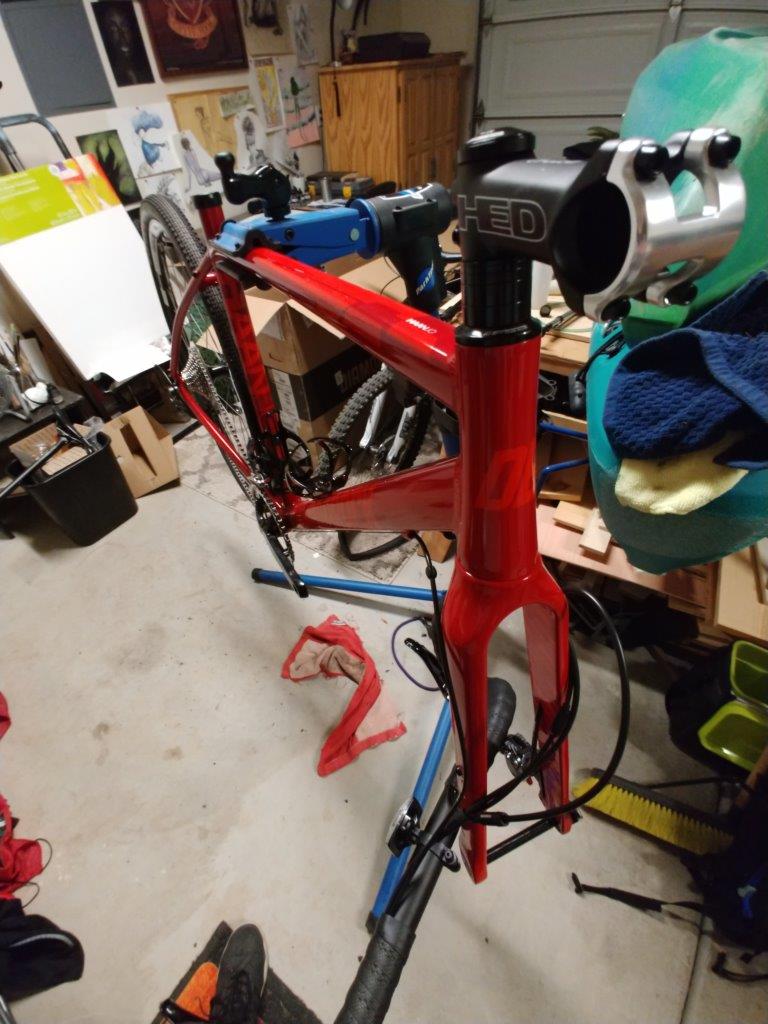

    As shipped. You can see the front wheel rotor is missing the plastic cover. This had fallen off in shipping and was in the bottom of the box. You can also see where the end of a shifter poked through the side of the box.

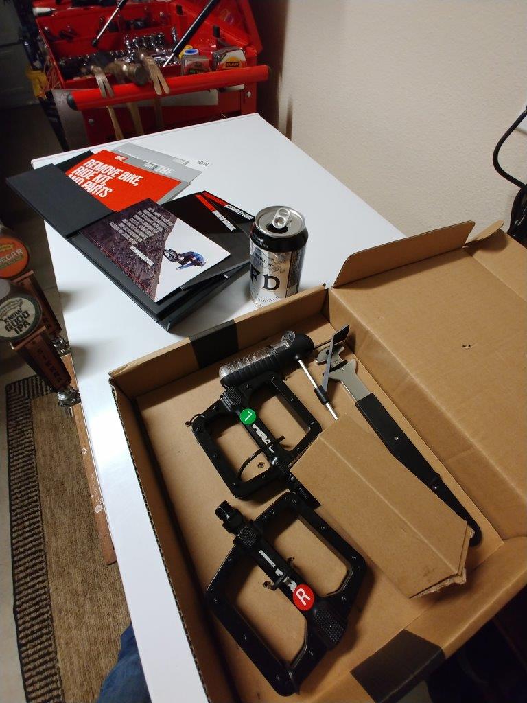

    Very cool that they included tubeless valves, a torque wrench, a pedal wrench, and pedals! The pedals are complete crap, but good for slapping on for a test ride in a shop I suppose. Bike even comes with two water bottle cages.

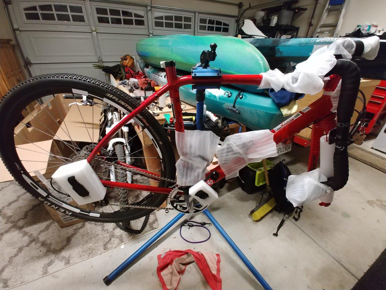

    Aside from the plastic rotor guard falling off, the bike was well protected with foam blocks and wrap.
    Pretty easy assembly: seatpost/seat, handlebars, front wheel, pedals, DONE

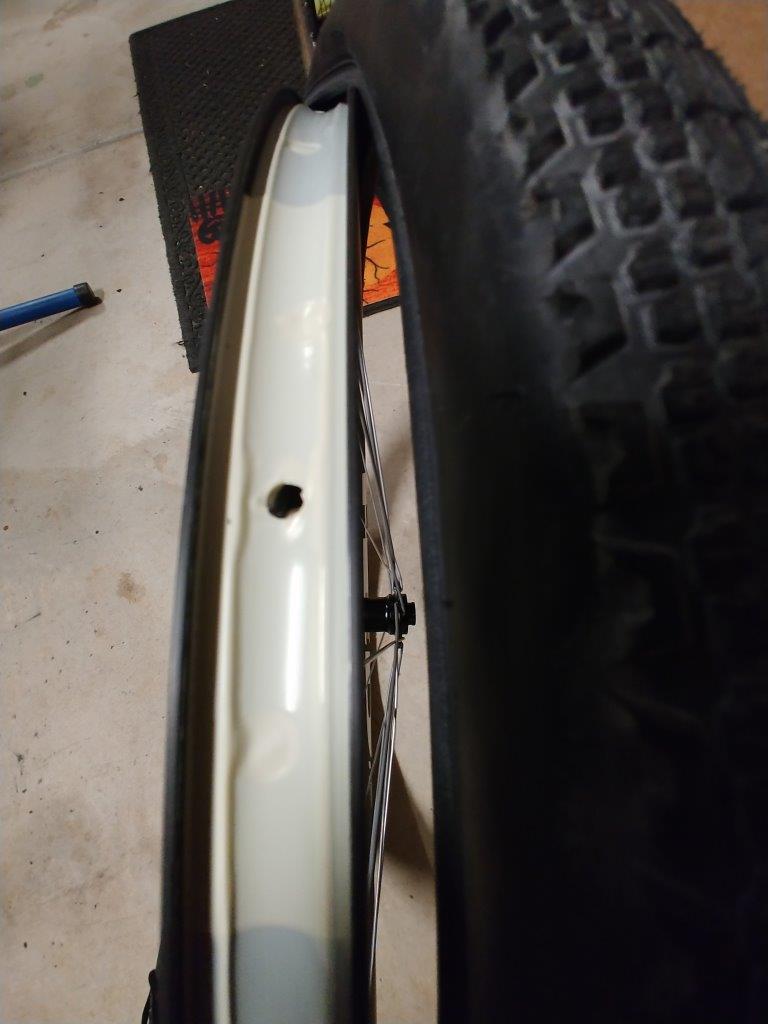

    Not the best rim tape job, but it works and I didn't have to do it!

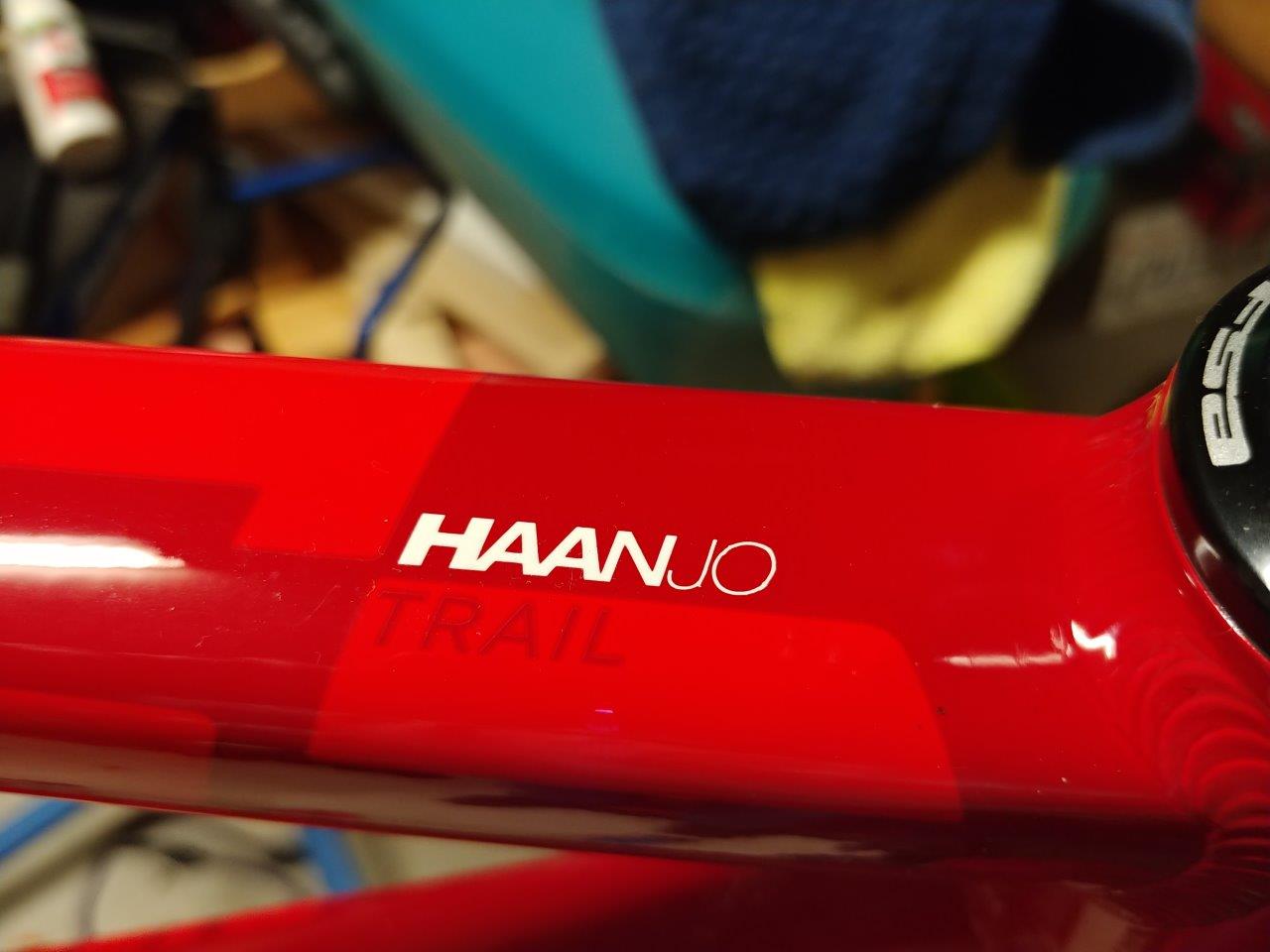

    They straight up stole the early 2000's Ducati font!

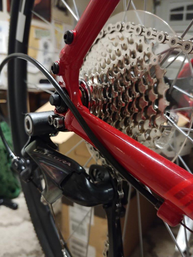

    Ultegra shifts crisp and silent right out of the box.

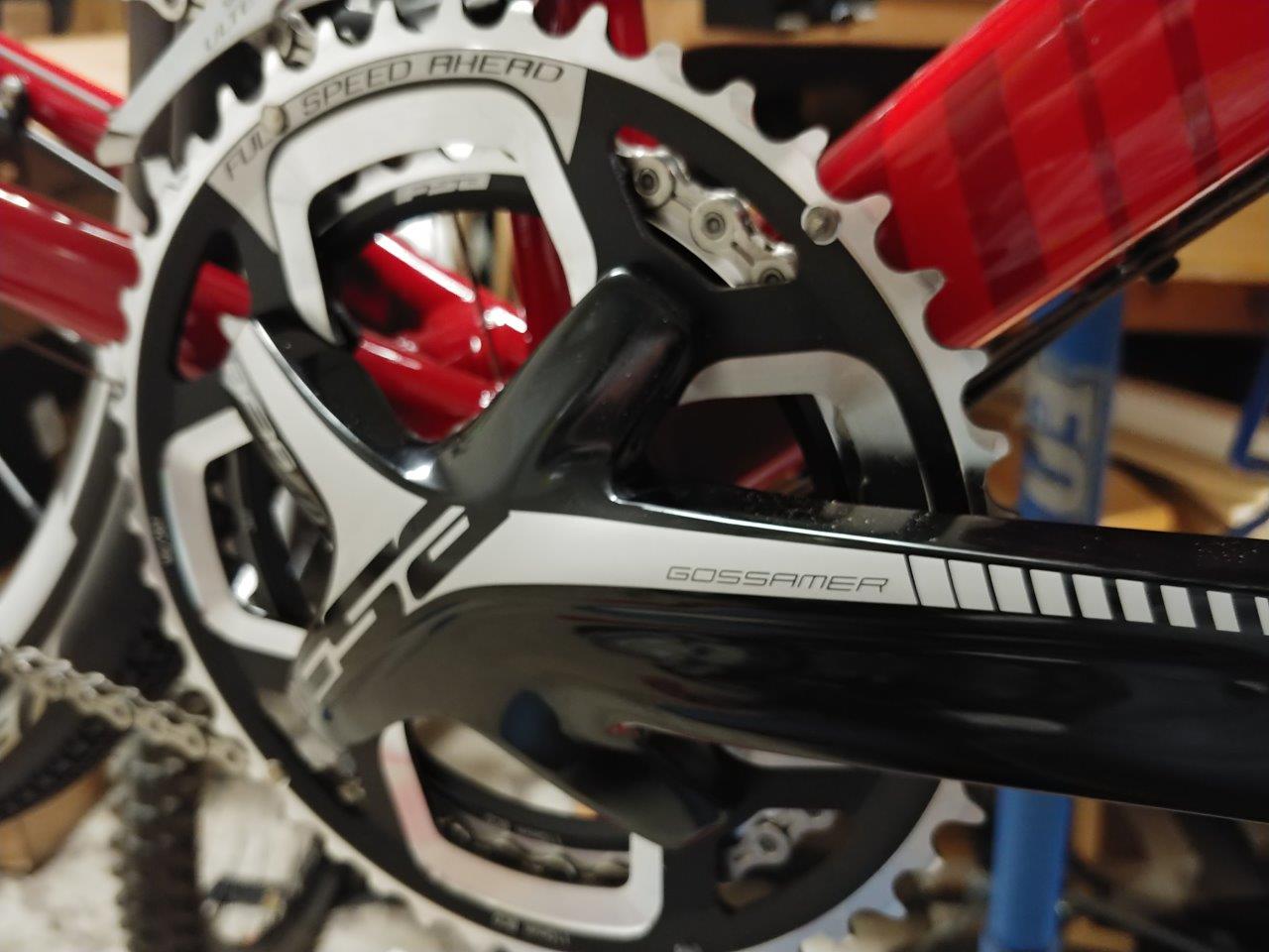

    Cranks look great and were greased properly which was nice to see.
    Everything installed in about 20 minutes (doesn't include tubeless setup).
    Good looking bike! Very happy with the understated branding. That seat is hard as a rock, but the shape and weight of it seems decent. We'll see how it is with the bike shorts on...

    Quote Originally Posted by Guy.Ford View Post
    Just swap the rings, no need for a new crankset.
    Sent from my SM-G935T using Tapatalk

    That looks really nice. Happy (gravel) trails.
