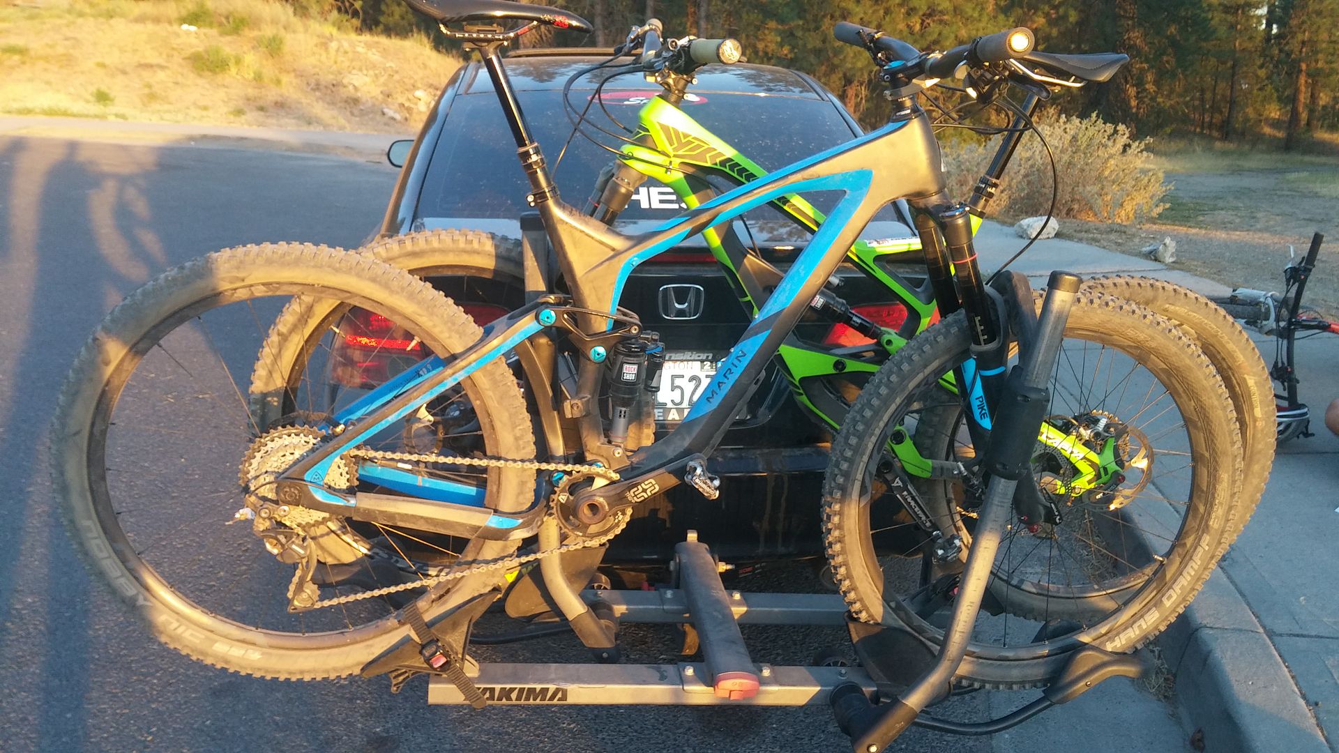

    I've been using the 3m Scotchguard 8 mil for years and just finished practically coating my brand new Karate Monkey frame the other night. It's certainly much easier to do as a bare and new frame. I don't mind cutting the unique shapes at all. It assures good coverage where you really need it. On this latest KM project, I used a new 3m "pro" version which is a self healing variety and is purported to have a better gloss finish.
    Favorite frame clear tape/protection?-20161215_181346.jpg
