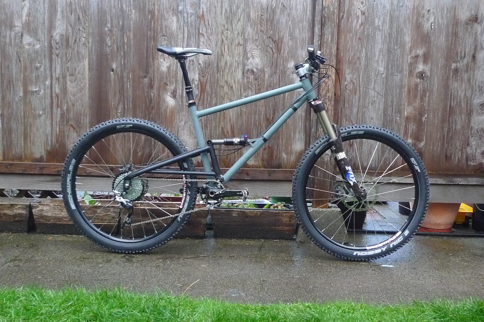

    My buddy adds floating brake and idlers to his 1-pivots to further isolate the suspension from pedaling/braking forces (and cuz he likes to run SS if he wants to).
