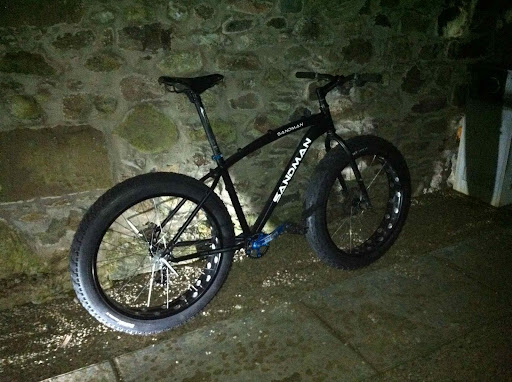

    got a sandman gobi - its about 32lbs ...
    12lbs of that is the wheels!!
    they are arctic cycles 100mm drilled on XT rear and sun ringle 165mm with a larry and endomorph
    bike is stable but i cant help but think A there is alot of weight to be lost in the wheels and B it would be much more versatile with the lighter narrower rim(and gears) - i dont really need the float of a 100mm rim.(or do i and i just dont know it yet ?)
    what wheel set up have you got and what do they weigh and how do they perform on snow and bog? thinking of downsizing to 70 or 80mm rims.

    might just stick gears on first - add weight but improve versatility - till they freeze up ! 1x9 !
    come winter ill probably wish for my 100mm rims back
    lighter tubes could be a winner - have a maxxis freeride 2.5 tube ill stick that in one and get another - should make a bit of difference.
    no rotors or cassette i believe - since they are not in that photo !
    106
    oh one other thing - anyone got a weight for the rims there seems to be very little info on the interweb on them - i aquired them as part of a second hand deal.
    arctic cycles 100mm drilled rims
