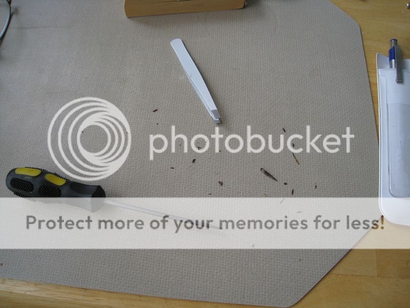

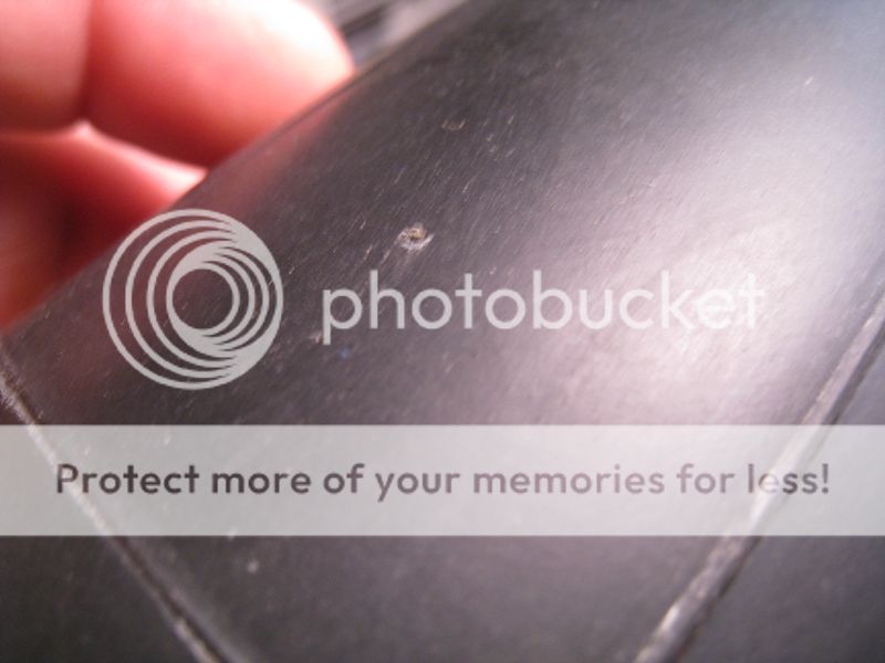

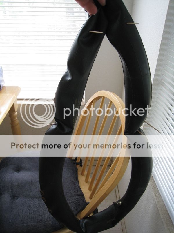

    Ok, here's some data for using latex sealant in an innertube - on a fatbike.
    (The sealant was WSS original recipe)
    Yes, I have been doing this - and with reasonable success. All my rims are old USC 100's that don't have the retainer lip, which is the only reason I haven't gone tubeless long ago.
    So, the day after a ride I came back to a flat front tire {sigh}. At next opportunity, I pulled it apart and put a bit of air in the tube. Not one, not two, but SIX holes. Loverly. The toothpicks are just markers.
    Found these in the tire:
    But later, when I was checking the patches - I found these:
    I hadn't yet pumped the tube up to 4.8" size, so I watched these as I did - and the first one started to leak, but the other two stayed tight. I went ahead and patched all three to be sure, but there were a total of NINE holes in that tube - but I finished my ride, with slow leakage finally taking it's toll. YMMV. Cross posted to a few places.
