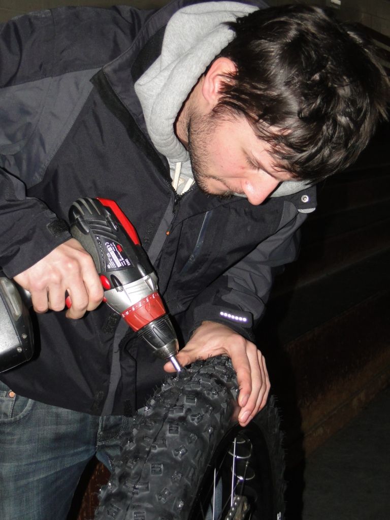

    I needed to type this to get my adrenaline levels down... to work faster & easier I put the studs in with the Nate's on the wheels, with pretty high pressure in the tires to have a firm surface to work on. I obviously tried it first with a wooden block and the tire off the rim, to make sure the studs wouldn't protude on the inside.
    It didn't (just), so I went ahead by drilling the studs on the inflated tires.
    You probably guess what happened... I perforated one of the tubes... What really got to me was that it happened while putting in the very, very last stud: stud nr 190
    I took some pictures of the bumps the undersides of the studs make on the inside of the tire. Only time will tell if they eventually work their way through the carcass or not.

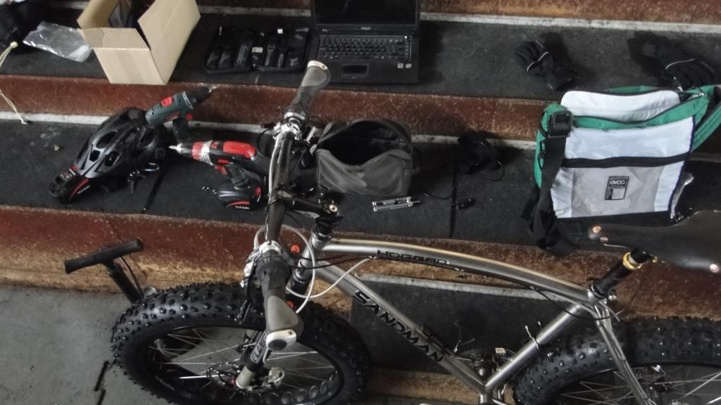

    Ok, here goes: I heeded my own advice and made myself comfortable . Here you see a stud and the drill tool, with a "comfortable" background.The tool is still non-magnetic, the trick with the magnet didn't work... I admittedly tried it only with a not-so-very-strong magnet.
    Here is the inside of the tire, you can perfectly see where each stud sits. Time will tell if they stay like that or they'll work their way through and into the tube. I plan on putting a few screws into a Nate for normal offroad use and run it for a few 100 k's to see what happens.

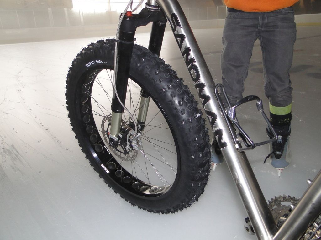

    Here is the pre-prepared tire, fitted with 95 studs, 5 rows of 19 studs each. For starters, as you can see the studs are few and far between. We planned to start out with these and add as needed. Already sitting on a sheet of thick ice. Now some might wonder where I found such nice ice in Belgium, when winter hasn't even set in yet...
    Tadaaaa.....

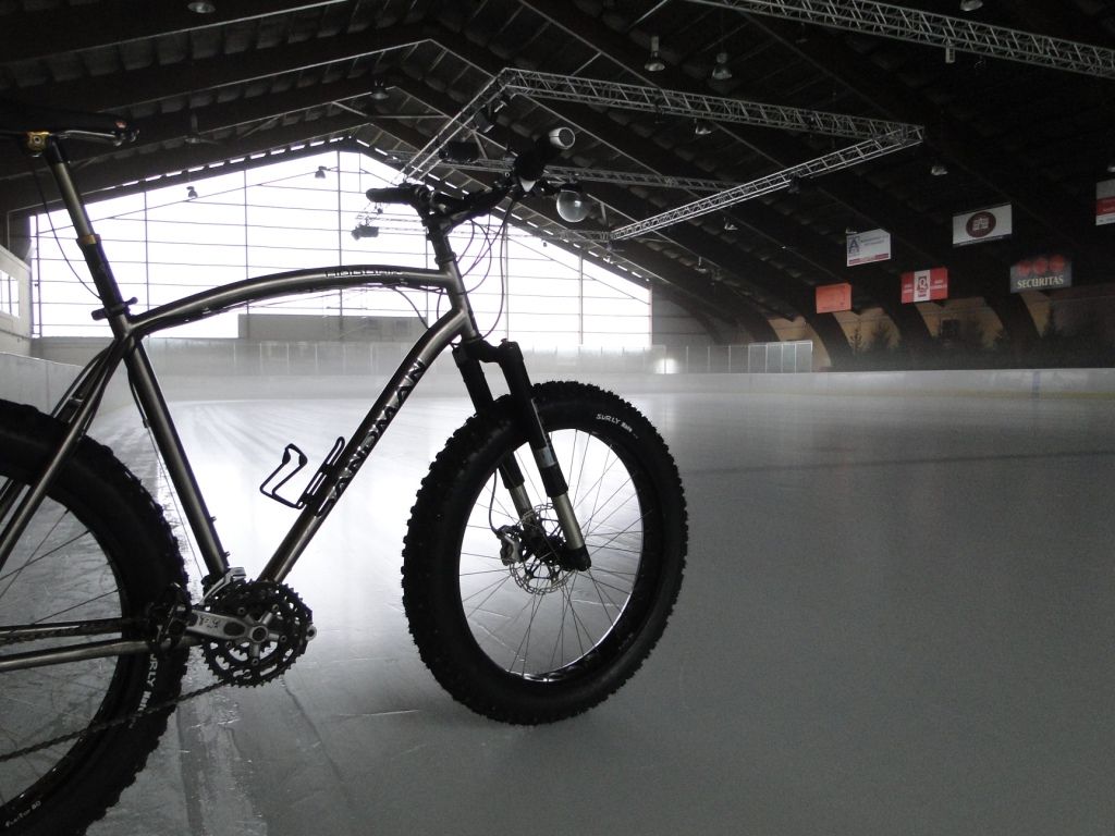

    We soon decided that we needed a bit more grip, it wasn't too bad with the 90 studs per tire but we felt we could improve things by adding more studs on the side knobs. We only had the skate rink for ourselves during a limited amount of time, Rob from Swooth bike shop and I took a drill each to add studs on both ends of the bike.
    We added 19 to each side (of the tires), 38 extra per wheel.
    Much improved traction and control in the turns. You could comfortably keep pedalling in the turns and on the straights it was hard to spin the tire while sitting in the saddle and putting power to the pedals. You could power up quite a slope this way.
    The first skaters appeared, meaning our time was nearly up...
    A leisurely time at the local skate park, with the typical gear sorted out...

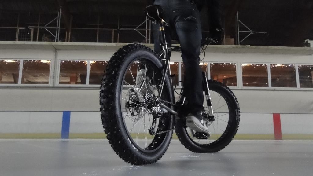

    Here is the pattern that we ended up with. We're pretty confident that for the use these tires are going to get (lots of natural ice and icy snow), it's a pretty good setup. On the sheer, just "ironed" ice of the rink you couldn't do any fancy or agressive moves. But the bike went where you pointed it, you could pedal and brake. What more does an ice-biker want ?
    The only problem was when stopping and putting your feet down, it was only then that you realised how slippery a "fresh" ice rink is...
    With these studs and I suppose with other kinds as well, the more you add, the more traction and control you'll end up with. For an ice race, you'd have to stud each and every one of the knobs.
    This setup uses a total of 266 studs on one bike. We choose a Nate in order to have adequate grip over a wide range of winter terrain.
    The knobs of the Nate are slit on top, to make them more supple. But that makes for a less-than-ideal platform for studs: they're sitting a tad more recessed than the manufacterer had in mind.
