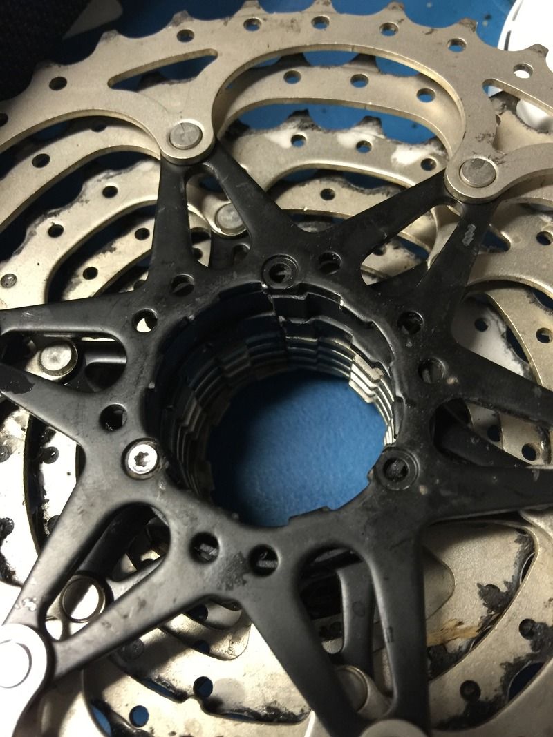

    On my Sunday morning ride yesterday I ended up folding the 2nd and 3rd gear chain rings over. We were on a technical rolling section of trail and the rider directly in front of me slipped and stop as we were navigating a sharp, root covered turn starting a short steep climb. I was in the middle of a shift when he stopped and caused me to stall and when I cranked on the pedals to get around him the chain must have been in the middle of shifting. It folded the 2nd and 3rd gear chain rings right over. I was able to get them somewhat straightened out but the chain still jumps in those two rings. I need to replace the cassette and figure before I just buy the replacement I better check and see if I should buy something a little better.
    I know very little about cassette options so I'm looking for suggestions if I should just replace the stock one or if it's a good idea to upgrade to something slightly better?

    Of course that all changed when I went to remove the cassette today and it wouldn't come off without a bunch of effort. Here's what I found:
    Then while inspecting the cassette I discovered that two of the 3 bolts attaching part of the back of the cassette were snapped off:

    2,516
    You have that much free hub damage after 100 miles?! Geez!
    For the record, are you a heavier/aggressive rider?

    I'm not sure how to describe my riding but I'll give it a shot. I ride a mix of rolling single track, technical rock gardens and short steep climbs. I'm not a strong rider on the pedals though. More of a slow grinder than a guy that stands up and hammers. 99% of pedaling is all done in the saddle. I ride once or twice a week for usually a total of about 20 - 25 miles. In winter gear trim, which has been most of the 100 miles of riding, I'm probably 185-190

    Just talked to the LBS. They told me the free hub wear is NORMAL, they all get that way.

    Not all. A lot has to do with how much you mash the pedals and if it's an aluminum hub. If it's aluminum, much higher chance of doing this, even with good cassettes with solid carriers. Mine are all steel, and they still show signs of wear. After 2 years though, it's not this bad.

    I really don't mash the pedals. I'm 50 years old and ride once or maybe twice a week and probably only average 15 - 20 miles per week. So I'm not in good enough shape to mash the pedals. lol
    If this thing looks this bad with around 100 miles on it what's it going to look like in 300 miles??
    I have a Specialized Carbon Stump Jumper that I've ridden the past 3 years. Same trails and same conditions I'm riding this bike on. That bike has crossmax wheels on and the free hub requires maintenance at least twice a year. That cassette slides right off the free hub with no evidence of wear what so ever.

    The material used for the freehub body makes a huge difference. Many companies use aluminum to save weight. Aluminum splines (at least the Shimano/SRAM spline) will wear much more quickly than a steel or titanium body. If your freehub body is aluminum make sure that the cassette has very wide shoulders or it will wear quickly.
    I've used narrow rear cogs on the back of my single speed with an aluminum body. The cogs dug deep into the splines in just a few rides. Since then I've used cogs with much wider bases to save the freehub body.

    If weight's not a big issue, maybe work checking with the LBS if you can get a steel hub. shouldn't be an issue if you go XT cassette though.

    The cheap, unclustered cassettes will dig into the cassette, it's normal. Once you have the old cassette off, file down the hih spots and mount the XT cassette. You won't see the same problem, except for the 13t, 15t cog, and even at that it may not be an issue. The big cogs are all mounted to a big aluminum spider that spreads the load.
    You can stress and fuss for a steel freehub, it may or may not exist for that hub. I'll tell you this, an aluminum freehub is safe using an XT or XTR cassette.

    Cassette digging into fh is nothing new, and bike companies don't really care that it happens. They pass the additional costs and headaches onto the customers.
    Buy a cassette from chain reaction cycles for supper cheap, and be done with it.

    I have an XT cassette that I'll be putting on today. I have the LBS checking on a steel free hub option but after reading these two posts I may just slap the XT cassette on and let it go. The LBS filed down the free and installed the old cassette. Not sure why they put the old cassette on since it's junk. I straightened it the I could but it's still has an obvious wave in both the 2nd and 3rd gear rings.
    5,360
    XT cassette will still dig in a little on the highest (smallest) gears, but your 6 lowest gears are all on carriers...so ZERO worries.

    The stock cassette dug in the entire hub. XT is on so I'll see how that goes.

    I've got a few rides on my new cassette and it's working perfectly. Looking at the contact points where it meets the splined hub the XT cassette appears to have more contact are.
    Dec 2014
    1,891
    After looking at the 2 spiders for the 6 lowest gears I can see why.
    Mar 2011
    125
    I had read before I bought the bike that the stock Sunrace cassette was junk based on it's poor shifting qualities. I really didn't have much issue with that until it folded the gears over on a shift. Fortunate for that I guess so I discovered what it was doing to my free hub.
    Dec 2014
    1,891
    Quote Originally Posted by 03'Darin View Post
    Yeah I read the same thing and can attest from my own experience that it shifts like crap. My $500 Trek 3 series bike shifts better.
    Knowing that each cog is individually loading the hub instead of being spread out like the XT I can see why there are some hub issues.
    Mar 2011
    125
    Quote Originally Posted by prj71 View Post
    I had actually read so many comments like yours before I bought the bike that I priced a new cassette before I bought the bike and figured it was going to be an upgrade right after I got my bike. I decided to give the stock cassette a chance first and it worked ok. One of the other guys that rides in our group has the same bike and he *****es about the shifting pretty regularly. He's changing everything out to Shimano stuff
