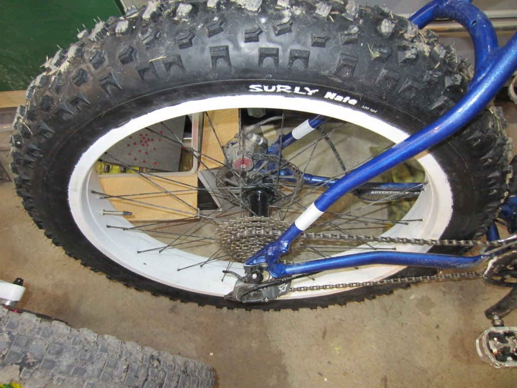

    I have seen guys doing this with their car rims and figured why not give it a go. The hardest part was masking off the spokes. But for $20 and a few hours I think they turned out pretty good. No need to sand the rims and of you don't like it you just peel it off. I haven't gone for a ride yet so I'm not sure how well they hold up, but since some guys say they 4x4 with them on their truck rims and power wash them and it seems to hold up fine.

    Dad gum! Someone beat me to it! I was thinking about doing the same thing! How did you mask off the spokes? That turned out awesome by the way! Nice job!

    My concern would be whether or not the plastidip restricts the nipples if you need to true the wheel. Do they turn free or are the gummed up with the stuff?

    I just wrap a some painters tape around the nipples and then folded a strip arournd the spokes. On the frist one I didn't mask the hub and with got oversprayed pretty good. It was more of a pain taking it off. With this stuff you have to do a couple light coats to build up a base and then you can put it on pretty heavy.
    The nipples don't have any on them and they turn fine.

    Looks cool, but how much weight do you suppose it added to your wheels?

    Once it drys I'm guessing not very much. On a bike like this it wouldn't even matter

    Update: after a couple rides and some mud, dirt, rocks and snow it still looks good. the only issue is I didn't put enough on the lips of the rims and the tire rubbing on it has worn it of and it is starting to peel but that is my fault and not the product.

    after a hard summer of lots of mud, rocks and more rocks there are some nicks. It is also peeling a bit from the tire rubbing on the rim edge, but I didn't put enough on the edge. so i think if a guy was to do it again I would put on a couple more coats than I did. I think I did 3 but 5 would be better. All in all I am pretty happy with it.
