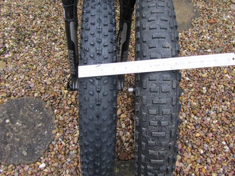

    Here is a pic compared to a Floater
    Good fast rolling tyres on all the terrain I have tried them on

    Fitted on a 40mm rim. Diameter is 720mm. They fit in a standard Surly 1x1 fork, so no need for a fat fork.
    There is a remote possibility it may fit in the back of a 1x1 if a narrower rim was used. When I get my hands on a narrow 26" wheel, I'll try putting it in.
