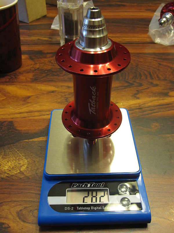

    what do the Fatback Hadley-made hubs weigh?

    As I recall, the Hadley hubs are right around 500 grams as well. Someone please correct me if I'm wrong about that.
    How much does it weigh?

    The Hadley made Fatback hubs weigh in at 435g last time I checked. Our new imported hubs are 430g. I tried to get the steel inserts on the freehub bodies this year, but they are protected.
    I have not had the best of luck with either of the extra light hubs mentioned, and would not want them on my bike if I were out in the middle of nowhere.
