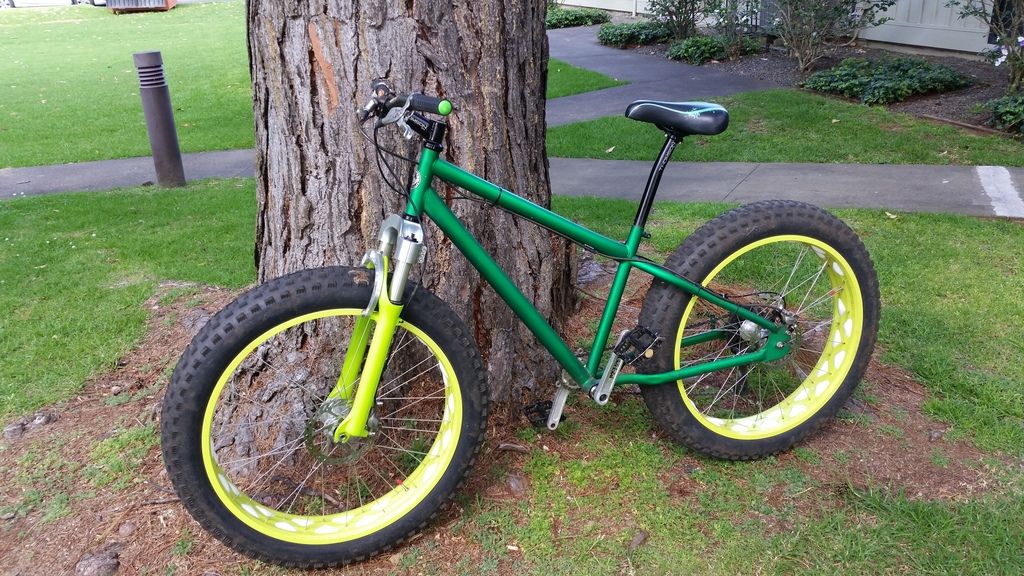

    How the rear brake mounted up.
    Couldn't have been easier

  8. #108
    Dec 2012
    144
    8pm this evening I see this in the window of a bike shop in Kalamazoo, Mich.
    If they would have had something like this in Hawaii, I would have bought one instead of going through all this...

    Loved the build thread! Read through the chopper thread too. Beautiful work! I'm currently doing a build combining a Yamaha CT1 with a KLR 650 and making it a Scrambler. It won't be anywhere near as beautiful as what you did, but I know a bit about how fun it is to watch something like that come to life.
    I think something that so many people forget is that doing something like this isn't about saving money but about making your own creation. The time spent on it is time spent having fun, not "work."
  16. #116
    Dec 2012
    144
    ^^ you got it brah! I'm not trying to build something better - just trying to get my knees in the breeze and have fun doing it. It's always been important to me to have something unique.

    What is the final weight of your Beast?
  19. #119
    Dec 2012
    144
    Weight as shown in latest pics posted is 36.2lbs.

    I'm a machinist, it's what I do. So that part is no big deal to me. This project wouldn't have been possible without gmats patience in answering my questions and his generous 'donations' in the form of old parts. I needed expertise in part selection and knowledge in what was available and what might work the best/easiest. Gmats is a monster on the trails and in his knowledge!!

    I have been beating this bike to death!!
    Only problem I'm having is the rear axle is moving around in the horizontal dropouts... New frame design will fix that.

    Got an hour in both wheels cutting the triangular holes, an hour turning both axles, a coupe hours widening both hubs, the parts an labor to lace and true both rims was bartered for a baby crib, the brakes, cassette and race face crank was graciously donated by gmats. The steering stem, carbon bars and new rotors were a $75 Craigslist purchase. The tubes, rim strips, seat post and brake pads and pedals were a $175 deal at the LBS (Mountain Road Cycles). The hubs were donated by MRC. The tires were purchased from On One for $180. The derailleur and shifter cost $30 off ebay. The bike was $200 shipped. In my opinion, it was a huge success.

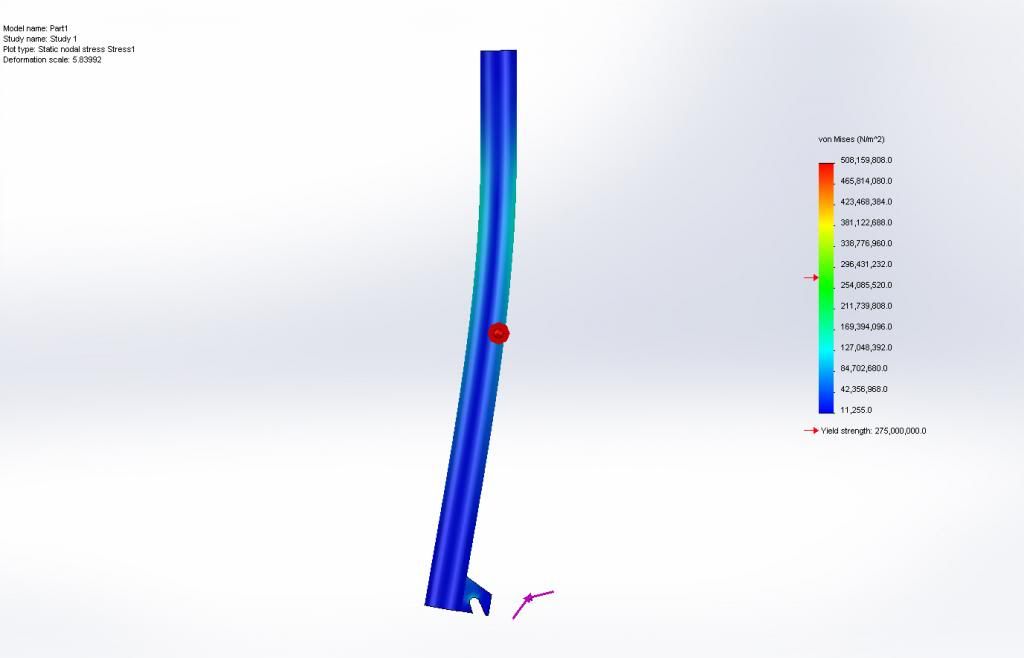

    Ok, should be able to find some time in the next week or so to machine out some fork legs...
    Here is 700 lbs force applied to the stock Girvin fork legs... Very near failure.
    Here is my design with 1200 lbs. Room to spare and only 70 grams heavier despite being just over 3 inches longer.

    ....(the stock Girvin fork legs are right at 300g)

    ...Here is my design with 1200 lbs. Room to spare and only 70 grams heavier despite being just over 3 inches longer.
    Looking forward to seeing this

    Are you using 6061? 1x2 and then milled out?
  55. #155
    Dec 2012
    144
    6061 .5x3 milled out

    New direction with the budget fork project.
  63. #163
    Dec 2012

  67. #167
    Reputation: blown240's Avatar
    1,025
    Nice work on the fork. Are you widening a 29er fork? Is it relatively light weight? There are fat forks for about $120 on aliexpress.com.
  68. #168
    Dec 2012
    144
    Yes it's quite light. I would have preferred larger tubes than the 32mm, but we'll see. Air adjustable, oil dampened with rebound adjustment and lockout with 80mm of travel.
  69. #169
    Dec 2012
    144
    I'll have about $150 in this when done.
  70. #170
    1,025
    Very cool. I got one of the aliexpress forks. It's a hefty 6.8 lbs. 120mm travel.

    Solidworks model
  72. #172

    Nov 2014
    732
    That's a fancy lookin' horseshoe. Seems like the crown will be much harder. I'm looking forward to seeing it. There's two other threads buried in here with the same type of modification executed quite differently. One had a titanium crown...gorgeous.
