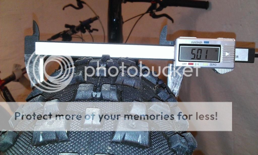

    Vee Snowshoe XL Superlight prototype (1340g) on our 103mm rims. At 30psi tubeless. ( 4.75'' at 4psi vs. 4.58'' for Lou at the same pressure):
    They are 260mm bead to bead like Bud/Lou. Actually measured Schwalbe Jumbo Jim 4.8 to approx 264mm bead to bead, they came in at 4.85'' at 30psi and 4.65'' at 4psi (with tubes)
    The reason no one has gone bigger yet is that production variances on frames, rims, tires, etc will mean that some bikes will have chain rub in the lowest gear even with a 190mm rear spacing and proper chainline for the crank. 190mm really isn't quite wide enough, should have been bumped to 200mm, but then Q-factor becomes a major issue.
    We shelved the plans for a 110mm rim that we were planning with a major rim manufacturer for the above reason.

    Quote Originally Posted by Espen W View Post
    Reading between the lines, the casing isn't bigger, it's just thinner and by running it tubeless at high pressures you're stretching it heaps. Yeah?
    Going to 200 won't change q-factor, it'll merely bring the chainline with current cranks closer to where it should have been to begin with.

    Quote Originally Posted by mikesee View Post
    Absolutely right about the q-factor. I wasn't thinking there.
    Tire stretch:
    The XL stays fairly constant with 4.75'' at 4psi and 5.01'' at 30psi, vs the Lou with 4.58'' at 4psi and 4.98'' at 30psi.
    Lou has slacker beads, so they tend to migrate further up on the rimwalls, expanding casing width at high pressures.
