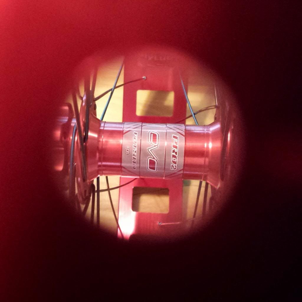

    Hassan's Ghost
    288
    My hub has no markings (FDS or RDS) BUT... the inner tube has an ID of about 15.5mm. Anyone think I can get away with just HU2123? Fingers crossed.
    Feb 2013
    75
    just try it
