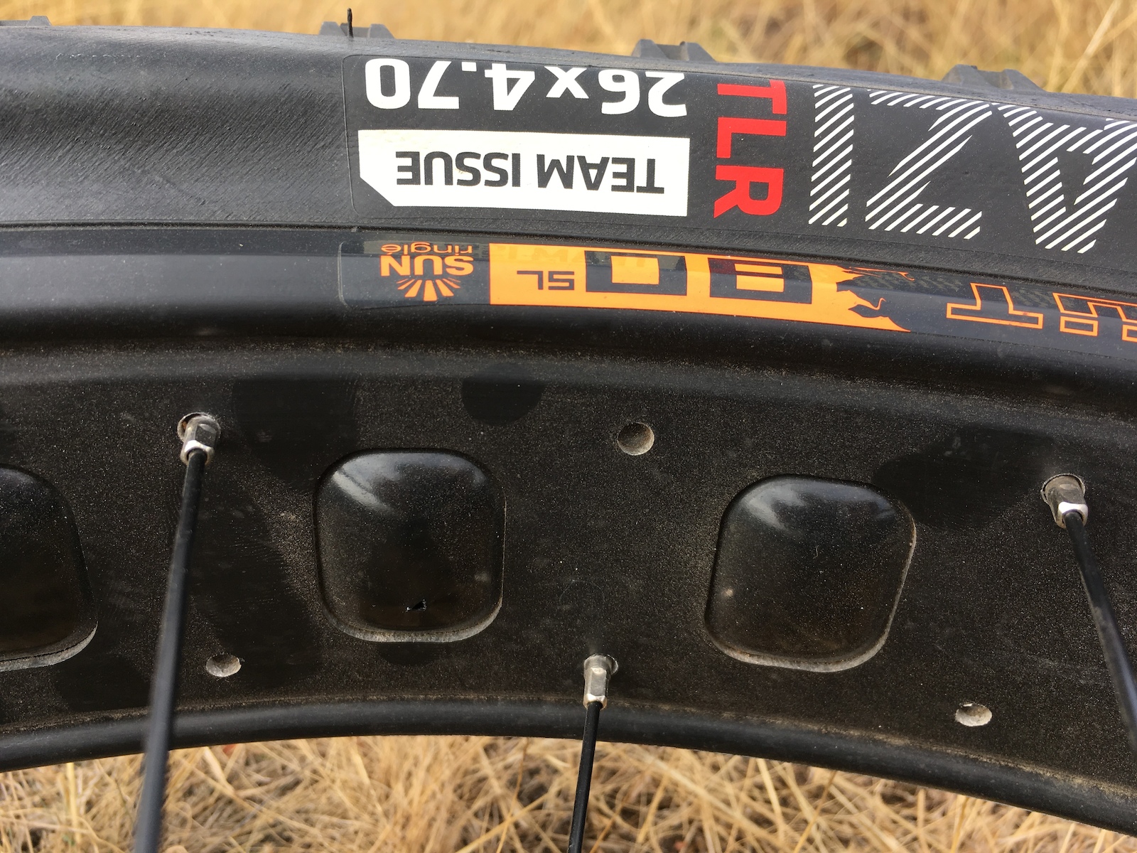

    This thorn was in there for at least 2 months. I didn't find it until I changed my tires for the Summer. It was really hard to extract, even with pliers. I don't know what I would have done if I'd had to put in a tube. But it most likely came from an off-trail excursion - one of those days where everything is frozen and just begging for fatbike tracks (not a crust day, though).

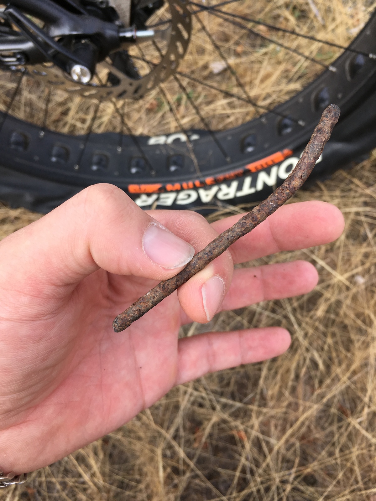

    No tubeless for me. This metal pin poked trough the rim tape. That would have sucked.
