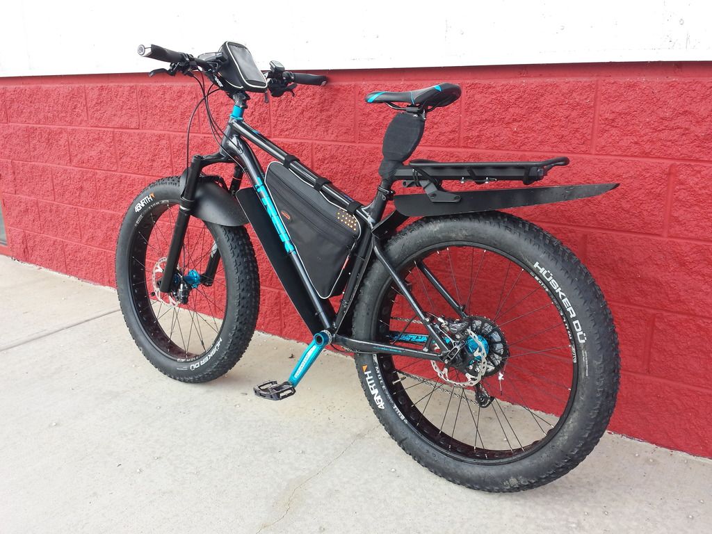

    I just cut up some plastic trash cans from Wallyworld, drilled a few holes and used zip ties. Maybe not aesthetically pleasing, but quite functional.
    The rear fender is a Dave's mud shovel.

    Sep 2014
    985
    A closer view. I used some 3M clear frame protector tape where the zip ties go around and where the fenders could rub.

    Absolutely.

    Sep 2014
    985

    Sep 2014

    Its not that I mind getting wet and dirty. ..but I do have a problem with hypothermia. When it warms up enough I'll probably take them off. Well. ..the front and rear may stay. I'm still not crazy about muck in my face and all over my back. YMMV.

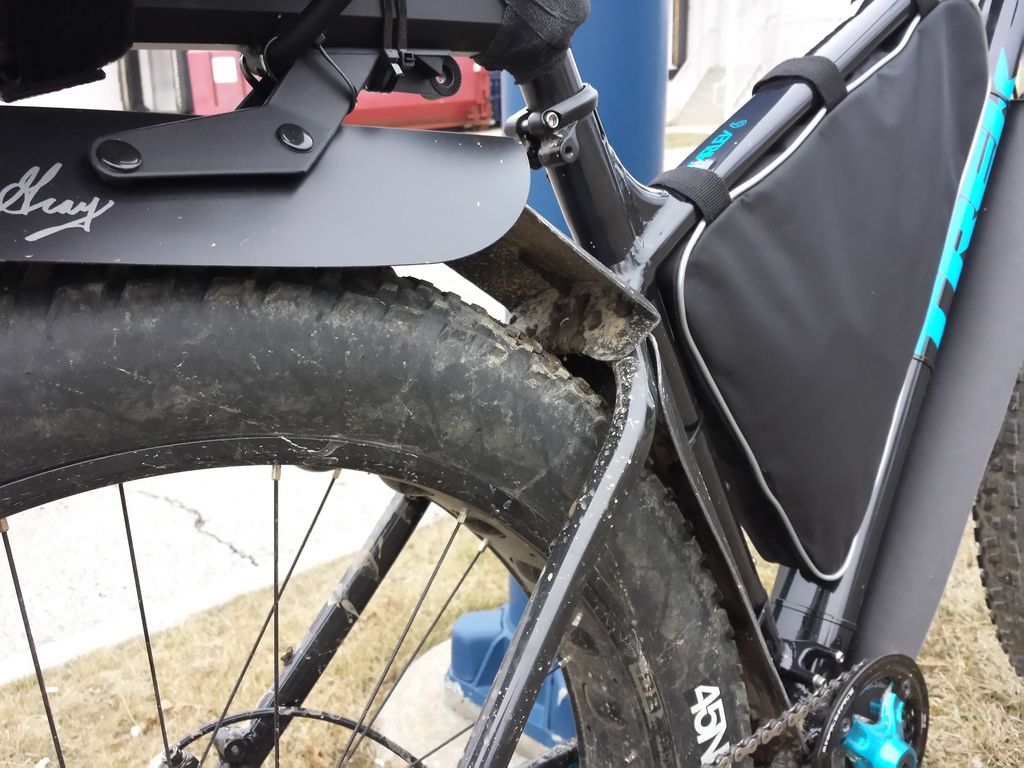

    Quote Originally Posted by worldskipper View Post
    Nice, your bike looks like mine, lots of plastic on it!
    How long is that fender of yours? How wide? How much did you spend on garbage cans?
    The downtube fender is 21 inches long and 6 1/2 at the top and tapers a bit towards the bottom bracket. I spent about 10-12 bucks on the trash cans. Used a smaller one for the front fender and the one behind the seat tube. They weigh practically nothing and keep a ton of crap off of me. I tested them out a few days ago after we'd had a day of rain and 6 inches of melting snow. Purposely ran through some deep wide puddles at about 10 mph and only my toes and inside bottom of my pants got wet.
    Sep 2014
    985
    After a few days of running through puddles.
    I think they work pretty good.
