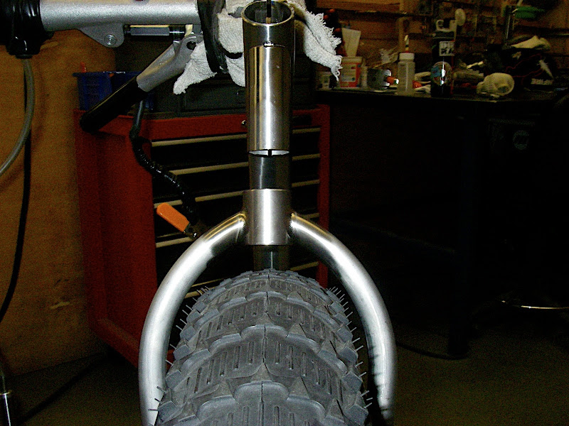

    That BB yoke looks very hefty. Is it machined from solid or welded sheet metal ?

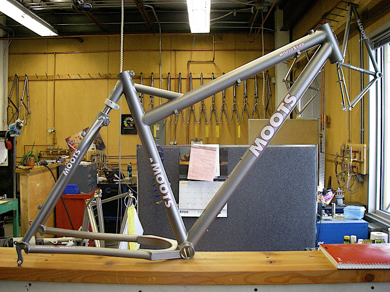

    I wanted a mountain bike. One that I could stick 29" wheels onto and ride, grinning, all over Joseph Smith's green earth. And then, in winter, I could stick psick phatties onto it and ride all over jehovah's whiteness.
    A drawing, a few phone calls, and lots of back and forth followed. Brad @ Moots happened to be starting a similar build for himself. More ideas. Tweaked drawings. Water jet cut yokes. Then some thinkering, lots of measuring, cutting, mitering, machining. And some gorgeous welds.
    <a href="http://picasaweb.google.com/lh/photo/c-IEP46iyjjR5POlF41-yw?authkey=Gv1sRgCLvLwaWRu8rLHQ&feat=embedwebsite" ><img src="http://lh4.ggpht.com/_Z3iU73Uw_T8/S1f1Jb2_1_I/AAAAAAAAS3E/G0trEetFafE/s800/snoots%202%202010.JPG" /></a>
    If you look closely, this frame and my now-departed MX frame are pretty dang similar. The differences, aside from tire clearance, are in the very fine details. Once I actually have the frame here I'll go into detail on those, um, details.
    <a href="http://picasaweb.google.com/lh/photo/tEF34M1El5ovQiK4c7k7dw?authkey=Gv1sRgCLvLwaWRu8rLH Q&feat=embedwebsite"><img src="http://lh5.ggpht.com/_Z3iU73Uw_T8/S1anGvw0RrI/AAAAAAAASwk/TGccl2Ozh4o/s800/snoots%202010.JPG" /></a>

    Quote Originally Posted by dmx1
    Water jet cut, then welded. I'll get some detailed pics once I have it here.

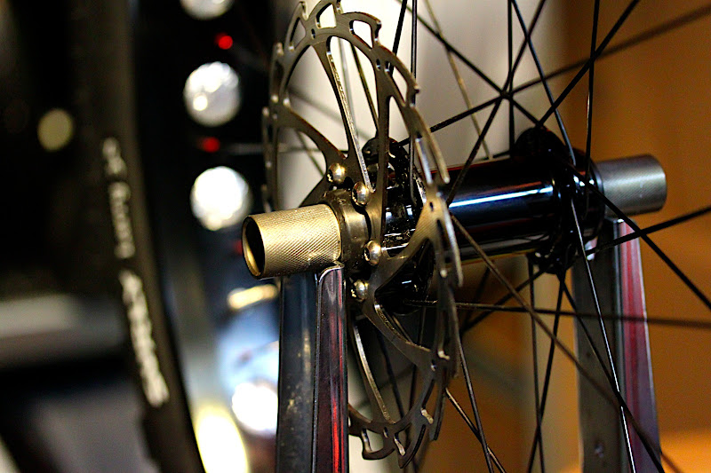

    Just finished up out in the shop...
    ...and realized that I have two pics that'll answer a whole boatload of questions about the build.
    <a href="https://picasaweb.google.com/lh/photo/yGXGDjX9-9_f3fw8hUMS8Q?authkey=Gv1sRgCLvLwaWRu8rLHQ&feat=em bedwebsite"><img src="https://lh6.ggpht.com/_Z3iU73Uw_T8/S1ktraGzOlI/AAAAAAAAS7w/m2shQCKo0as/s800/IMG_8997.JPG" /></a>
    and
    <a href="https://picasaweb.google.com/lh/photo/t5i3ZqhZ75Av3WML3DT2bg?authkey=Gv1sRgCLvLwaWRu8rLH Q&feat=embedwebsite"><img src="https://lh4.ggpht.com/_Z3iU73Uw_T8/S1ktuEbaSvI/AAAAAAAAS74/2peGyhEW1MQ/s800/IMG_9000.JPG" /></a>

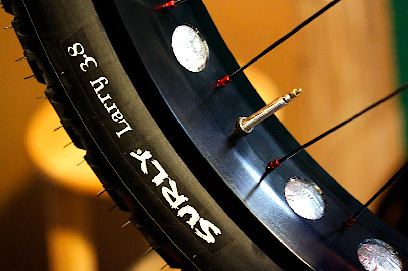

    Spokes came from where they almost always come from for my personal wheels: The junk box. I dug through the randomness therein and found 16 butted Comps for the disc side, and (bonus!) 16 butted/bladed Aerolites for the loose side. The Aerolites were ~2mm too short, so I'll be doing some de facto 'durability testing' on whether you really do need all spoke threads engaged (or "hidden") inside the nip. Nips are also oddballs--red Prolocks left over from a batch-build for a certain pernickety small manufacturer.

    Reputation: dRjOn's Avatar
    2,580
    genre buster: lightweight ti softail/maverick fat bike...its not going to be a fixed gear is it?!

    Reputation: miles e's Avatar
    3,034
    Quote Originally Posted by mikesee
    Better you than me, keep us posted. Are those 80mm rims?

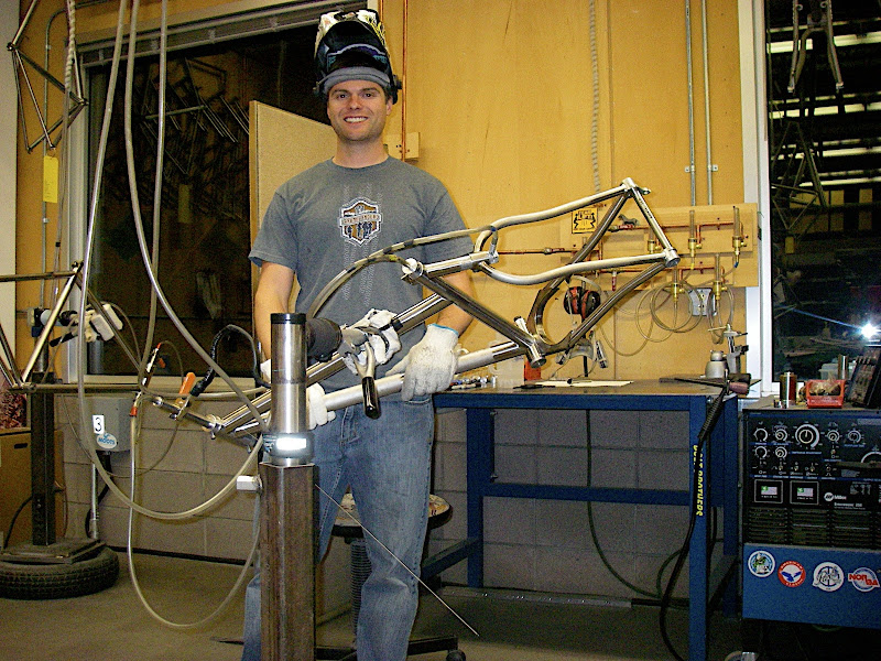

    Progress...
    ...as in, it's here.
    <a href="https://picasaweb.google.com/lh/photo/qSQD86tt8_f-YkeeGq4Aqw?authkey=Gv1sRgCJGuwKDHxt2hag&feat=embed website"><img src="https://lh4.ggpht.com/_Z3iU73Uw_T8/S1vtqvoyBaI/AAAAAAAATJI/KGVhEsl7AeM/s800/IMG_9157.JPG" /></a>
    <a href="https://picasaweb.google.com/lh/photo/9lHBqAlLfxchnIj0XxLZvg?authkey=Gv1sRgCJGuwKDHxt2ha g&feat=embedwebsite"><img src="https://lh6.ggpht.com/_Z3iU73Uw_T8/S1vttAZai0I/AAAAAAAATJQ/AxnbgFV7rWo/s800/IMG_9178.JPG" /></a>
    <a href="https://picasaweb.google.com/lh/photo/4JBcc_bw1HIxO2Fka3zkag?authkey=Gv1sRgCJGuwKDHxt2ha g&feat=embedwebsite"><img src="https://lh5.ggpht.com/_Z3iU73Uw_T8/S1vtvSLMOQI/AAAAAAAATJY/jYgtwNxo40o/s800/IMG_9186.JPG" /></a>
    <a href="https://picasaweb.google.com/lh/photo/qNPpB5l1l-GX6JrxRoOfOw?authkey=Gv1sRgCJGuwKDHxt2hag&feat=emb edwebsite"><img src="https://lh5.ggpht.com/_Z3iU73Uw_T8/S1vtx4xez8I/AAAAAAAATJg/G3Bjm5b5cKk/s800/IMG_9195.JPG" /></a>
    <a href="https://picasaweb.google.com/lh/photo/JYsffIh6XT4Xn4llv993yg?authkey=Gv1sRgCJGuwKDHxt2ha g&feat=embedwebsite"><img src="https://lh4.ggpht.com/_Z3iU73Uw_T8/S1vt0fyXepI/AAAAAAAATJo/0rvzKVmqeDo/s800/IMG_9202.JPG" /></a>

    182
    sweet baby jesus
    Lighten up.
    Reputation: mangoman's Avatar
    1,089
    The welds...so beautiful.
    - Capt. Obvious
    78
    Welds
    Man those welds are beautiful!!

    Rear hub spacing??? Usable # of cogs?
    If Huffy made an airplane, would you fly in it?
    This place needs an enema
    Reputation: mikesee's Avatar
    Aug 2003
    13,375
    Quote Originally Posted by damnitman
    165. All 9+. I've got a 20/29/bash up front, and an 11/36 out back. You know--mountain bike gearing. The rear cassette is an 11/32 that I stuck an Action Tec 36t inside of. Dropped one of the smaller cogs (14?) to make room for the 36.

    Hmmmmm welds
    Reputation: maxus's Avatar
    95
    Quote Originally Posted by velopax
    @maxus
    Have you some more info about your local builder? I am just curious
    http://www.rapid-titan.ru/ , a small firm from Korolev (a town near Moscow)
    They were making export frames about 10 years ago, even for some famous brands (eg Colnago and so on), but now they weld frames mostly for internal market.
    These guys are making cheap enough frames, generally made of unbutted tubings (initial material - rolled Ti ship tubes ). Not wery light, but strong and cost less than 700 usd per frame

    Brad is a perfectioniste of the highest order, so when we agreed to use the unfamiliar-to-us direct mount front der on this bike he was unwilling to make a permanent mount for it until we knew the *exact* position it needed to sit in. There are tech drawings available for the der mounting location but they assume chainring sizes that I'll never use. So Brad designed and machined a basic and perfectly functional temp:
    <a href="https://picasaweb.google.com/lh/photo/pnXxDyLmzzwwlsoK9Cs1dw?authkey=Gv1sRgCJGuwKDHxt2ha g&feat=embedwebsite"><img src="https://lh4.ggpht.com/_Z3iU73Uw_T8/S1yQxtT5BLI/AAAAAAAATOE/l-scInFe9KQ/s800/IMG_9509.JPG" /></a>
    He installed it roughly where he thought it would end up living, and truth be told I never had to adjust it so much as a fraction of a millimeter. I built the bike, ran the housing to the der, and rode it. The 'old me' would have fiddled with it 16 ways from Sunday before putting it right back where it started. But I'm older now. Smarter. Or at least busier, and since it was working perfectly I just didn't see a need to mess with it.
    But then I got in a dirt/rock ride in SW Utah with some friends that pushed me hard to keep up. I didn't yet have a 29" front wheel built for it, but I stuck a tall rear hoop in there. And had fun.
    Except that the tall tire kept rubbing (at ~full travel) on the temp front der mount. Can't have that. So I sent Brad a post-ride email and we made a plan.
    The plan involved driving to Steamboat with the bike. Now that we knew the der position was good, Brad could machine and weld on a permanent mount. A week later I tossed the bike and the dog in the car and drove NE.

    Are you using the same BB as the snoots?
    73 X 145 or 100 X 145?
  76. #76

    Yes, I'm using a 100mm Phil square taper BB.

    Too bad Moots doesn't make anything "fat" available to the general public.

    Just ask. If you're willing to pay, I'm sure they're willing to build. It's not like MC has some mystical power over them, just the ability to think outside the box, and have the balls to ask someone to build it.
    Sad thing is, they don't offer swoopy tubes. For purely silly reasons, my next bike will have them, and since I need another like I need more holes in my head, I'd love combining Mikes bike, with sexy curves. I love my Pug, and ti, and softails, and 29ers, mmmmm, yummy......
    Perhaps Black Sheep will entertain my insanity.

    Hey Mike, which rims are you running in the fatbike photos? 70mm?

    Those are Speedway 70's.
    Loved 'em, but I'm gonna try a few different things this winter.

    A veritable storm of ideas coalesced inside my noggin late last summer, all related to where I want to take this bike the next few years, and what needed to change (on the bike) in order to enable it all to happen.
    The sticking point has always been the fork--the bike was originally designed around the Maverick SC32, but I never even liked it, and I certainly didn't love it enough to keep it.
    So I moved on to the Maverick DUC, and that was a BIG improvement in chassis stiffness and damping--in fact it's not a stretch to say that I *loved* what the DUC did for this bike. But the DUC has a fatal flaw--very limited tire clearance. Where I'm going I need float, which means I needed more tire clearance.
    MCS was kind enough to offer a set of Lefty clamps but I had something else in mind.
    First things first--the patient needed a 'procedure' so that she could be fitted for an organ transplant.
    Buckled her down good:
    <a href="https://picasaweb.google.com/lh/photo/QqFYxo9TMGU2CLeIJzVWVrNqVa4cxzZiKb61FvxUSvk?feat=e mbedwebsite"><img src="https://lh5.googleusercontent.com/-xSRLHMxIYUU/TxEpai91VYI/AAAAAAAAebk/U8p-9YzhWU0/s800/P1011161.JPG" height="480" width="640" /></a>
    Off with her head!
    <a href="https://picasaweb.google.com/lh/photo/JSP_ICcFVtcl-ivAEHFDwrNqVa4cxzZiKb61FvxUSvk?feat=embedwebsite"> <img src="https://lh4.googleusercontent.com/-gyadaz0cOlM/TxEpZ2wX3GI/AAAAAAAAebc/JBjIPBNmSlU/s800/P1011162.JPG" height="480" width="640" /></a>
    New head sewn on:
    <a href="https://picasaweb.google.com/lh/photo/VUw4WLq5yd22sXLUAfaS0rNqVa4cxzZiKb61FvxUSvk?feat=e mbedwebsite"><img src="https://lh4.googleusercontent.com/-jw7ZNw_-UwQ/TxErP0yTCfI/AAAAAAAAeb0/c7NXqDt0pkM/s800/IMG_8345.jpg" height="800" width="536" /></a>
    But something's different--obviously. What? Why?
    All the hints you need are right here:
    <a href="https://picasaweb.google.com/lh/photo/MOqvDuelWn2Kt4nqHqqPmLNqVa4cxzZiKb61FvxUSvk?feat=e mbedwebsite"><img src="https://lh3.googleusercontent.com/-1P-DwSptRww/TxErPK_lpRI/AAAAAAAAebs/0qdG0_6rOM4/s800/IMG_8227.jpg" height="800" width="565" /></a>
    One more hint--and this one's almost a dead giveaway--comes from the title of this post.
    Get it?

    Quote Originally Posted by aosty View Post
    Okay, I'll play... ActionTec?
    You did have one on that B2
    <a href="https://picasaweb.google.com/lh/photo/YH1jIlYWCGQN0G5DRnM-oLNqVa4cxzZiKb61FvxUSvk?feat=embedwebsite"><img src="https://lh6.googleusercontent.com/-wPHLSl-mb2g/TxGoWPiEaQI/AAAAAAAAecU/ry-Rn58n2Bk/s800/IMG_8247.jpg" height="538" width="800" /></a>
    <a href="https://picasaweb.google.com/lh/photo/rYgBGp3LMWfmRLzwhOpGxLNqVa4cxzZiKb61FvxUSvk?feat=e mbedwebsite"><img src="https://lh3.googleusercontent.com/-cjNqPLBU7zk/TxGoQrYru-I/AAAAAAAAecE/WxfpRRYg0oE/s800/IMG_8204.jpg" height="538" width="800" /></a>
    Aosty FTW!
    The whole bike got a spa treatment, with new rims and tires at the top of the list: BFL's on 90's, tubeless (for now?).

    Quote Originally Posted by MendonCycleSmith View Post
    Hold the phone.
    MC went tubeless??????
    That's bigger news than the new fork thingie, (though that is pretty freakin' hawt!)
    Say there young'n, I've been havin' problems with tubeless since you were knee high to a grasshopper...
    I've got three 90's set untubed right now. RIdden once, down to stupid low PSI's (measured at 0.0 on my digital gauge...) trying to break the beads loose. Nope.
    Got home, pumped 'em back up to 6 or so, then shut down the shop and went to bed.
    Came out in the AM to find two flats.
    Hence my 'for now?!' question above.
    As always, I want it to work. But that may not be enough...

    Got in a solid XC ride on this setup today. Front was bomber--only lost pressure when I opened the valve and dumped on purpose for soft trail.
    Rear? Not so much. Repeated burpage and leakage. Sounds like a personal problem, I know...
    I may tear it down and retape it a little different, but so far this confirms my feelings on ghetto tubeless setups.

    Quote Originally Posted by mikesee View Post
    MC
    Curious. As I've always maintained, we all ride differently.
    What pressure were you running? I'll assume you had the super wide Stans tape?
    I have beat the snot out of mine at 8 or so, hard climbing, cornering etc, no burp.
    I did have to retape one of them initially, sounds like you're having the same situation I did. One solid, one wonky.
    I found it really helped to have a super dry, clean rim, no sealant remnants. Rim strip down, taped at the valve and seam to cover the drain holes and old the strip, then a well stretched layer of Stans tape. I hit everything with speed degreaser prior to the Stans too.
    Then, using a rag, I pushed hard and spun the wheel a bunch to really settle the tape into place. Any open wrinkles, edges, crinkles etc, allowed the sealant to creep in, and cause leaking.
    Once I got the technique down, they have held air for over 2 months...
    Ghetto? I dunno if it's Ghetto, this is the one set up I wouldn't give that name to.
    Hope you get it working, I found it well worth the initial screwing around.

    hmm...why is there an (aluminium? sleeve?) insert in the head tube? something to do with how action tecs work?

    Quote Originally Posted by dRjOn View Post
    I future proofed it to some extent. The AT fork uses an old-school 1 1/4" steerer and HS, and an 1 1/8" stem.
    I'm not sure if we were even discussing this frame/fork at the time, but Brian Blair (aka Donkey 'round these parts) mentioned something about the new 44mm headtube standard possibly being reduced to use 1 1/4". Light bulb went off. So that's what those silver sleeves are doing--adapting the 44mm HT to the 1 1/4" HS.
    Pretty slick.
    Doubt I got below 8psi yesterday.
    I *always* tube my tires, at at least 30 psi, for a few hours before untubing them. The point being to make absolutely sure that the tape is perfectly stuck down everywhere, allowing no egress for air nor sealant.
    Since the rim is designed with beadlocks, I'll let it slide, but these tires were never, ever intended to be run tubeless, making this setup 100% ghetto in my book.
    Not giving up on it yet, but prepared to if needed.

    Quote Originally Posted by Dogdude222 View Post
    I'd like to know more about the fork that is underneath that action tec unit. Where did it come from? Width? Offset? Why black? Why not, say, neon pink?
    And so on...
    Russ at Action Tec built the fork. I sent him a 90 laced to a Fatback hub, with a BFL mounted, so that he'd have a template for dropout width and tire clearance. We talked on the phone several times before he went to work, and I mention that because if you've ever had the pleasure of talking with Russ you know what a salt-of-the-earth genuine nice guy he is.
    A big consideration was keeping the A-C the frame was designed around--no small feat at 530mm. More on that later.
    Anyhoo, during one of those conversations Russ mentioned that he could probably get about 7" of clearance between the pipes, which made me giggle out loud before agreeing wholeheartedly that that'd work!
    My tenure riding snowbikes goes back to long before there was such a beast. Which simply means that my tastes and preferences have evolved with every generation of ever-widening rims and tires that have been produced. My experience is that a snowbike works best with a low BB and an uber slack HTA, the former to give better standover when ankle deep into fluff, the latter helping to auto-center the incessant wandering of the front wheel/tire (regardless of tread) that can't grip the surface of the snow because the surface is always moving. (Got all that?) So along with the 530mm A-C, 135mm OLD, and 7" BtP, I had Russ build it with ~54mm of offset.
    Yes, 54. That's coupled with a 67* HTA. Which gives a trail number of about eleventy billion.
    In a technologically-aided attempt to limit front wheel wander, I've used Hopey steering dampers for the last few years on both of my snowbikes. The effect is immediately noticeable--they keep the front wheel from wandering, allowing you to expend less energy holding a straight line. If you ride soft snow and narrow trails like I often do, being able to keep the front end quiet is *the* difference between riding the skinny line and crashing/cursing/walking. All you have to do to prove it's worth is turn it off (easy enough to do, even on the fly) and suddenly you're weaving and crashing like the proverbial drunken sailor. The downside to the Hopey? I have yet to have one last more than 200 (yes, 200) miles before it loses all damping and becomes merely ornamental. On top of that, Tim Hopey has essentially called me a liar each time I call him to ask him to rebuild the unit, and often takes better than 6 months to return them to me. There's a lot more to that story, but the takeaway is that damping the steering works wonders on soft snow even if Hopey dampers aren't up to snuff.
    Knowing that with the hydraulic unit of the Action Tec fork I would never be able to run a damper, I exaggerated the amount of offset to essentially mimic the same effect. It looks downright weird when viewed in profile, but it's hard to see the profile view of a bike when riding, unless you're prone to cruising along windowed storefronts. I've only got one ride in on the new fork, but I was able to swap with a guy on a snowbike with very traditional frame and fork geo. I rode his bike a few times in a few different snow conditions, and it was immediately apparent each time that mine held a straighter line with less effort/input.
    Phew. Got all that?
    Oh--and black because it's the new black.

    Geekin' out.
    Although I've owned this bike for a few years, the new front end has thrown a minor wrench into all that I'd done to 'dial it in' to my liking.
    Which means during and after every ride there is mandatory fiddling getting done. A sure sign that a bike is 'dialed' is when I can ride it 5 or 6 times in a row and not need to spin a wrench nor change a tire. Gonna be about a dozen rides I'd guess before that happens...
    Right now the fiddling is largely tire and rim related. I've been riding 100mm rims for ~5 years now on my 'expedition' snow bike, but never gave thought to running them on this type of bike because they were so ponderous. The introduction of Speedway's 90mm and Surly's ClownShoe 100mm rims changed that--they're light enough to ride for fun.
    First two rides were on 90's with BFL's, tubeless. So far, tubeless fatties haven't really blown up my skirt. Lots and lots of fiddling to get them set and holding air. More fiddling to *keep* them holding through a ride. I keep scratching my head and wondering what I was trying to achieve with the tubeless thing to begin with? For me, it keeps coming back to the fact that I rarely flat using Surly tubes, and once you factor in all of the tape/rim strip/sealant voodoo, there is virtually zero difference in weight.
    So yesterday I pulled the BFL/90 wheels off and stuck a set of Clown Shoes on. BFL up front, Husker Du out back. The change to the HD rear tire was part curiosity, part necessity. In other words, I want to get more miles on this tire as so far it is impressive. But also because the combo of the 100mm rim and the BFL is just a skosh too big to fit the rear end of this bike. Planned obsolescence? Lack of foresight?
    Meh. 3 years ago whom envisioned this many (good, big) options in rims and tires? Not I, and I signed off on the frame drawing. Meh.
    Here's how she sits. Atm, IIRC, trail is at ~122mm.

    Front tire measures ~116mm right now, and has ~7mm between it and the fork legs.
    <a href="https://picasaweb.google.com/lh/photo/64QeWcFYMWkT7IVENS3HGbNqVa4cxzZiKb61FvxUSvk?feat=e mbedwebsite"><img src="https://lh6.googleusercontent.com/-r1YXg7L622g/Tx91jT3p3uI/AAAAAAAAeh0/dEMI4N7FBYI/s800/IMG_9788.jpg" height="538" width="800" /></a>
    Rear tire is at 108mm, and has ~5mm to the chainstays and 6mm to the seatstays.

    Favorite rear hub, ever. 165mm OLD.

  169. #169
    Aug 2003
    13,375
    9mm thru axle qr? 135mm? whatwherehow?
    That was pretty much my reaction when I found out about these. Hiding right under our noses, too.
    Fatback hubs.
    9mm thru x 135mm front, 10mm thru x 170mm rear. And the thru-bolts are QR.
    Pretty slick.
    MC

    Effing Bud...
    ...is a freaking stud.
    <a href="https://picasaweb.google.com/lh/photo/Vp5mpyNnezzzjYOcHFdABBltJjMXiDiNlir3tmyGpnU?feat=e mbedwebsite"><img src="https://lh3.googleusercontent.com/-2EzX-0HSQXw/UGeNOw9U1sI/AAAAAAAAhA0/k5_ilNl7iJQ/s800/IMG_5300.jpg" height="537" width="800" /></a>
    <a href="https://picasaweb.google.com/lh/photo/_rPKDAASP9i8GYvEN3NXEBltJjMXiDiNlir3tmyGpnU?feat=e mbedwebsite"><img src="https://lh6.googleusercontent.com/-ap95LRXUH0s/UGeNP7WvbQI/AAAAAAAAhA8/2bIT84Rj9Vw/s800/IMG_5663.jpg" height="455" width="800" /></a>
    Thanks Surly--just in time for mudbog season round here...
    MC
  185. #185
    Hybrid Leftys aren't real Moderator
    Reputation: MendonCycleSmith's Avatar
    Feb 2005
    15,944
    Want one, badly.

    Managed to get out for my ~longest ride of the summer yesterday. Saw no one for the first ~4 hours, but as I neared the end (and the trailhead) I crossed paths with a few guys.
    Here's the bike as ridden:
    <a href="https://picasaweb.google.com/lh/photo/yGR31ehbn0sK6fP3OW8k_BltJjMXiDiNlir3tmyGpnU?feat=e mbedwebsite"><img src="https://lh4.googleusercontent.com/-_p0Po_bEvIE/UGk01DSa13I/AAAAAAAAhBg/SjCZkqigXbg/s800/IMG_2041.jpg" height="603" width="800" /></a>
    I was descending a chunky bit of trail when I saw a guy climbing toward me. Pulled over to let him come up but he stopped and stepped off the trail anyway, quipping, "Yours is bigger, you come on down...".
    Seeing the full-frontal view of Bud *is* pretty impressive--even on a Marge Lite.
    The other guy I passed looked closely then asked why I ran such a 'relatively small' tire out back.
    That'd be a BFL, also on a Marge Lite. Bud really does make BFL look small. The casings are within ~2mm, but the difference in tread has to be seen *and* ridden to be believed.
    MC

    Cripes, that makes the BFL look like a slick.
    Love it.
    Disclaimer: I run Regular Cycles (as of 2016). As a profiteer of the bicycle industry, I am not to be taken very seriously.
  193. #193
    32
    How does the Bud roll compared to the BFL?
  194. #194
    Aug 2003
    13,375
    Quote Originally Posted by BradA57 View Post
    I'm afraid I won't be able to answer that.
    Bud makes me feel like I'm 14 again. And that's all that matters.
    MC
    P.S. My non-PC answer:
    Shame on you.
