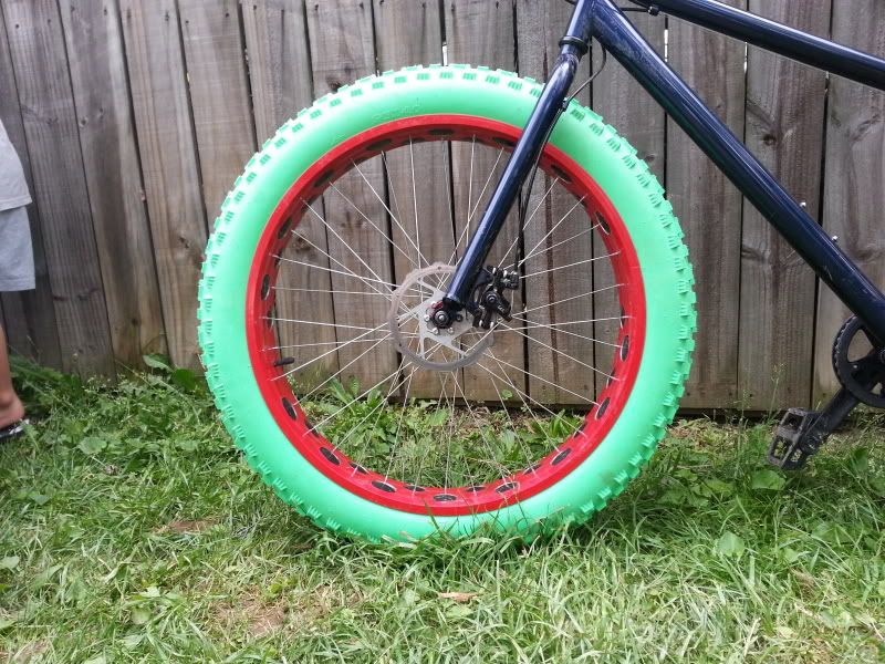

    Here is another dolomite I did for a friend today:
    It's strange how inconsistent these bikes are. I have done a few now and this one felt really really nice, like a much higher end bike. Others felt like a walmart bike.

    That looks great! What method did you use to paint it? Any upgrades or is it all stock?

    Great!!!....Thanks!!! Already painted my rims black ...Now I`m thinking about painting the frame!!!

    Quote Originally Posted by Bearhunter View Post
    Bone stock except the paint. I just stripped the frame down, steel woolen the clear coat a bit, and spray bombed it. It has about 4 coats. Time till tell if it hold up...
  46. #246

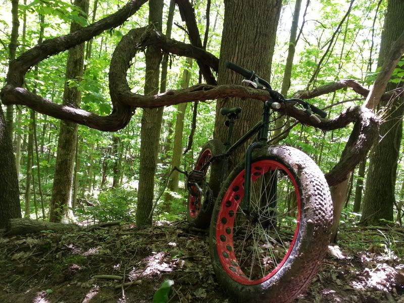

    Hello everybody. I tripped across this thread and registered. I've been mountain biking for a few years now. I just bought a Dolomite after seeing a picture of one. I picked it up at Academy for $250 - this thing is a bargain IMO. I spent the weekend riding it up and down the beach. Tonight I mount a better seat (OUCH!) and tear it down for the post-beach cleanup. I can't wait to hit the trails with it this weekend.

    Wow it is nice to be back on 2 wheels again. Very impressed with the Dolomite. Compliments everywhere I went today. Did a 5 mile trek through The Ohio State Campus, hit a few trails on the way home. Huge muddy smile.
    Cant wait for my Green Floaters!

    Floaters came in today. I will replace this pic with a better one, my boys wanted to see a tire tonite before I mounted it.

    I threw a little Verde flavor on the Dolo. Perfect for cruising High street and Ohio State Campus. Just having fun...
