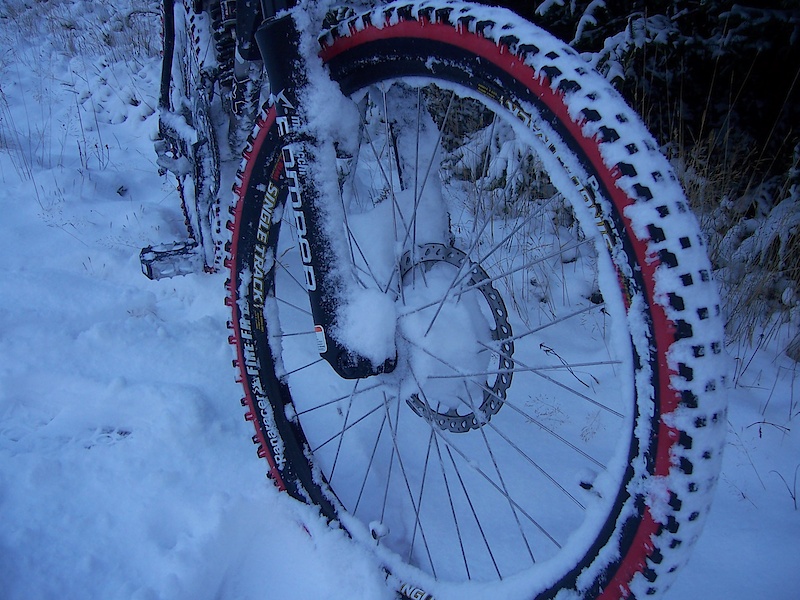

    It's all about tyre volume IMO and even a 2.5" tyre comes nowhere near the volume of a 3.8". Current 3" tyres have pretty rigid sidewalls and I don't think they'd spread out enough on a soft surface .
    Some volumes 26" tyre:
    2.1" 4.3 litres
    2.35" 5.4 litres
    3.0" 9.1 litres
    3.8" 15 litres
    4.5" 21.7 litres
    Some volumes 29er tyre:
    2.1" 4.7 litres
    2.35" 5.9 litres
    (These calcs are based on where I set the centreline of the torus, so if you do your own calcs you may get slightly different answers.)

    Last winter, I was running Salsa Gordos and a 2.3" Bontrager tire front and rear. I was great in snow up to 5 or 6". After it got really deep, I tried riding in snowmobile tracks with my tires aired down. It kinda worked but wasn't great.

    You can ride anything in the winter when the conditions are good enough. I used to ride my singlespeed 29er everywhere I could. The fatbikes just really expand your horizons in terms of conditions that you can ride.
    I agree with other people here, a fatbike is the only real way to go for a serious upgrade. I tried some different things but in the end I should have just saved the $$$ towards the Pugsley.
    In the meantime, throw the fattest tires you can fit on your singlespeed, ride it whenever you can until you can get your hands on a Pugs or whatever.
