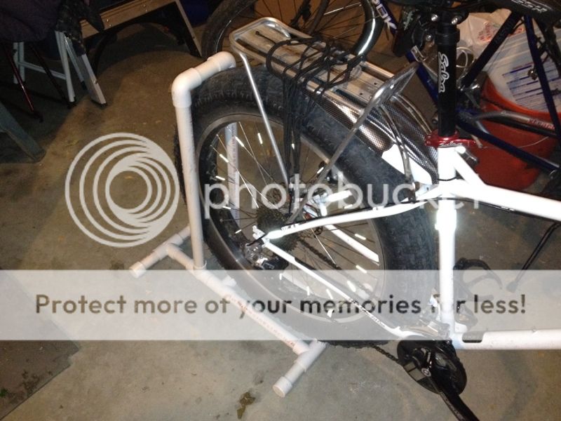

    I thought you all might be interested in the PVC floor stand that I put together for holding up my Mukluk. So, here you go:
    Low Cost Fat Bike Stand
    Normally I use Feedback Sports RAKK stands, but as they don't fit a fat bike I needed something else. The article above has a bit of info on what I did, including all cut sizes should you wish to make your own. This cost just over $13 after sales tax and does exactly what I wanted.

    I just made this per the instructions, came out great! Thanks again for sharing and putting the instructions together. I had it done in 15 minutes and around $10.
    No problem; glad it worked out for you. Got a photo, per chance? I like seeing stuff that other people have made.

    BFL approved!

    Did you have to make it any wider to get them to fit?
    2,516
    No mods for the BFL's, but the uprights could stand to be a quarter inch taller, as the stand wants to rock forward when taking the bike out. The tread of the tire sticks to top pipe. Not a big deal at all, I'll adjust it when I glue the stand together.
    That makes sense. For my Mukluk (Rolling Darryls and Endomorph/Larr) it's just got a smidge of clearance, so it seemed right for me. I imagine you'll be able to just not cement things wholly in and it'll be good?

    Instead of glueing the top part in place, could you just get 2 tubes with a bigger diameter to slide over the 2 uprights and make the whole upper part adjustable in height ?
    Maybe with a bungeecord inside the tubing to keep some downward pressure on the wheel ?
    Reputation: c0nsumer's Avatar
    477
    Quote Originally Posted by Rabies010 View Post
    Instead of glueing the top part in place, could you just get 2 tubes with a bigger diameter to slide over the 2 uprights and make the whole upper part adjustable ?
    This design really wants the vertical loop to be taller than the tire, since there's no need for it to contact the top of the tire. It really only serves to keep the bike from falling over. The rectangle that sits along the floor keeps the bike in place.
    Really, the vertical loop could probably be made taller to provide enough clearance and it'd be fine.

    Hence the adjustable part.
    (And with a bungee to keep some downward pressure it will fit regular 26", 29", fat and big fat's)
    Or with the expanding options you have with this tubing you could just make a double or triple or...(you fill in the amount of bike's you want to store in them)
    That downward pressure isn't needed in this design, though. It'll fit any size wheel as it is, so long as the wheel settles nicely between the spacers that sit on the ground and the wheel can lean over against the upright. The top piece between the uprights is only needed to keep them from pushing apart.
    Downward pressure from that piece on the tire won't serve to hold it better, it'll just make it more complicated to insert to and remove from the rack.

    Just made mine today. Cost $17 but that included almost $4 for the PVC solvent. Which brings me to my question. With all the pieces friction fit, the whole thing seems tight and I'm not sure i even need to glue it together. I suppose it may vibrate loose over time. Any thoughts on that? Thanks a ton for this plan. Just got my Mukluk yesterday and so glad to have a stand to put it in. Picture to follow..
    I personally wouldn't friction fit it, just because some things could rotate and it'd just feel sloppy. I really think it's worth solvent welding everything together, or maybe just leaving the uprights loose so it can be collapsed.
