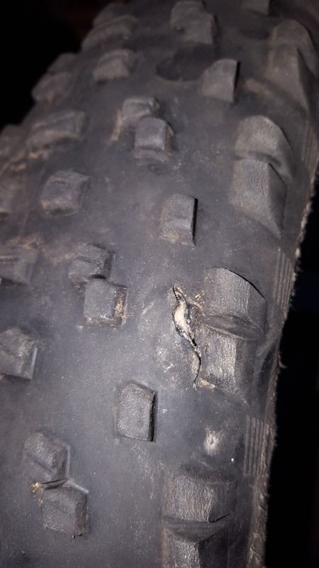

    Ok, so band practice got canceled tonight, so I had some free time.
    Here's the cut in the tire, it was much bigger in my mind, but it still is pretty big and when you push on the tire it splits open, so there needs to be some structural integrity there - a simple tube patch inside was not nearly enough.

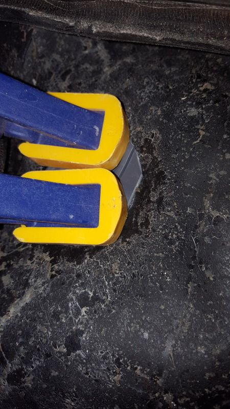

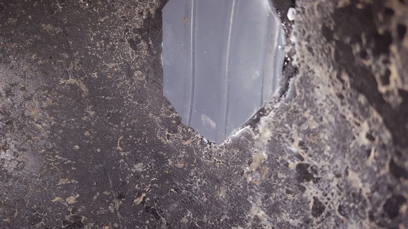

    So I searched around for something to try to put in there that would flex with the tire, yet provide some structure. It didn't take long for me to find something - a rubberized plastic sheeting that we have in the shed to protect the floor.
    I glued it in using medium viscosity super glue holding it in place with some wood clamps:
    After letting it sit for a half hour I pulled it out of the clamps, it seems to have bonded REALLY well, including this little bit of super glue that pushed through the hole:
    I have some Stans on order (should be here tomorrow), but I figured I'd try inflating it just to see if the patch would hold. Viola, it aired right up - I put it at 20 psi to set the beads and it's holding air great.

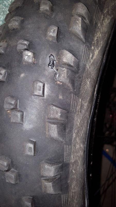

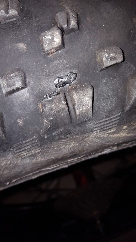

    I had the same flat once. Stick went right through the rim strip, same as you. Check it out!

    Wow, that looks just like what happened to me! I didn't save the stick, I know exactly where it happened, so next time I'm out there I'm going to see if I can find it.
    Are you running tubes? Did you repair the tire?
