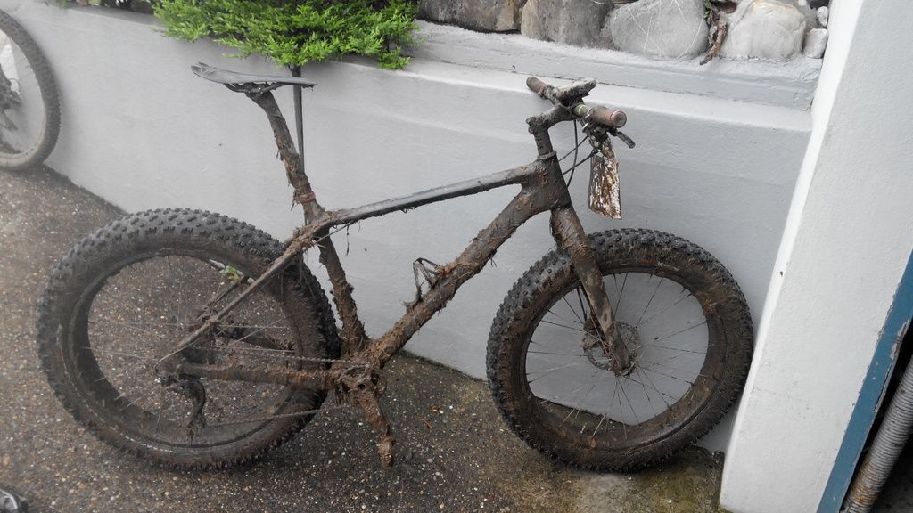

    I passed 10k kms on mine, and coming up on 3yrs of use, been thinking about a 27+ wheelset fur summer (dont think 29+ fits)
