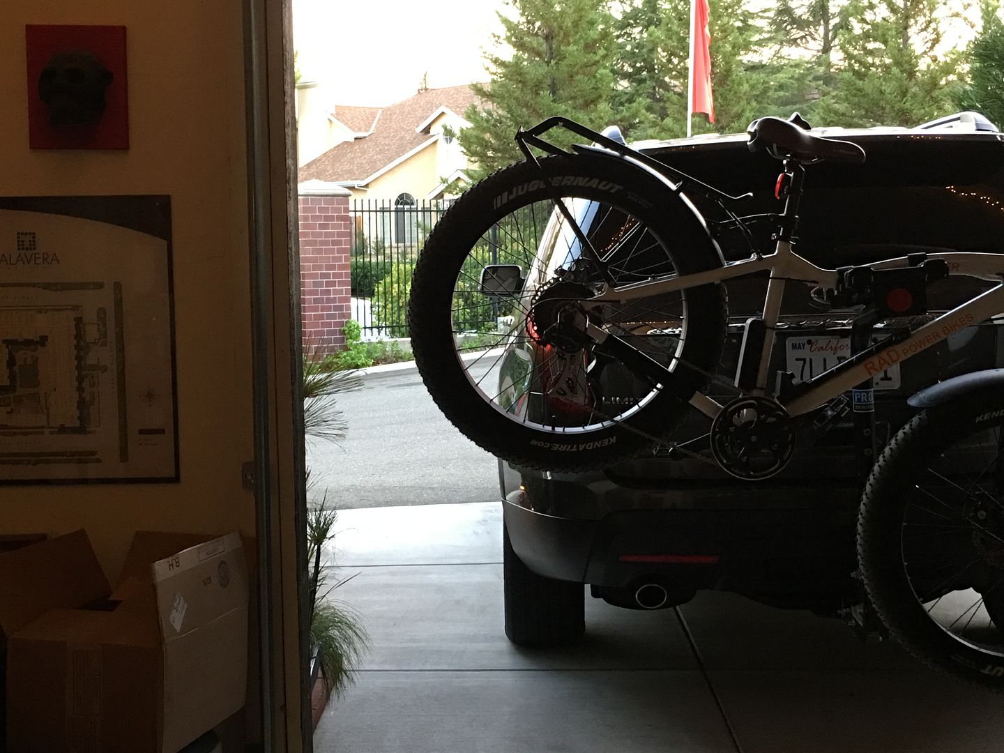

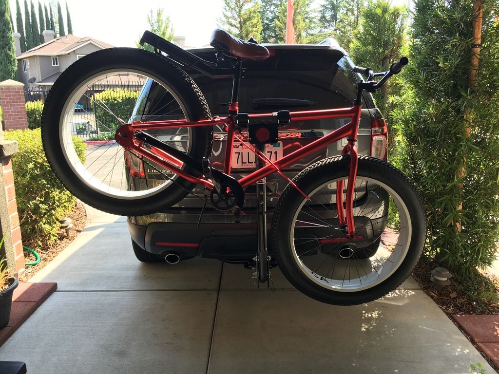

    Any ideas on how to prevent bikes from swaying too much when installed on a hitch mounted rack?
    My thought is with the added weight of the fat tire bike - it's more prone to sway and cause more damage to a vehicle or the bike frame against the rack pole in a hard stop.
    I installed my new hitch rack today and gave it a test fit with my hood bike. Just got me thinking about a panic stop and how to reduce or prevent the bike(s) from swinging forward and hitting my Explorer!

    Being cheep I'd just get a bit of 2x4 cut a couple notches in it to fit between the downtube of the bike and the vertical portion of your rack and then wrap a ratchet strap around it to hold everything in place. Or just get a better rack, like a 1up USA.

    That kind of hitch rack is from the 90s, not a modern design at all. That's why the bikes sway and bang into each other. Modern tray-style bike racks generally have none of these issues.
    People that use those types of racks often resort to bungies and straps to try and secure the bike, but as you realize, all of this tends to wear the bike's finish and little nicks and scratches tend to occur. That's also one of the heaviest fatbikes possible, so putting that much weight on a lever arm that far away from the ground is going to be conducive towards sway/play/movement.
    A modern tray-style rack will have the bike secured much closer to the ground/shorter lever arm. You have to make sure the tray-style takes fatbikes, but there are several that can.

    Agreed with above regarding old design.
    The only way to help with bikes moving around on a rack like that, bungee from the hitch, around a crank arm, through front wheel, and back down to hitch.
    I may have to rig something up like you said. I wanted to buy a better rack but - nothing decent on craigslist and in 1.5 years I'll have a new F150. Figured I'd try the hitch rack to hold me over..

    I don't mind so much having to use quick ropes or bungies to help keep things from swaying so much. I have a few neat "toys" for securing loads. But like everyone else - I'm always open to easier ideas!! lol
    I wanted to get a tray rack but that posed two issues for me which is why I did not go that route. Price (Around May 2018 I'll have a Ford Raptor or at least F150) so I won't need a rack by that time. And Storage. I only have a single car garage which is mostly man-cave. Not much spare room to store items so a selling point of the rack I bought was that I can hang it on HD hooks on a chunk of wall that would go otherwise un-used.
    I'll toy around with some methods and see what I can come up with. Maybe a simple paracord rope from the furthest out point wrapped around the pedal to help 'pull' the bike out away from the vehicle/stop it from swaying into the vehicle/hitch bar during a panic stop.

    OP, for starters, use a no sway hitch pin like this one:
    https://m.summitracing.com/parts/cht...2mSBoCG2fw_wcB
    But this will mostly stop side to side sway.
    For the movement fore and aft, have you confirmed the bike in the pic can even reach the bumper? It doesn't look like it from pic 3, it looks like the down tube will hit the vertical bar.
    If it does, you could get a 6 inch hitch extension. This will also potentially give you better access to open the lift gate with the rack in the angle down position.

    Getting one of these https://www.amazon.com/Yakima-800253.../dp/B00066YTGO to place between the stem and seatpost allowing the bike to hang lower on the rack. The bar will take the rubbing of the clamp instead of your top tube. Now wrap the rack vertical post with foam pipe insulation or a pool noodle. Bungee the cranks/pedal tight against the rack vertical.
    This actually helped TONS! My bike frame is a tad.. odd. So This is the ticket.

    In other news - tried out my bike rack today for the first time. It works. Solid. Yeah it wiggles a little bit but I have a few ideas to work with to make it far less wiggly. Overall it worked like a charm and hopefully it works for a year or so.
    My hollywood frame adaptor should be here Sunday. I did not like the mounting setup at all as pictured above. The bike stood way too far out past the driver side of the vehicle.

    I almost bought a Kuat bike rack.. but I think for now I'm just going to try this setup.
    I bought a Hollywood Frame Adapter and after drilling a modification hole - I think this will work out quite fine.

    Nice solution with the pin through the adapter and into the rack to keep it from swaying. As I mentioned above I just used to use the inner-most bike cradle and bungee it to the rack vertical to keep it from swaying.
    Used to have one of these, and the only way to mount it on a hanging style rack back in 1999 was to use the down tube. That was really awkward. Then I found the adapter. (not my bike)
    I only needed a few beers to brew up the idea of the cotter pin (bolt for the time being) to keep everything secure!
    ..so it voids warranties. Eh. It's all cheap china crap anyways. Modifications required :P

    You may find that the bike now sways more in the adapter "loops" than the adapter in the rack cradle. I know if i hit bumps that the bike would jump up as the seatpost and stem slid vertically through the adapter. Still had to strap it down on the low side somehow.
    I thought about this. I have a simple "figure 9" an paracord tie down system that is easy to use an secure the bike from that type of sway
