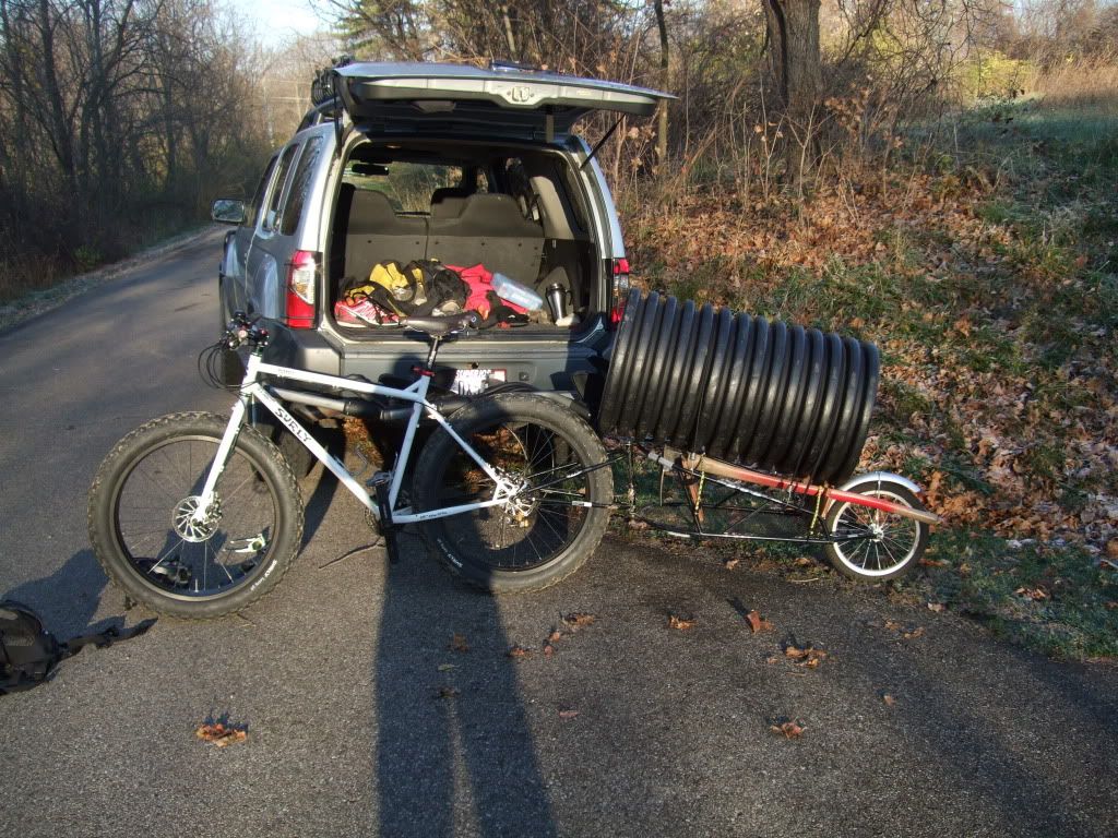

    sure, i pull a bob with my pug quite often
    Stubby-legged
    1,200
    what trailer fork do you use with the trailer. Company says the yak/ibex 28 will not work with the endo/marge combo.
    Reputation: fishingis4play's Avatar
    30
    28 fork
    You need the 28 fork for the BOB and do some minor bending to the trailer drop outs to get the tire clearance for the offset rear wheel. I drag all my bob trailers with my 9 Zero 7 even fattened the trailers up. You can get the fork from the bike trailer shop.com and you can see pictures of mine on bob talk forums.

    Mine works just fine. I didn't bend or retro fit anything. I did buy the 29er version fork for the Bob.
