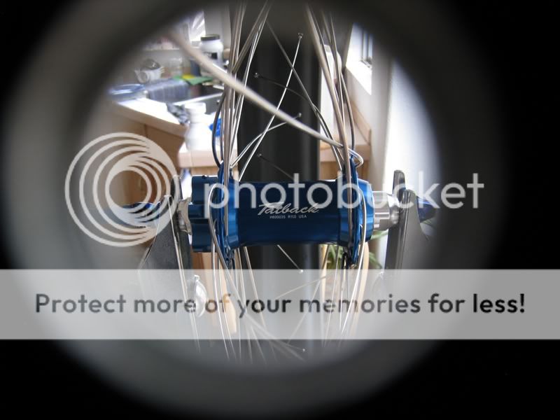

    Also, re:hubs. Your experiments used a CDale hub laced to just one offset row of holes? I recall a pic way back when, if you could repost please.

    I built my wheels with 135f/170r hubs on USC 100's using cross lacing (untensioned front):
    I know that the flange and the "matching" row of holes were almost in line with each other (spoke angle was 1-2 degrees).
    For a lefty hub, the left flange is 18.35mm from "normal" centerline, right flange is 31.56mm. If we shift centerline 50mm (swag) to the right, we get 68.35, -18.44. USC 100mm rim has spoke holes at +/- 25mm from centerline. Using the left row of holes (and drilling additional between for proper count) could yield a fairly symmetrical build - with the rim hanging 75mm outside of the spoke nipples. But USC rims are stout - don't know how a singlewall and/or lightened rim would do.
