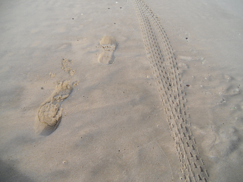

    Footprints from a guy running on the beach today, my tyre marks, 8psi, 80mm rims. No way you would have ridden a regular bike on that, far too soft.
    Fatbike wins

    awesome.
    standard foot and fatbike tread on same terrain, same day.
    'ere ya go!!
    getcha some FATbike or sink into the muskeg and be lost forever ever.
