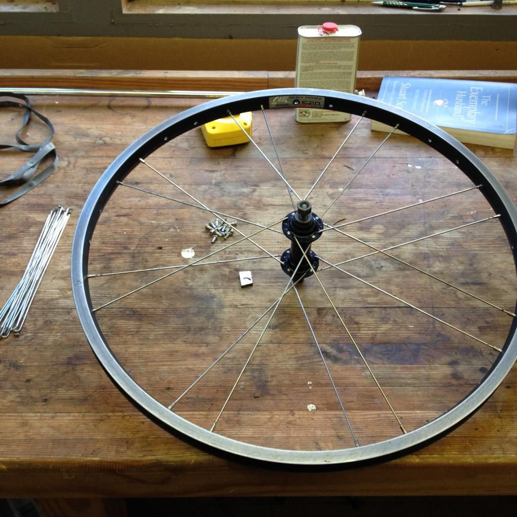

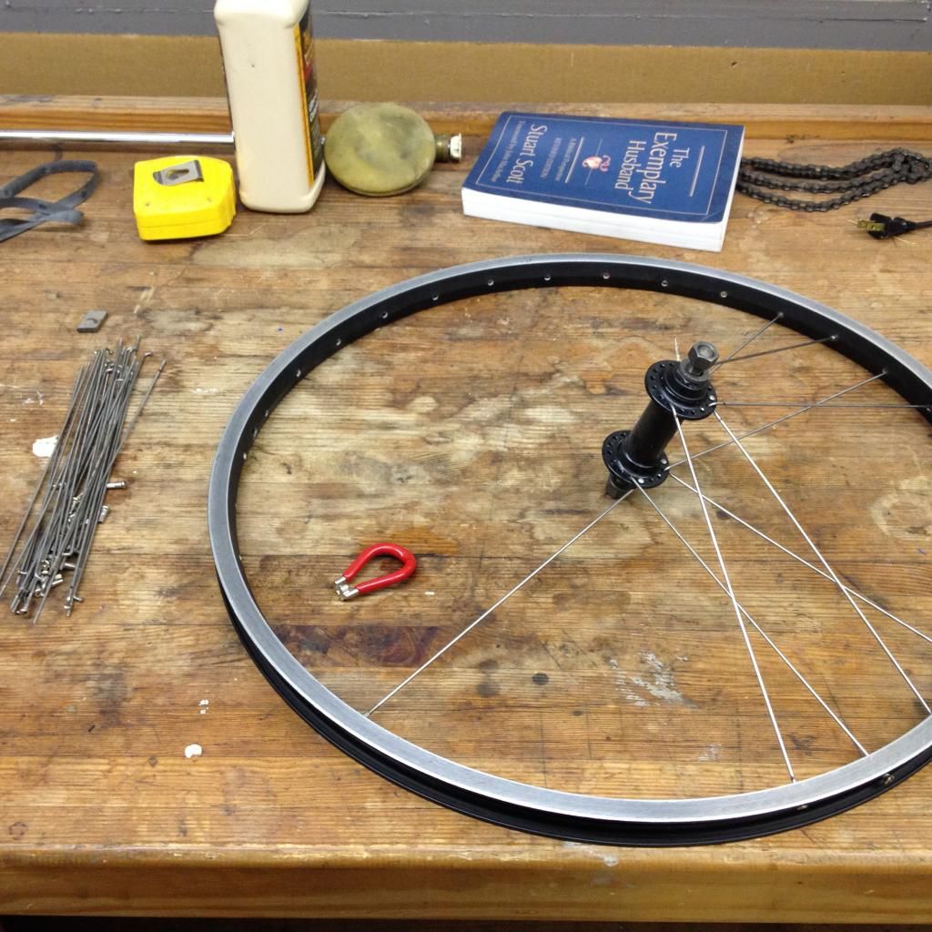

    Thanks GrayJay for the link and to TigWorld for the excellent writeup on 16 spoke lacing
    Re-lacing went well. I'm waiting on blue spoke nipples for some bling then will have the bike shop true up.

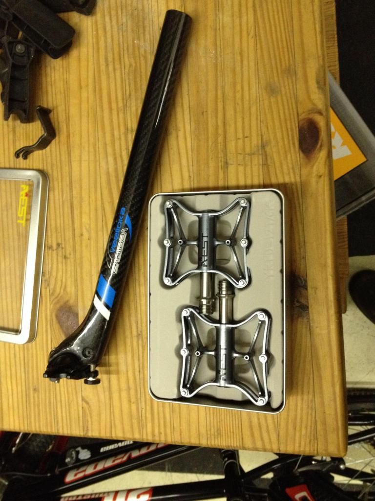

    Got the last few pieces for my build.
    AEST pedals and eBay carbon seatpost.
    Got the pedals, seatpost and Monkeylite SL bar I bought used on eBay installed.

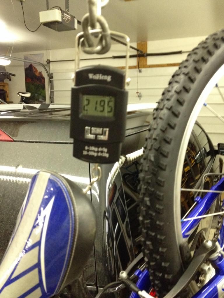

    Semi / Budget Trek 220 Build
    Semi / Budget Trek 220 Build-imageuploadedbytapatalk1429927153.989277.jpg
    All finished, got a resin bash guard and AEST titanium quick releases. Haven't weighed it after putting the bash guard on but it probably close to 22lbs again.
