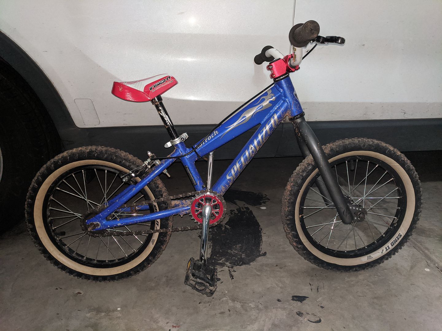

    Hotrock 16 Build
    I thought I would share the Hotrock 16 I pieced together for my 5 year old. He bought the bike for $40 and was already starting to look a little big on it so I reconfigured it so the geo would work better and help it to last longer. I also wanted it to be a better trail bike. I think I have around $200 in parts. I think it may weigh no more than 1 lb heavier than stock. Most of the additional weight is from the 20" fork. We took it out today on some local green trails and he did great. The best upgrade was the 25T vs stock 28T sprocket combined with the longer pedals which allowed him to climb a lot easier.
    Upgrades
    • 25T sprocket
    • 5.5" 1 piece crank, drilled and shaved to save weight
    • 20" BMX fork, drilled for weight. If I could do it again I would have bought a trials fork because the BMX fork is 1lb more than stock.
    • 16" x 2.25" Vee Crown Gem tires, these cost me dearly because I had to pay $35 to have them shipped from the French Commencal website. There is no 16" tire selection within the US.
    • Ebay aluminum stem
    • Crupi 2" rise handlebar
    • Insight mini BMX seat

    It looks like there is a rim brake installed, did you do that yourself or did it come with it? I don't think these bikes came with hand control brakes from the factory.

    I got as far as finding a 20" fork for my sons Hot rock. I've got a couple questions.
    what crank did you use? Is there a standard specification I should look for ordering something online?
    And what I'm realy curious about is the "drilled and shaved to save weight" process?
    is that a BMX thing?
    Thanks, Woody
    No, it's mainly a MTB dad-who's-a-bike-geek thing.
