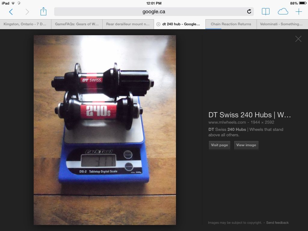

    If the hub she'll looks like this,
    There is no way to convert it to 15mm. Needs to be a bigger shell diameter.
