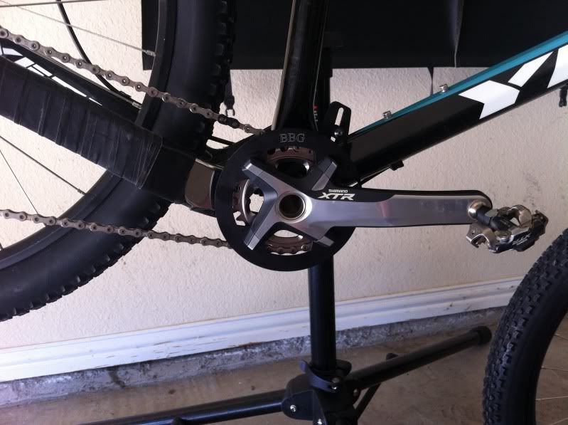

    I would show you mine on my Yeti with the XTR 2x10 but I would have to go outside and install it and it's cold. It is going to warm up this afternoon so I will do it then...

    Ok, I went out and installed it. I run it as a 1x10 using just the inside 26t ring. Seems low but I never run out of gear unless I was to just go hammer on the street. I am in the middle of my cassette the majority of the time and chain line is perfect.
    I'm not sure on the chainring bolts since I just replaced my big ring with the bash.
    I ran it the same way before but I just used a 32t HBC chainring I had laying around but finally got around to ordering the bash.
